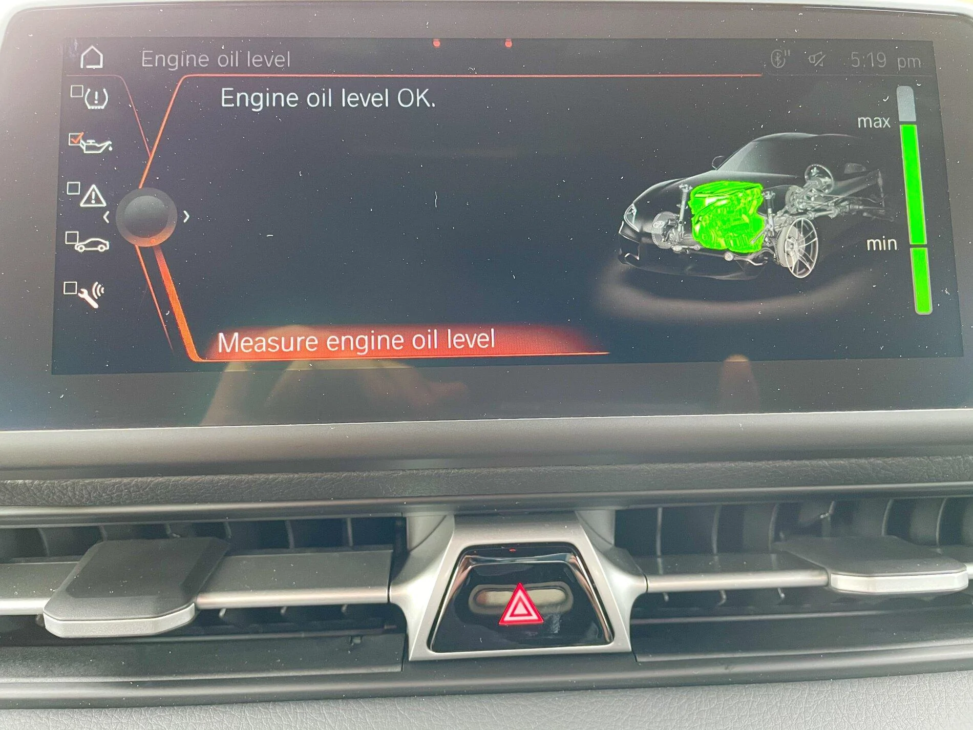

Track time: 1 track day between first and second oil change.
I have been measuring my oil almost every week since hearing people saying their MY21's burning oil. Every measurement has always been at max level line. That's even after nearly 4000 miles and a track day.
However, when doing my second oil change at 5000 miles, I measured how much oil came out after I drained it. It came out to be a little less than 6 quarts. I put in exactly 6.5 liters which is about 6.9 quarts for my first oil change. So if my measurements are correct it seems that I have burned about a quart of oil in about 4000 miles. But the oil measurement still said it was max.
It seems the car's oil measurement isn't really accurate. I wonder how much oil is in the car when it says the oil level is at minimum.

The level at minimum is 1 quart low.
Not all oil drains out 100% when you do an oil change. Some gets sucked into the filter, etc. You never get out exactly what you put in.
