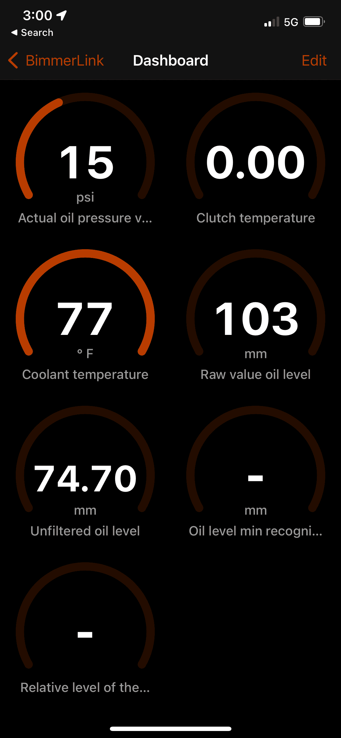

@32bitsofGil
which is the value to look at in bimmerlink for accurate oil level, “raw value oil level”?
"raw value" is a great way to see what the realtime value is, "min recognized" appears to be the value iDrive uses

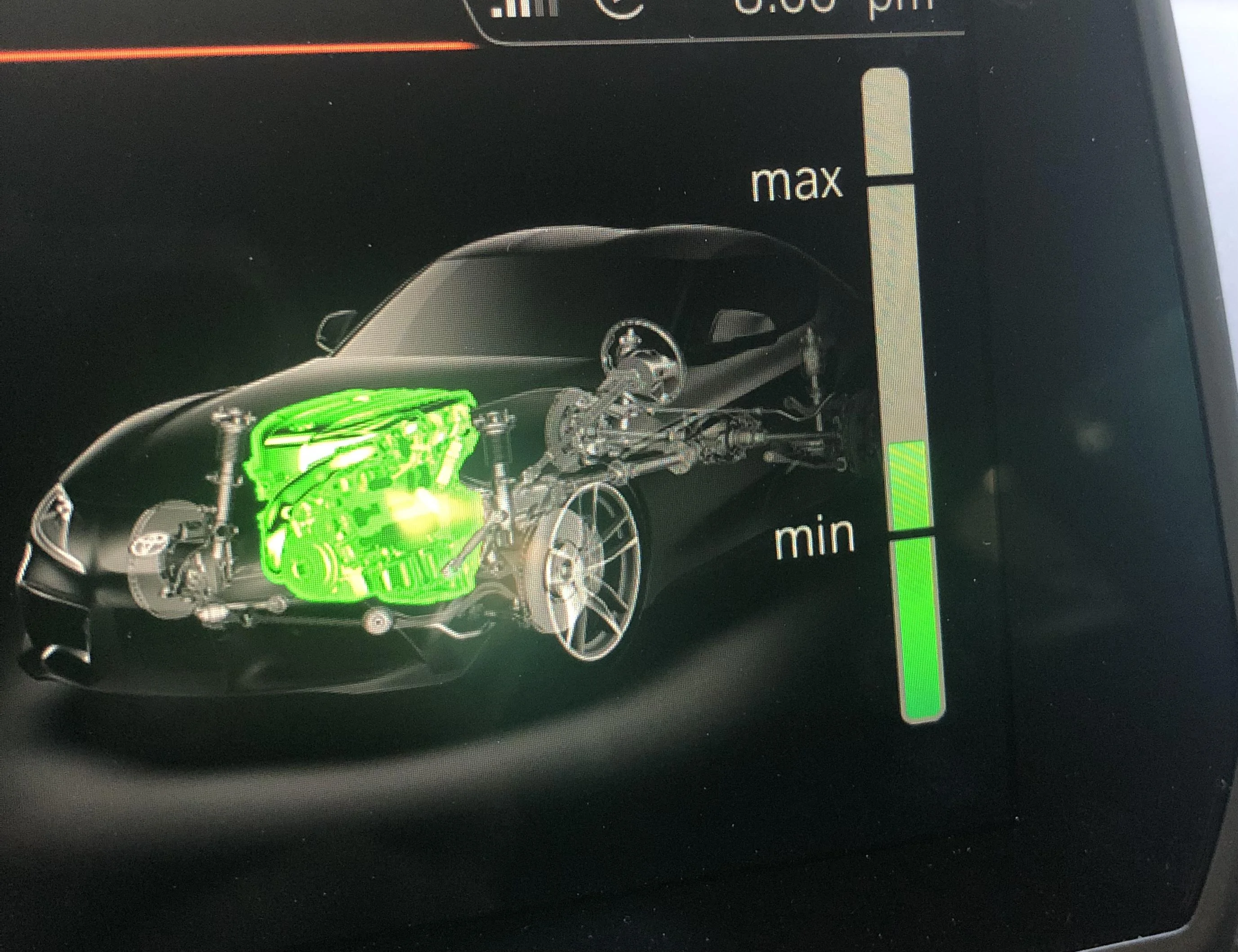

I hate hearing people needing new pistons and rings ? at least there’s no cylinder wall scoring like you said. That would be worse. Think it’s the same problem for all 21’s having consumption issues? Also, sounds like you have a pretty cool dealer to work with.
I forgot to update the status of my oil consumption since last oil change. I went down to just one green bar above the MIN mark as seen on the photo.
Drove about 3200 miles on 0w-20 and 6 full track days.

great, thanks. So it looks like I am slightly overfilled here then, correct?
why is the “unfiltered” value so different than Raw?
I’ve never seen my “unfiltered” values change at all. Always 74mm. The only values I use now to check are “raw” and “min recognized.”
just as @Loco38SUP detailed in his posts, my car hit minimum level when the “min recognized” values dropped below 78mm.
i don’t think this problem exists in all 21s, but it varies depending on the history of the vehicle. I think many 21s are prone to the issue, but the driver can do their own break in if they really drive it like they stole it from mile 0.
