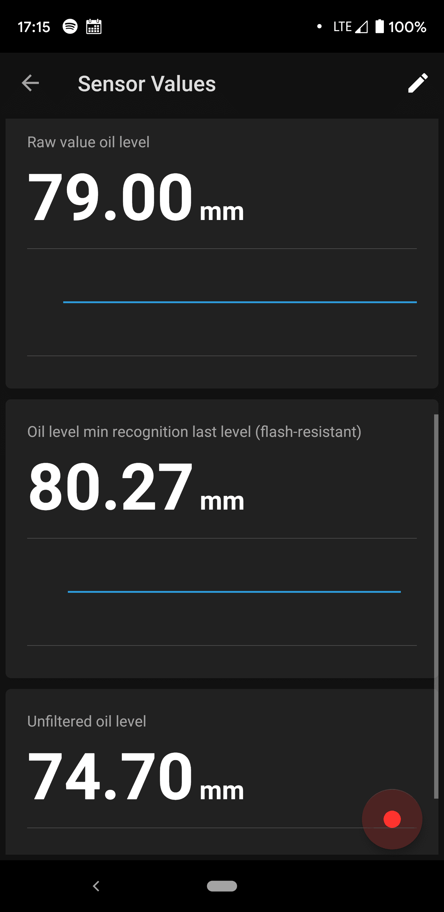

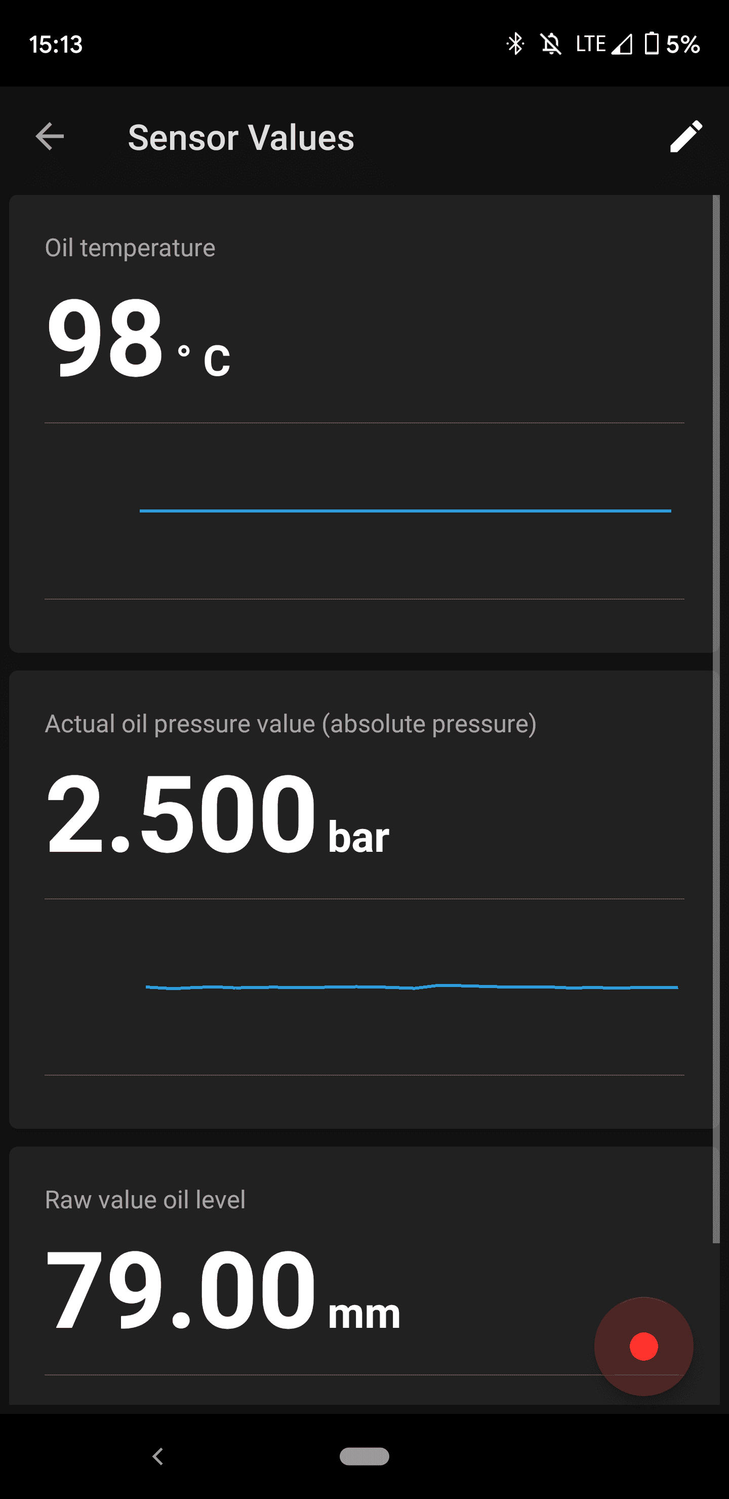

iDrive was showing my oil level at "50%", but BimmerLink showed 79mm which should be "0%" ?
The “raw” value tends to fluctuate a lot. You’re looking for the “min recognized value” that is the reading iDrive uses.

iDrive seemed a little more accurate today, it shows oil level at 25% (one notch above minimum).
BimmerLink shows 80mm. So this is more in line with the other findings in this thread.
