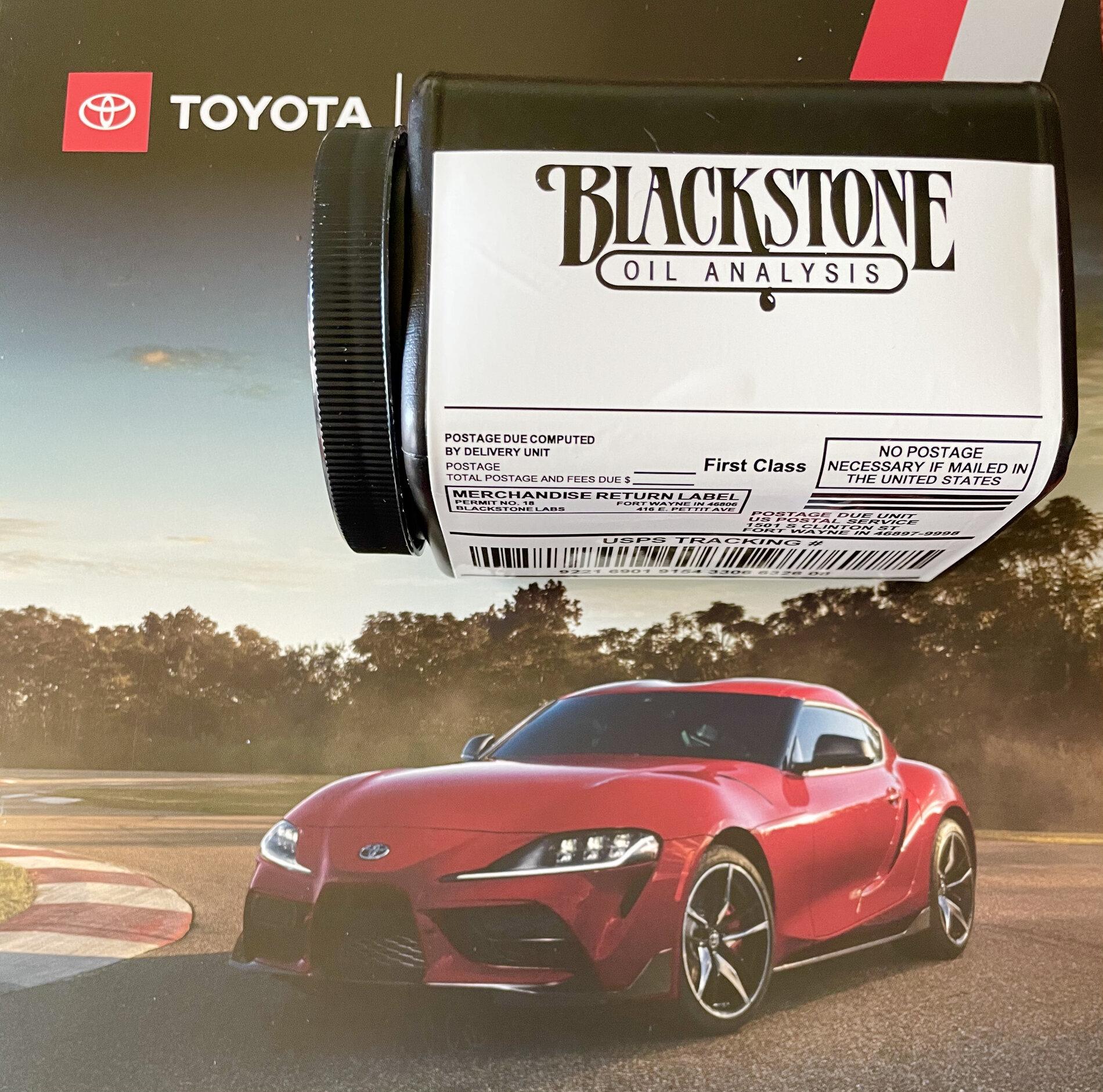

People on here are reporting that 2021’s start burning oil around 2500-3000 miles. I’m at 2500 miles and plan to change the oil myself at 3000 miles.
From this point on I’m going to be sending oil samples to Blackstone for testing. If piston rings and/or rod bearings are starting to go the test should catch it.
So far I’m showing oil is at max limit on iDrive and on my Ecutek Connect app I’m only down 7% overall.
-RJM
-RJM How does this Blackstone thing work? Where can I pick it up? Thanks.
