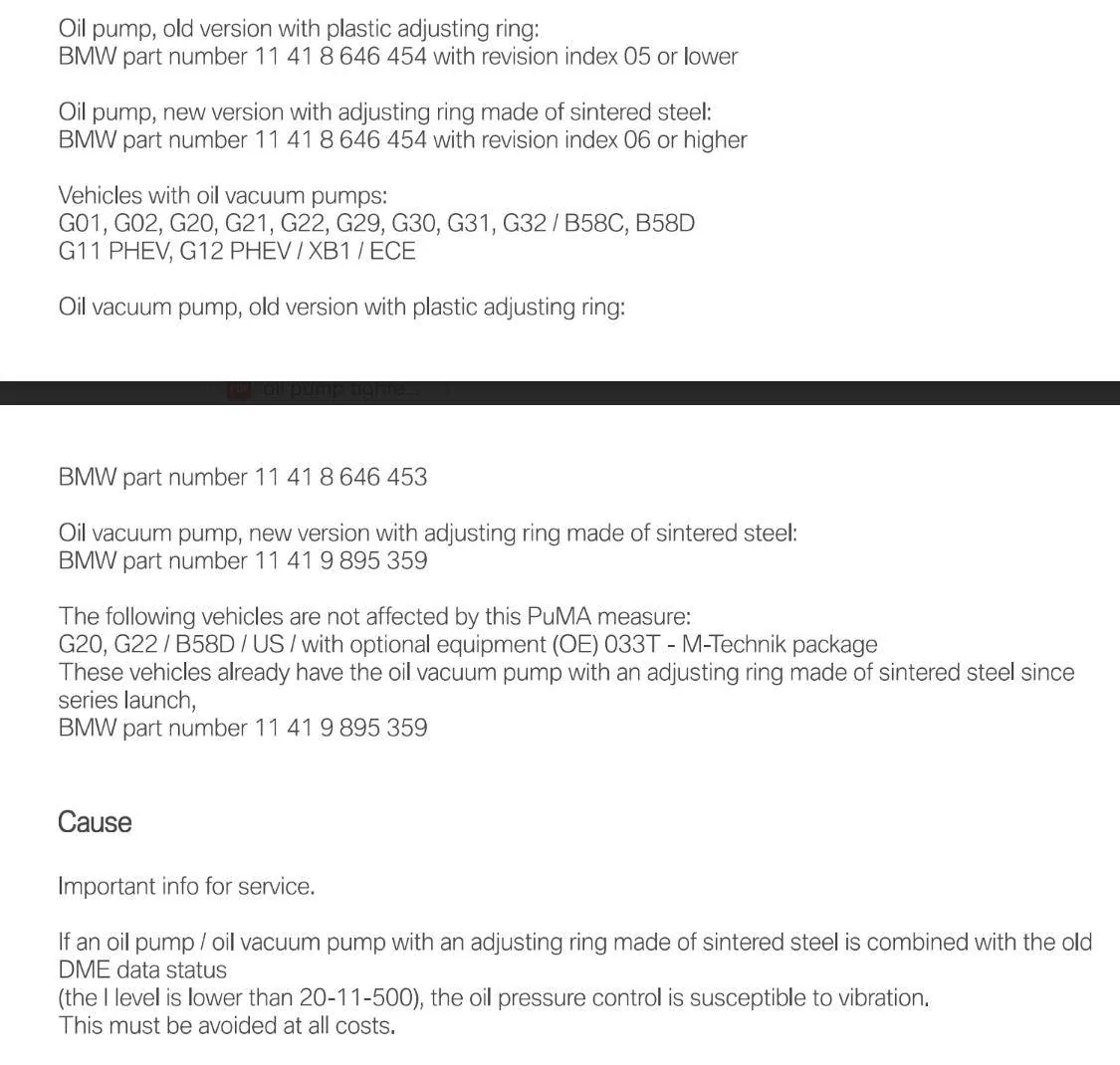

Id like to actually see the internals of the new pump and the supposed new sintered metal control ring. Never heard of the material change until now. Not saying it's wrong but with all the discussion about it I've not seen any images of the new pump internals. Plenty of broken composite ones but no new ones which seems odd considering it's quite a significant change.

I found these on an overview through Google search which links to Instagram. Although, it looks like they might've been deleted from the post so this is the best quality I could find.

I think the issue here is that Toyota dealerships were never sent a bulletin with the change and superseded revision index like BMW dealers were. You drop off your car for warranty work or order the part, Toyota dealers keep nothing for the Supra in stock, so the parts guy orders the newest part from their warehouse, and you automatically get the updated part that fixes the problem.
The issue affects the earlier cars up to mid-2021. For reference, my build date is 07/10/2020 and is affected. I am outside of warranty - just barely past 60 months of ownership - but to be fair, I wouldn't want anyone else to perform service to my car anyway. Sure most of you can relate.
The part number for the old and new pump are identical (as you can see from the extremely helpful post above this one). What you have to make note of is the revision index (06 and higher is the correct part with the sintered steel adjusting ring), and for my fellow DIY-ers, note that you need a software update as well. I will attach the BMW info in case it helps.
