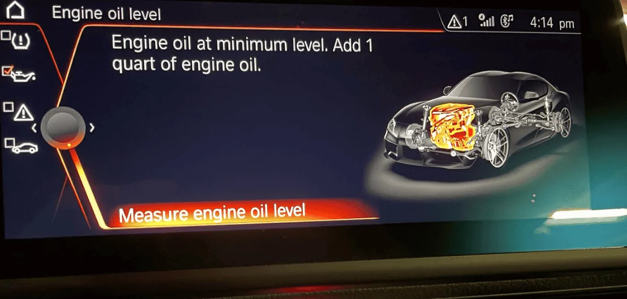

Oil is essentially at minimum today, so I'll be topping it off before it heads to dealer, confirmed with them that this is ok since they will do full change anyway before installing the test seals.

My consumption test appointment is coming up, but just driving today I ran the measurement tool and received this. 1,945 miles since reading full. Sport mode driving, street only, mainly chill backroads, very rarely above 4-5k rpm

- 100% (6.6 liters) = 97mm
- 100% (iDrive max) = 97-85mm
- 75% = 84mm
- 50% = 82mm
- 25% = 81mm
- 0% (iDrive min) = 78mm (add 1 quart)

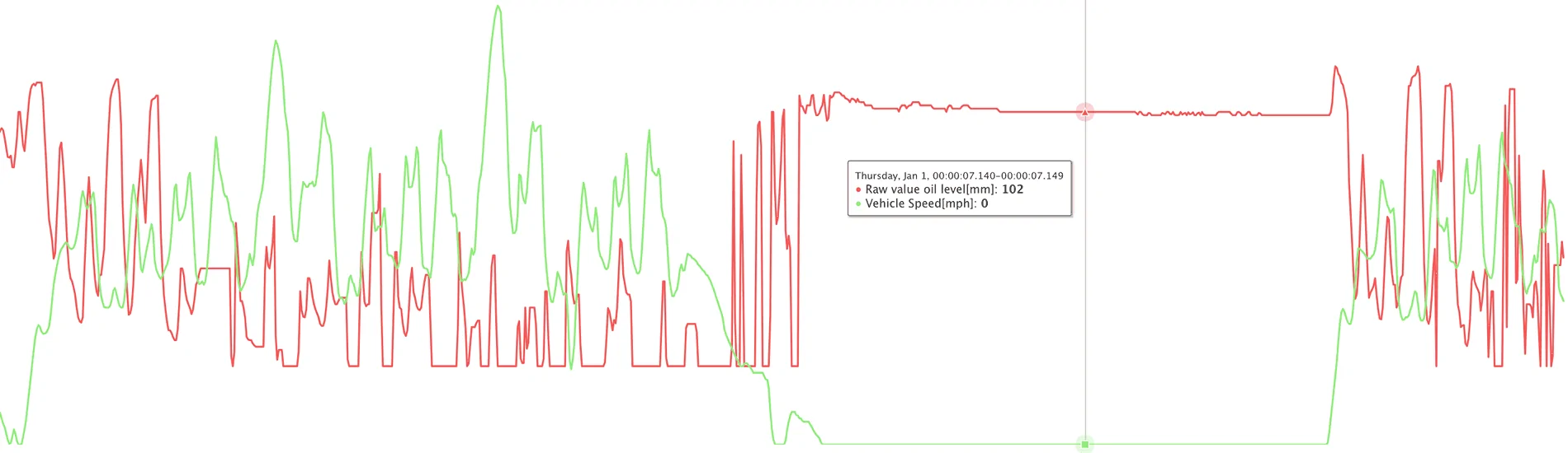

By curiosity I checked on BimmerLink the level in mm, which gives me:
- 98 mm engine cold (not running)
-110 mm engine warm and after waiting about 5 min
I always considered engine hot + a little time to let the oil go down is the right way to measure, which would mean I've screwed up.

-Can I fill engine oil using following the BimmerLink level in mm "live", instead of starting the engine and having to wait for the oil to be hot? Any idea what kind of sensor it is(Floating, pressure, optic)?

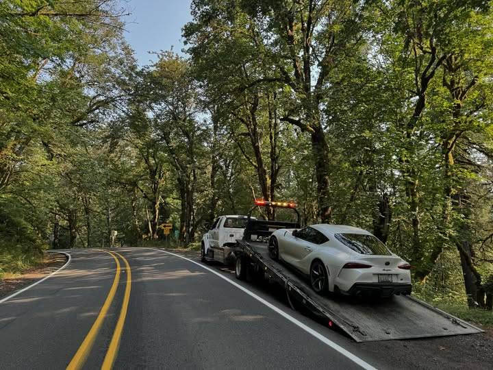

The Supra has always used oil. I put in a liter every 3,000 miles for 25k miles. I let Toyota know, they said that was within tolerance. I was fine with it, a minor inconvenience. Then a liter only lasted 2k miles. I topped it off and took it to the dealer. They checked all around, didn’t see any leaks and asked me not to add oil and to drive it in next time the low oil light came on. I told them I thought it was probably a really bad idea to drive the car with low oil, so here she is, getting towed, 1019 miles later, asking for more oil.
After getting towed in 08/12/2024 they Told me they were going to start an official oil consumption test. I was pretty annoyed, because I assumed last time I towed it in they were tracking it. They changed the oil and added various tamper seals.
I drove it a lot, because I've been concerned about the oil issue since I bought the car new. If there was a warranty issue with the car, I wanted it fixed before I voided the warranty with mods.
