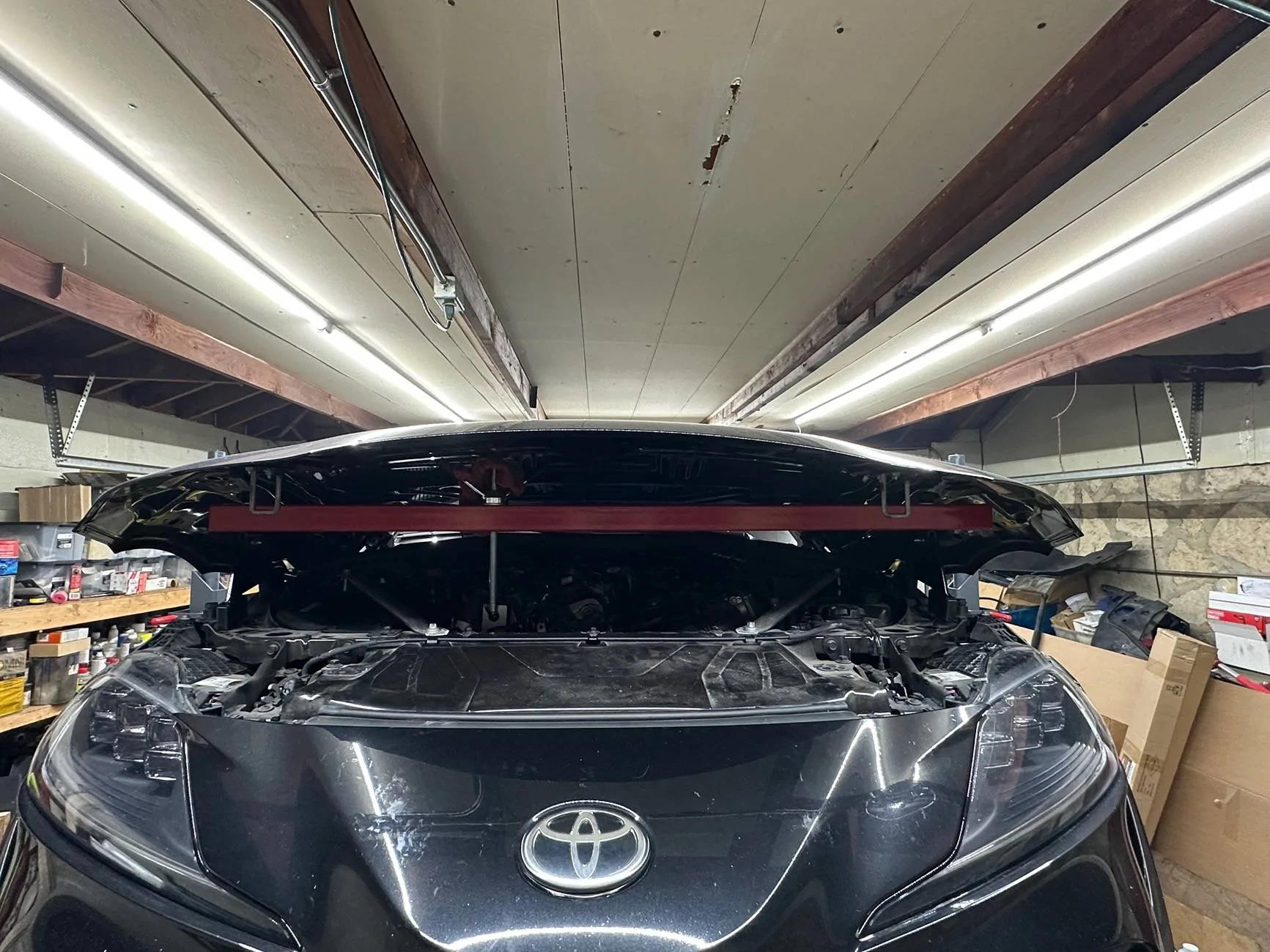

What engine support tool did you use so you could drop the sub frame?

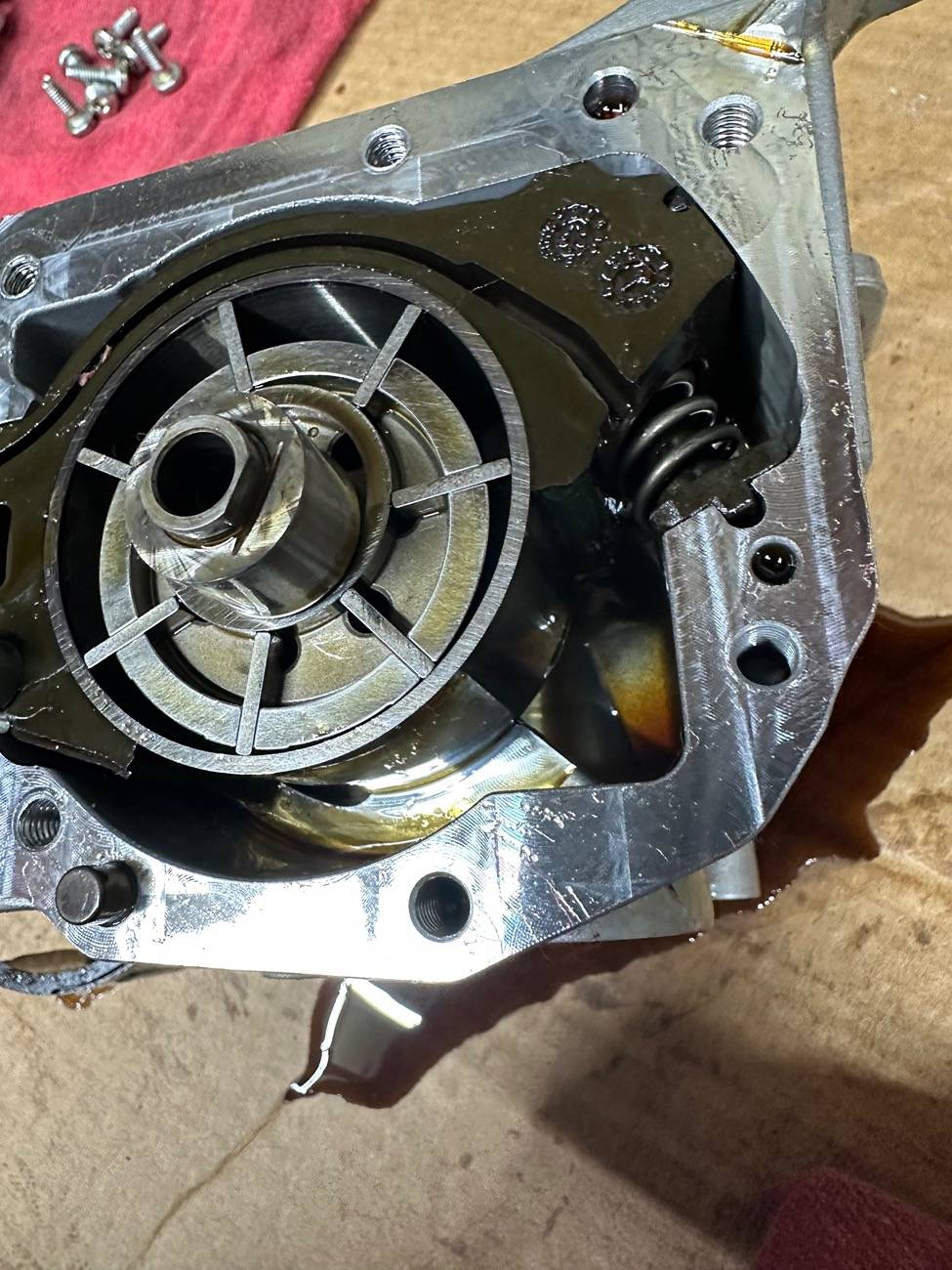

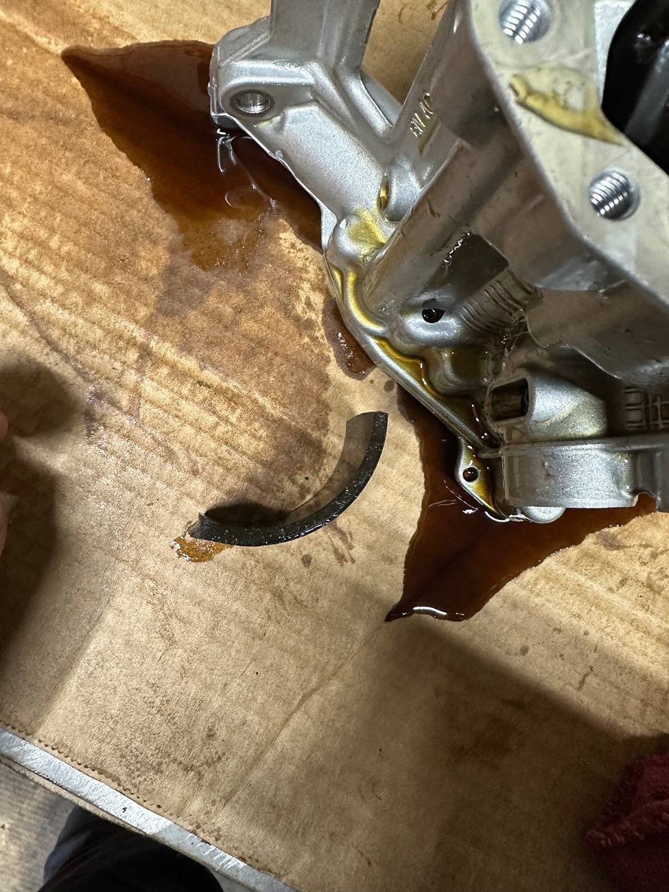

You could probably get away with jack stands but I have a two post maxjax lift. Used an engine table lift and engine brace bar I got from harbor freight. Some power tools I already had and bought some sockets I needed. Took me all day but overall it was not as bad as it seemed.
