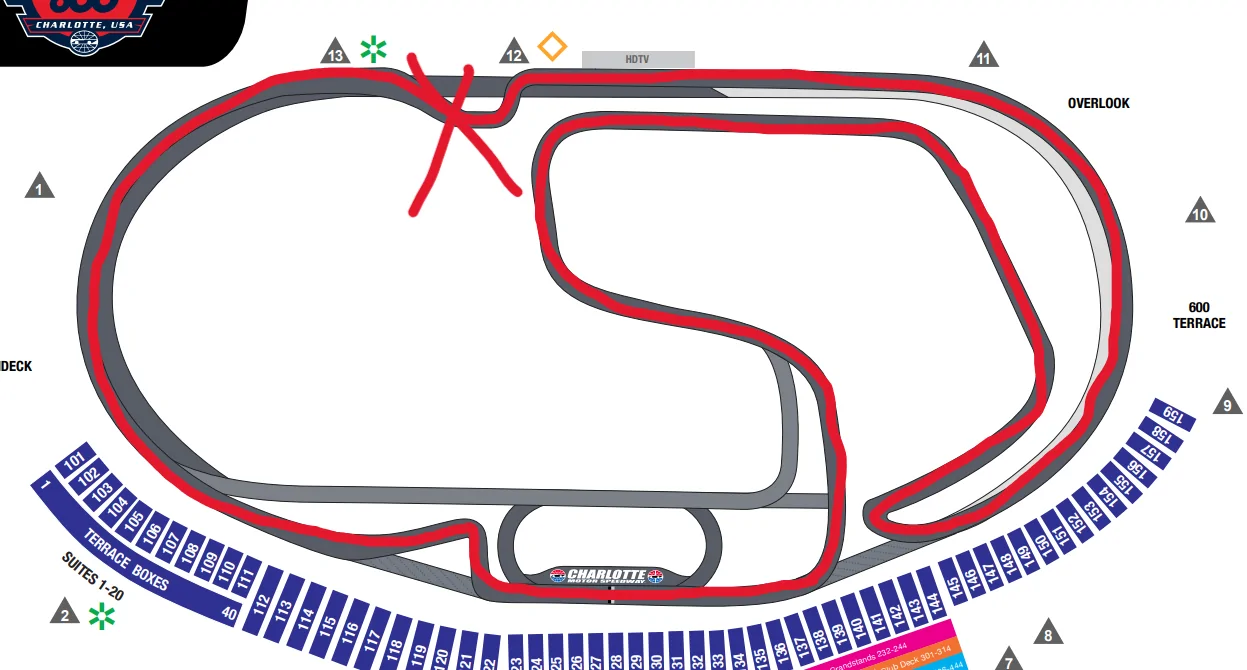

It was in a right hand bus stop. I had to find a track map to display it, but it's the 135 to 45ish mph left turn into right bus stop turn. I wouldn't expect fuel starve there given the pump "should" have been submerged as I still have 5 bars of fuel left. It was also immediate, not like the usual fuel starve I've experienced in other cars where it takes a few seconds to show up as the air bubble makes it's way through the system. That was why I expected it was actually a FPC overheat since it was coming off a long straight and had maybe 3-4 seconds tops of partial throttle before I matted it again to exit the bus stop. That behavior would match an overheated IC.
Arrows to show counter clockwise direction. X where the fuel starve was noted. I don't disagree that it could be something else. I would also say adding this little cooler fan is a possible fix and I won't know until the car either shits itself again or I run CMS next August with all the covers in place to test.

It could be fuel starve, that looks like a big WOT section before the bus stop as well. Plenty of stock supras have fuel starve over half tank, depending on the track. The DME has some interesting safe guards, one of which is a faux misfire it will do if it anticipates fuel starve. Designed to make it so the driver will lift when it happens. Kind of genius I think.

I expected it to be fuel starve or some code relating to it given I was adding around or just over 4 gallons after each session. I was surprised by the over temp code though which lead to this rabbit hole. It was others mentioning they had fuel starve but no CEL that made me dig deeper.
It is a long WOT section as you mention. On the stock PSS I was at 35-37 mph at the pin turn and the banking ends up sucking some acceleration out so it was about a 97-100 mph delta right before the bus stop, and then the following section gets you to 120 mph where you're losing speed if not WOT on the banking into the front bus stop, etc. I wouldn't expect fuel starve at CMS given the banking is all left, but the two bus stops and infield both have sweeping rights with some elevation (like maybe 20-30 feet change total).

Yea, but as I said before, sometimes the code isn't the origin but the outcome, or reverse. I'm not saying positively it was fuel starve, but it could have been.
At Lime Rock, the whole track is right turns except for one left hander, you would think it would be fuel starve city in the Supra, but most of them aren't very long right handers so it's more rare. I can however fuel starve in the uphill or downhill at my modification level if I don't keep the tank topped off before every session. Back when my supra was 100% stock power, I could just lap all day with no issue and not have to keep my tank topped off.
Then there is Thompson, which is the video above is from. I am pretty much guaranteed fuel starve about six laps in there, no matter what.
The code that tripped from the instance in the above video was the HPFP angle maxed out, but that is part of the faux misfire strategy the DME uses. Didn't go into limp mode that time, but the next session it realllllly fuel starved and threw me into limp.

I get fuel starve at Road Atlanta coming out of T10B which is kind of similar to that corner. I tried a couple times doing 1 session topped up, running 3 laps and then doing the next session and it fuel starved in the two attempts I did that. I do have more elevation in my example and it's a little more sustained right hander but I can see your track having that issue with way less gas than what I run.

Interesting to note. I've driven RA quite a bit and you're right that it's a similar setup with high speed down into a switch back. Elevation there is very different as you said though. T11/12 is my favorite section of that track too, so it'd be a bummer if 10B causes that issue.
Weird that some tracks cause it quickly while others don't. I'm used to filling up during the day, but filling each session and still having starve will be annoying.
