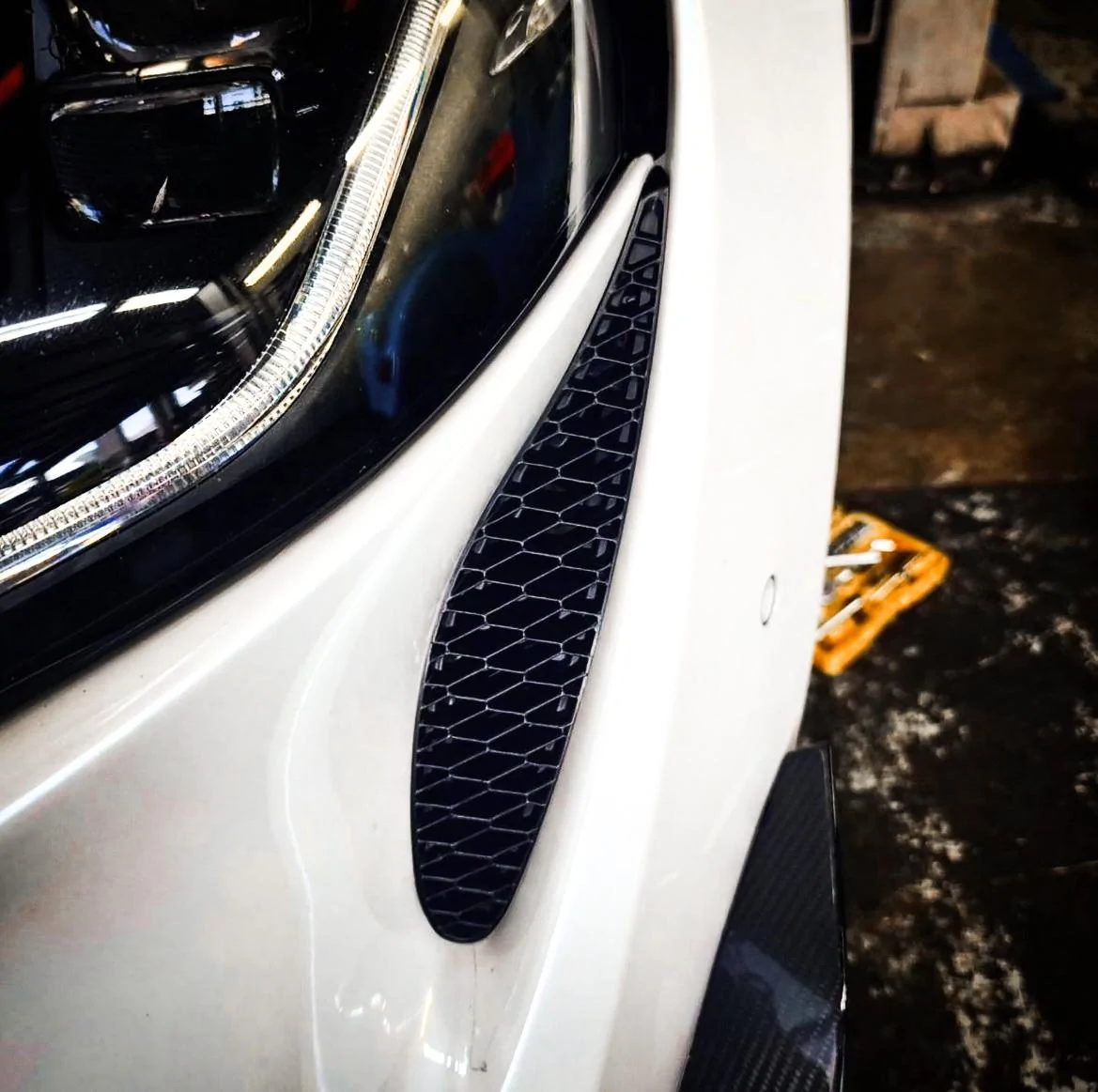

Open Hood Vents
Now that I've seen it, I can't unsee it!

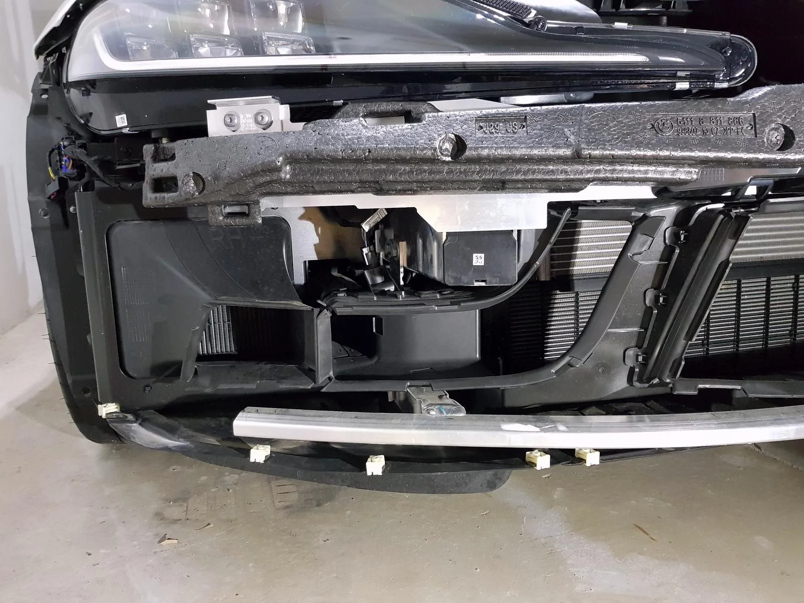

The auxiliary radiators are right behind our Open Front Bumper Vents. Airflow should be improved compared to the factory closed vents.
https://oemplusmods.com/products/open-front-vents-toyota-gr-supra-a90-91
Right! It’s something we never even noticed because we never removed the fender liner.

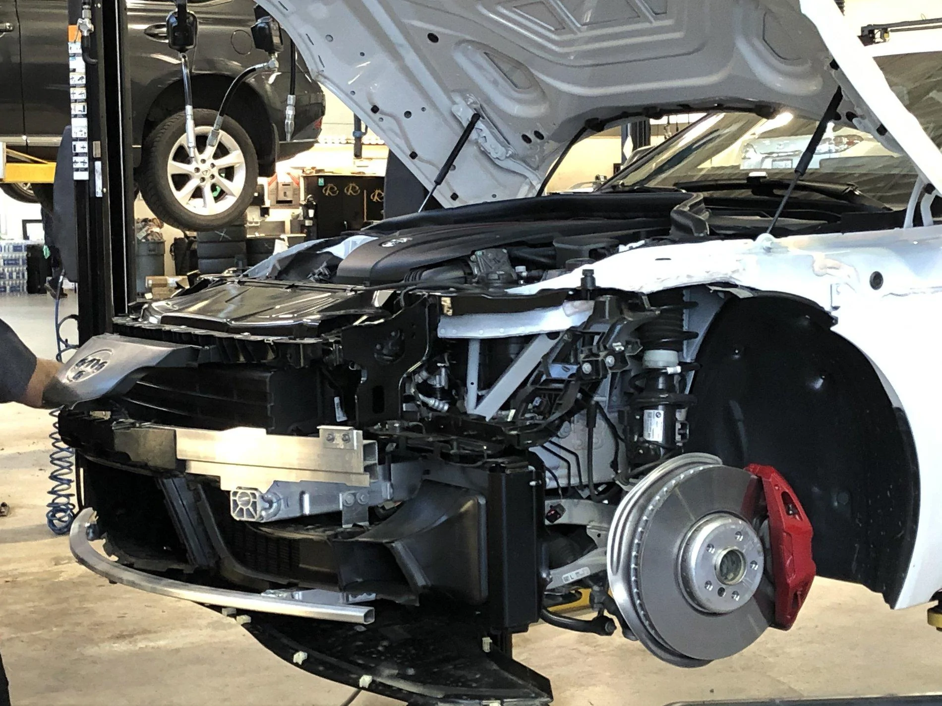

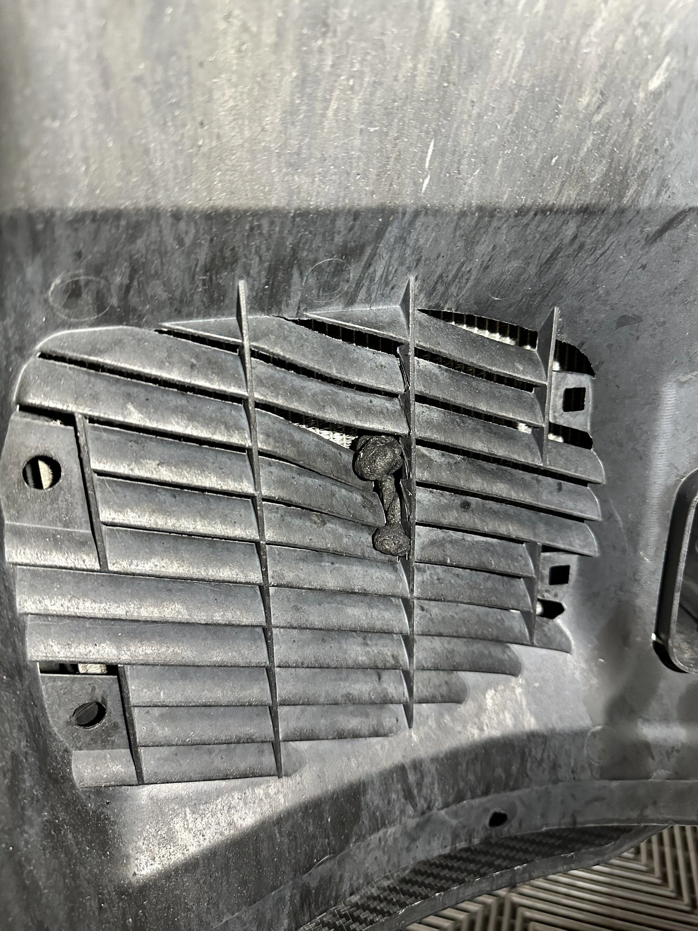

That is the rear of the radiator. These $180 "vents" do not give one ounce of air to the radiators what so ever since the air channeling ducting connected to the radiators are fit into the front of the bumper.
This claim is 100% false.

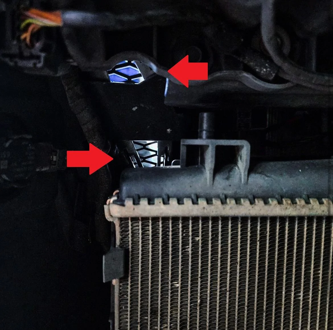

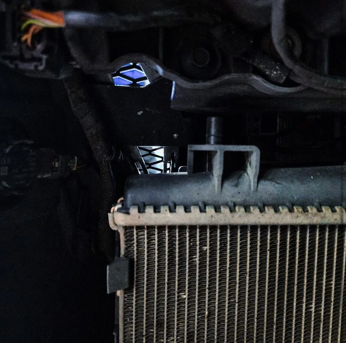

While I had the same assumption, this image clearly shows, at least on driver side that there is some gap..
EDIT
Maybe not that much!!

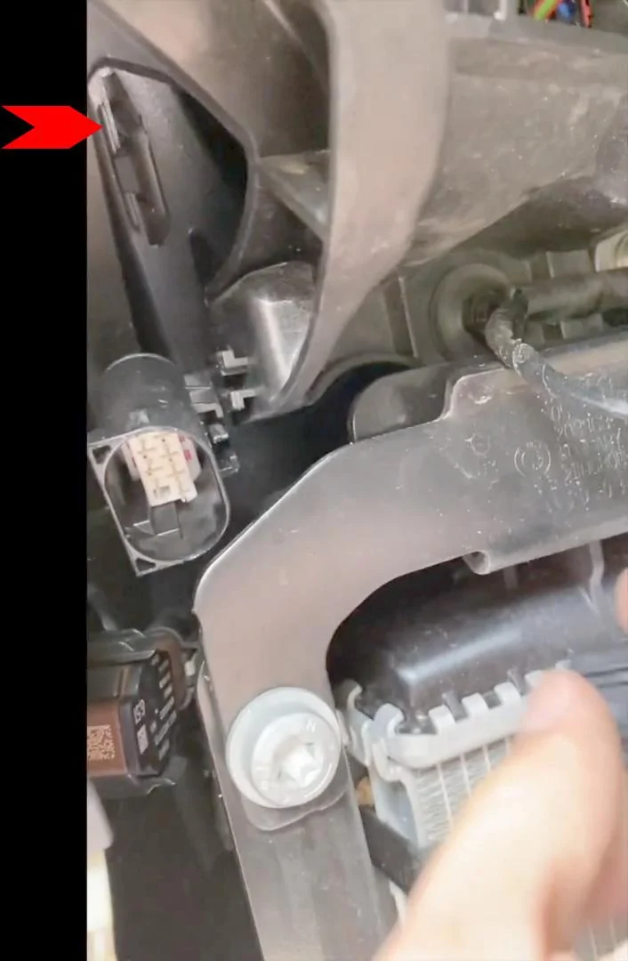

That's shady man! put the all components in there!!
#2020 Toyota Supra Front Bumper Removal & Horn Install.mp4_snapshot_02.37_[2023.08.26_22.09.4...webp
Yes there will be air coming in, but not to the radiator what so ever. The radiator ducting is in the way and takes air in from the front. Again, that air coming through those “vents” ain’t touching the radiator in any way. See the photos of the ducting I posted. You can easily see this is the case by looking into the bumper intake into the ducting.
That photo you put the arrows in is showing the BACK of the radiator. The air coming INTO the radiator from the ducting is exhausting out the rear of the radiator into the fender well.
At best, those “vents” are introducing air pressure into the void inside the bumper which will create unnecessary drag.
I was investigating and editing my post.
Indeed you are right! Some air are coming in, but not to the aux rad. I mean aux rad already has direct ducting to it that does not allow any air from anywhere but the front anyhow. Was still hoping to see a way but I guess not.
you are right, seems like there is a separate duct for the auxiliary radiators.
