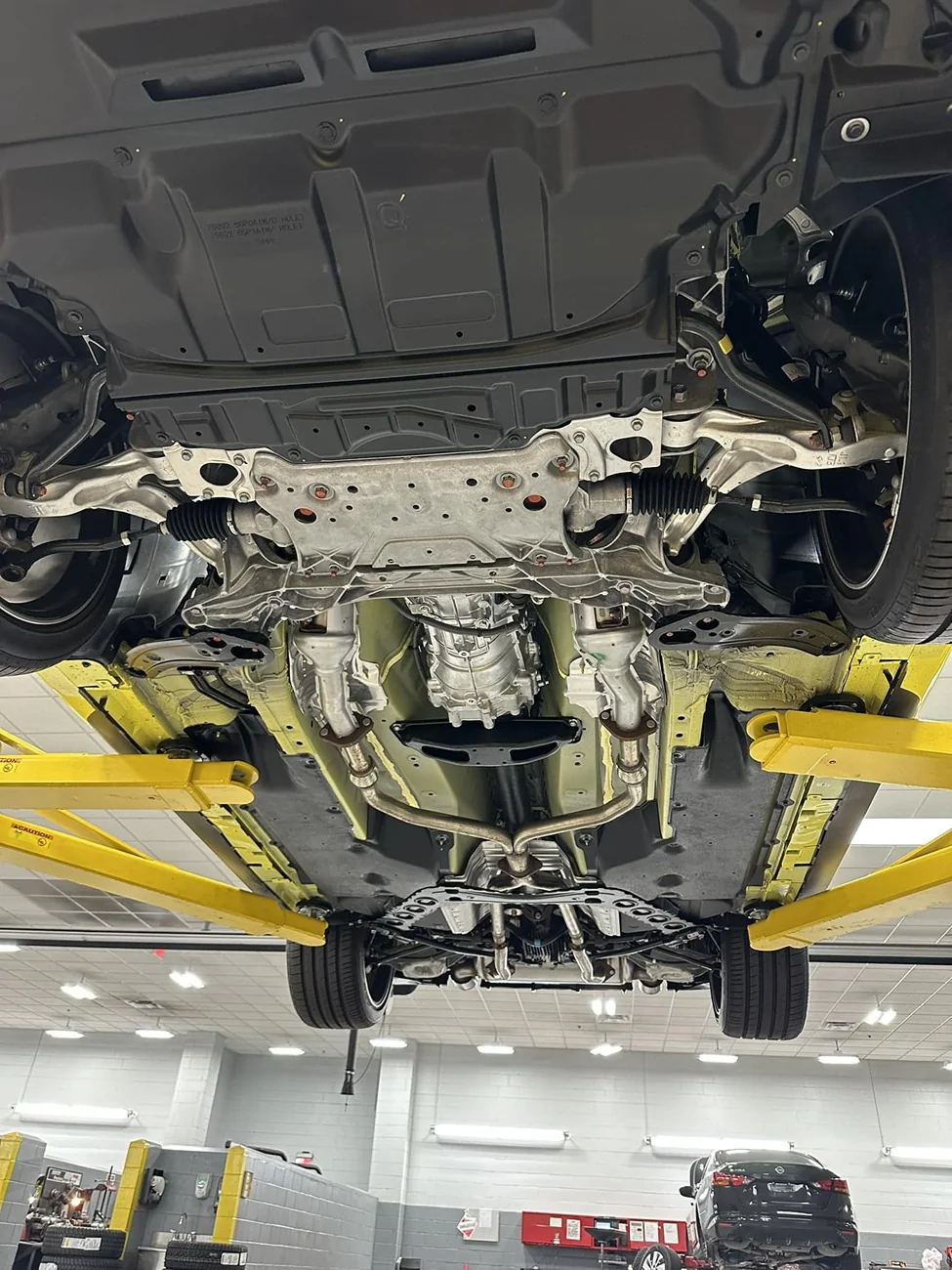

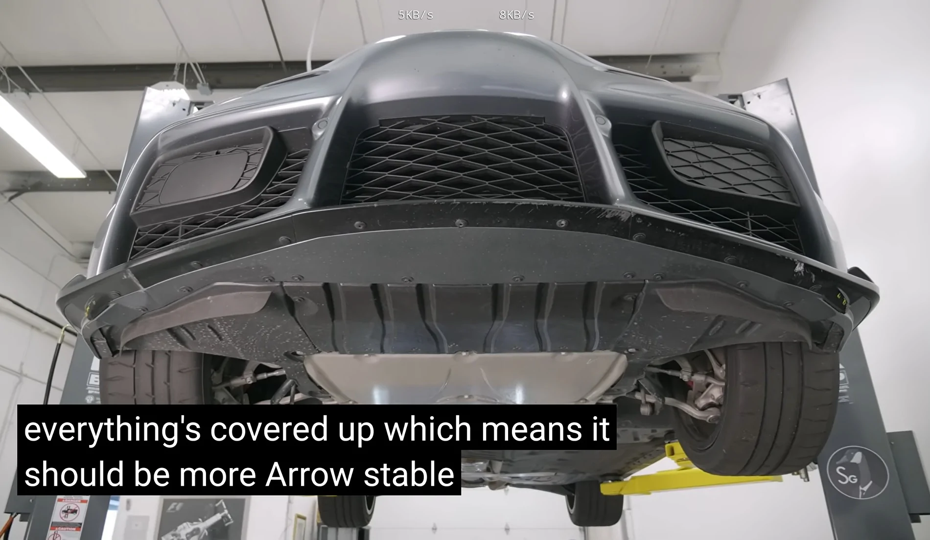

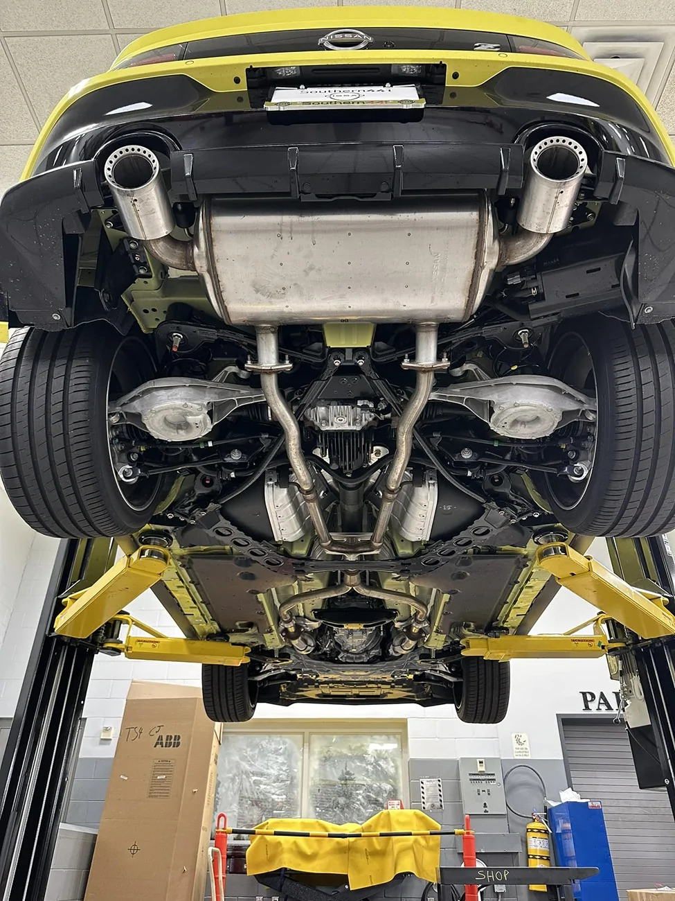

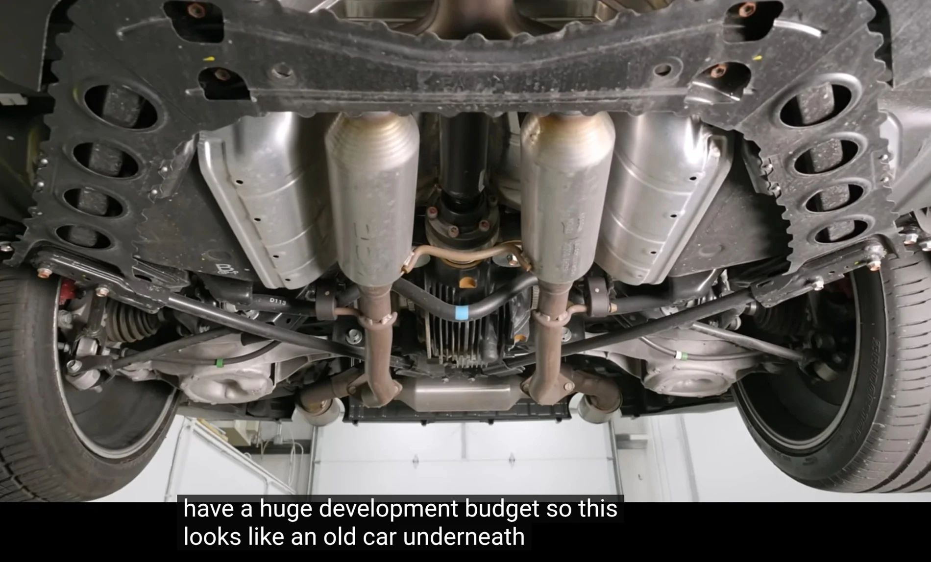

The supra's underbody is surprisingly clean compared to something like the Z. I believe Savage geese mentioned it in this video. It would take hours of work just to get most other cars to where the Supra is from the factory.
why is the picture comparing front(supra) vs rear (Z)? 😂
