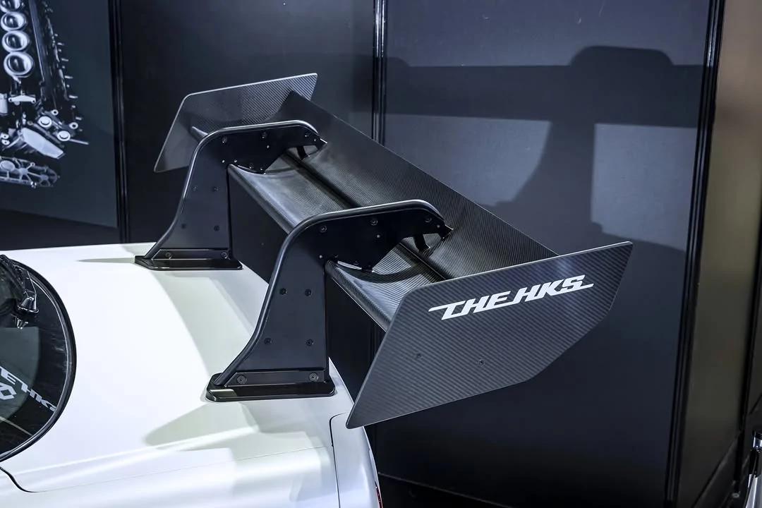

Also keep in mind most competitive orgs don't even allow active aero, let alone static dual element, so the pool will be that much smaller. Normal track days though you can do whatever the hell you want.
Agreed. I know most of the Supra guys who compete in GTA/GL in the California region and none run in any of the classes above street mainly because of the exponential cost when jumping up to the next class. Factoring that rules in Street and below do not allow active aero or dual element, the market really is then just street guys that want street cred, HPDE hero's, and Limited/Unlimited class guys. Not sure if that's a big enough market.

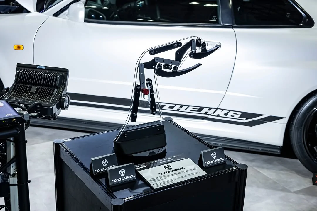

Anyways -- here's HKS' attempt:
