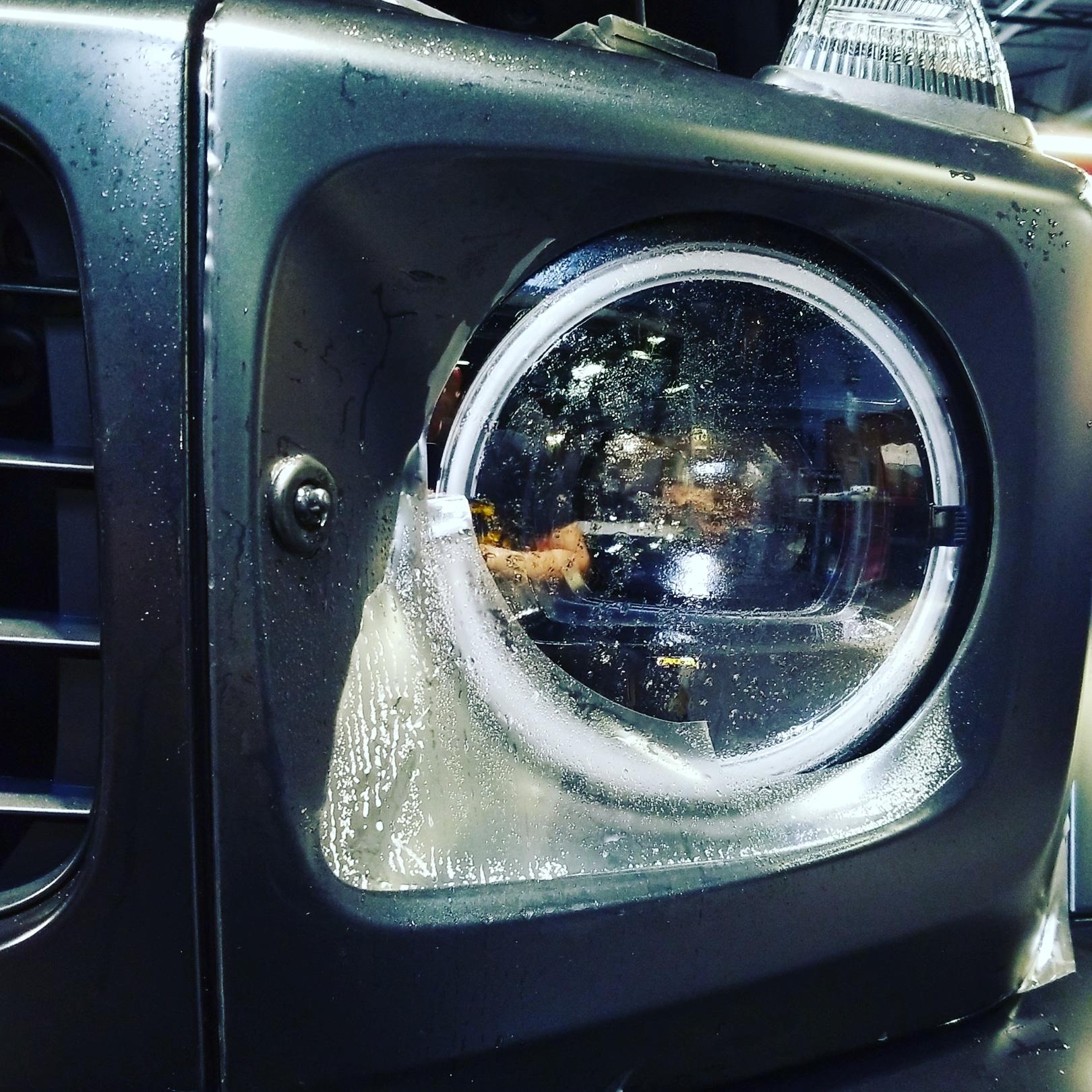

Ok, I'll try to go easy on the explanation and only mention a few panels.
Doing ppf is all about understanding curves and angles. Amount of tension and direction of pull and overhand grip or underhand grip. Alot of things matter. Ppf is a 2dimensional product which is fit on to a 3dimensional surface.
Distance between a flat panel and a panel that has elevation (curve) in the middle is different creating extra skin of film in areas you cant get rid of it. Picture Point A, Point B and Point C. Point A is 60" Point B (has a scoop with a 1.5" raise) 63" and point C is 60". You need to figure out to make it so that point B is equivalent distance as point A and C.
Hood of a Gwagon = Curves / front tips have a slant downwards + a 45 degree curvature + a dip at the end of it and a flat panel at the top that does a 90 degree bend. Try to apply earlier example of distance to this.
The headlights are another world I will add a picture how I wrap them custom with no seams.
The trim on the sides have an unnatural bend if you look at the curvature that the frame bends into the trim, you need to be able to pull it and do a trim with a knife mid air because the trim wont let you put the film down (you are guessing where the cut will be so that it hides behind it) removing the trim is difficult because it increases cost + its bendable rubber (due to plastic strip in the middle of it) and you need to remove entire door panels to get to the screws and glued on.
Rear Quarterpanels used to be in several pieces on old G wagons the curve at the back you were able to do it in 1 piece and quarterpanel in 1 PC.
The 2019 Gwagon (entire rear bend / quarterpanel / rocker / bpillar and a pillar and above the doors and the panel where it says V8 Biturbo which also has a small trim and no room to stretch is ALL entire 1 pcs. 1 screw up installing and you lost over $500 easily. Just from 1 side. Alot of people struggle with Gwagons. Just do a test, call places and ask for 2019 Gwagon full wrap custom by hand how much lol
Rear door latches get in the way for drivers side quarterpanel as well, not allowing you to stretch over and the top part at the back or the quarter has a wave that goes upwards with the trim which makes it even worse.
Lol i can keep going

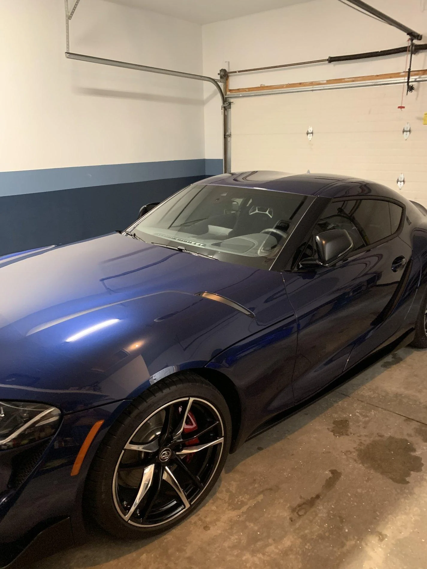

I now have had my supra for 1 month and washed it 3 times ! I would highly recommend ceramic coating and ppf up front . It’s my first car doing so and the results after washing are impressive, looks brand new again! Well worth the investment!

@Bruins71 I would recommend editing the photo and removing your address off of it. Just in case. Supras are a new commodity you NEVER know.
Could you share close up pictures of PPF on your car? Is it 1 piece on the hood and front bumper? Did they wrap the edges?
