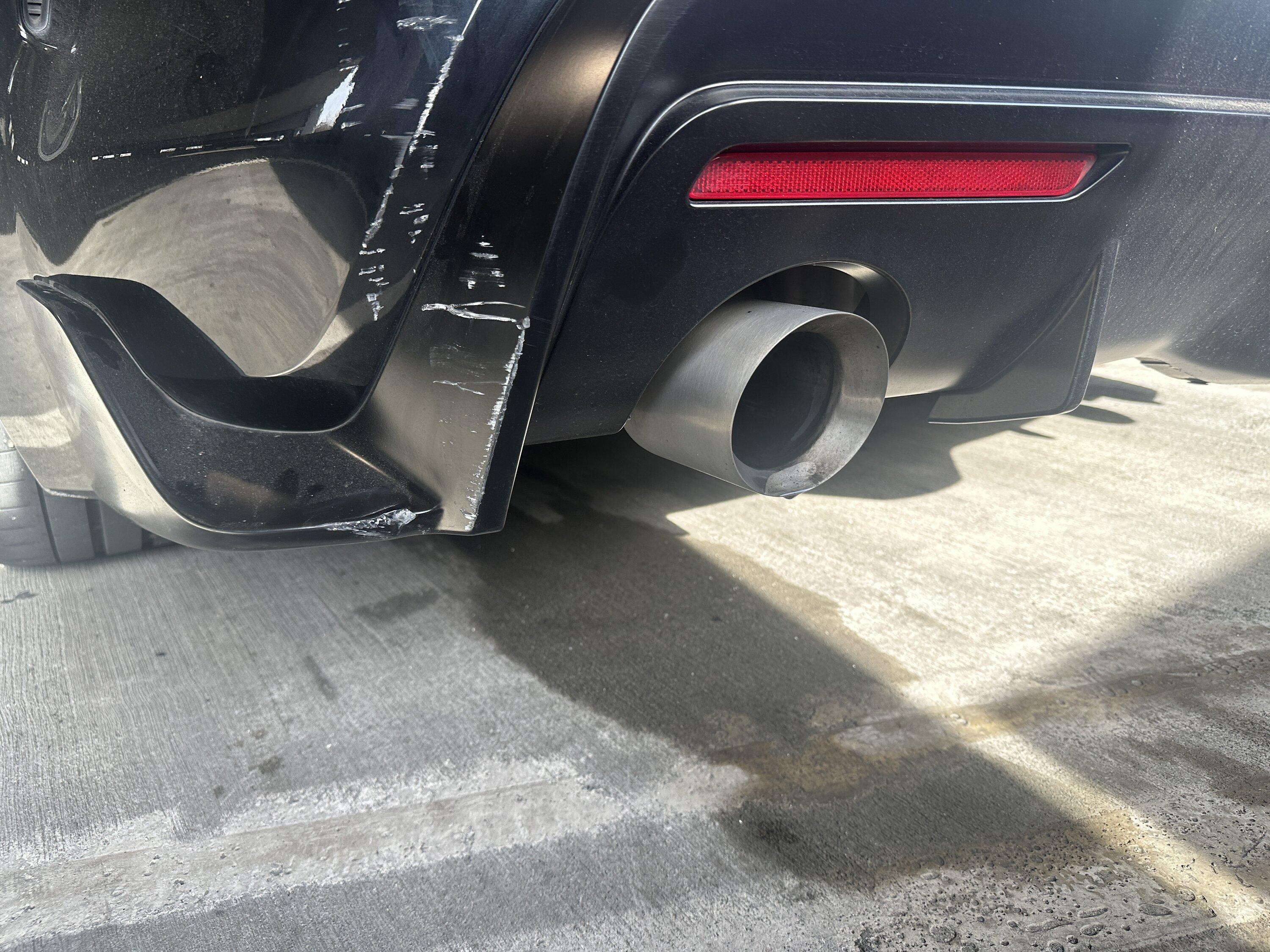

got into a small fender bender that chipped off the plastic of my oem diffuser including the side fin of the driver side. I tried to search for the part number but I was unsuccessful. Does anybody have the part number for the rear diffuser? It would be much much appreciated. Thank you!

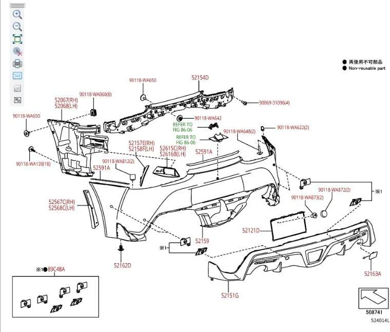

52108WAA05 - No Sonar
52159WAA06 - With Sonar

if i have sonar (sensors), will they need to be reprogrammed? and what the process of that install like? is it just a simple unclip the bottom and clip the top part?
89348-WAA03 is the sensor retainer kit you'll need to transfer them over, but there's no recalibration needed as long as they're all installed nice and flush. You'll just unclip the sensors from the old retainers they live in.
