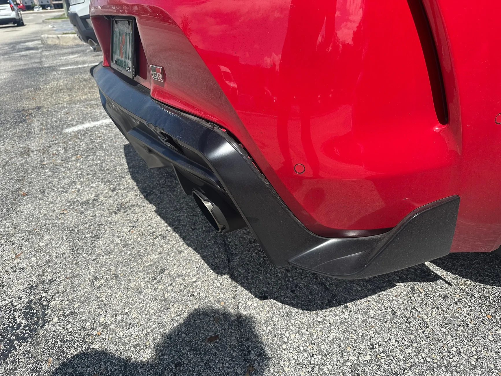

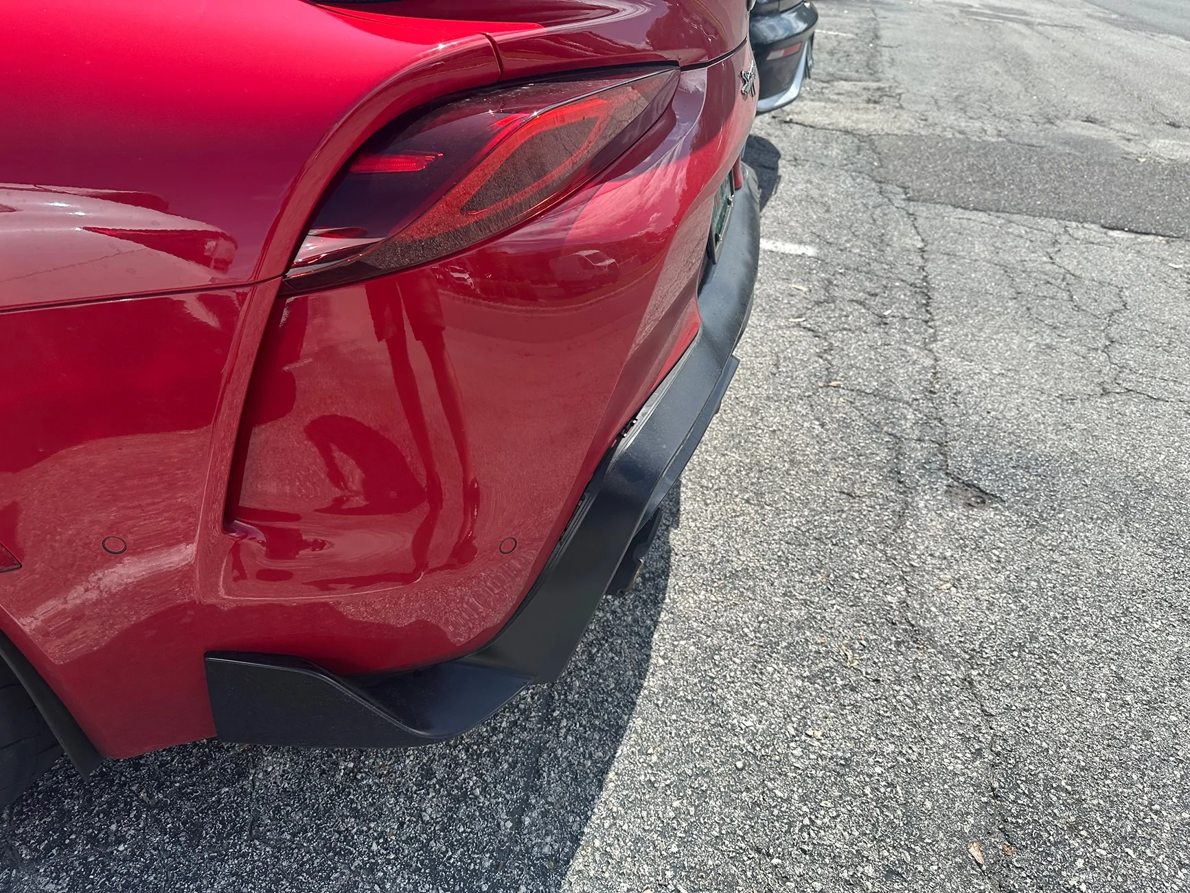

Well had a parking brake mishap with a family members classic car and it rolled into my 2020. It was pretty low speed and the bumper seemed to absorb the hit, and everything as far as sensors/ lights is fine. No in car codes or dtc codes so far so seems minimal. I popped the diffuser back in after taking pictures, but in the attached pics you can see where it’s damaged mainly near the tow hook cover.
I guess the whole bumper cover has to come off to replace the black plastic peice, but do you all think I’m likely good just ordering that?

Well if it helps anyone else replacing the matte plastic diffuser, the part# with parking sensors is 52108-WAA02 . If you don't have the sensors it's 52108-WAA05.

If I remember correctly, you don't need to remove entire bumper cover. there are few screws in the bottom and most can be poped out.
I'll check that out, would definitely make it easier. I've seen some people saying you need to remove the whole bumper and some not so i'll look at some videos .
