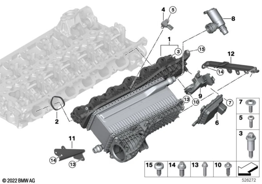

More interestingly, if the factory port injection and the bigger intake manifold/cooler would bolt up to a B58TU (2nd gen, B58B30C & B58B30O1).
Manifold looks like a single pass-through design, but core doesnt reach all the way to the back.

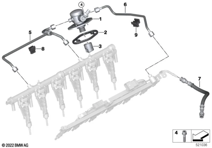

High pressure pump

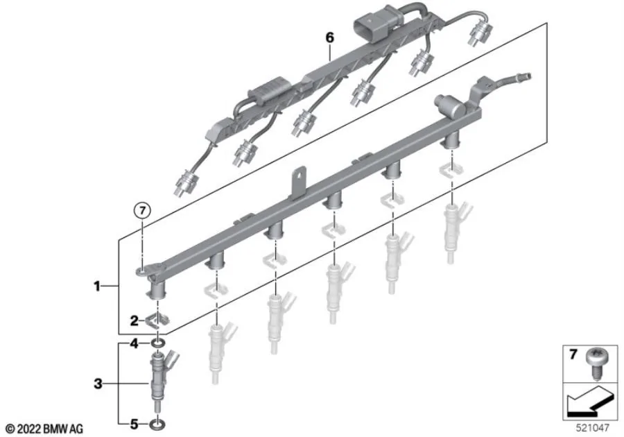

Low pressure rail injector
Intake system

I'm actually not that envouse with the TU2. Doesn't look like the manifold flows all that well, cylinder 6 looks very constricted and heard it went back to a 2 port valvetrain. What's the verdict on the electronic-vanos tho, is it any better? Maybe the TU2 hpfp would be a cheap upgrade on the TU but @ $1000, I'd go aftermarket. I Just wish the TU had the PI DME and electronics. Not a fan of auxiliary controllers and posi-taps.

wth is 2 port valvetrain? You mean 2 port turbo. It still has six cylinders. ;)
Looks like they went back to a cam follower for the HPFP as well, B58TU do not have a follower.
Whoops 2port head. my brain farted with the term.
