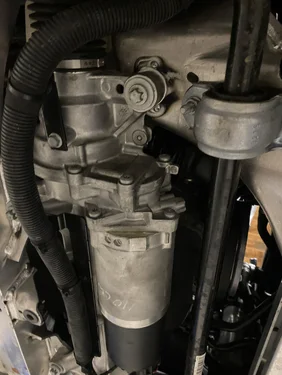

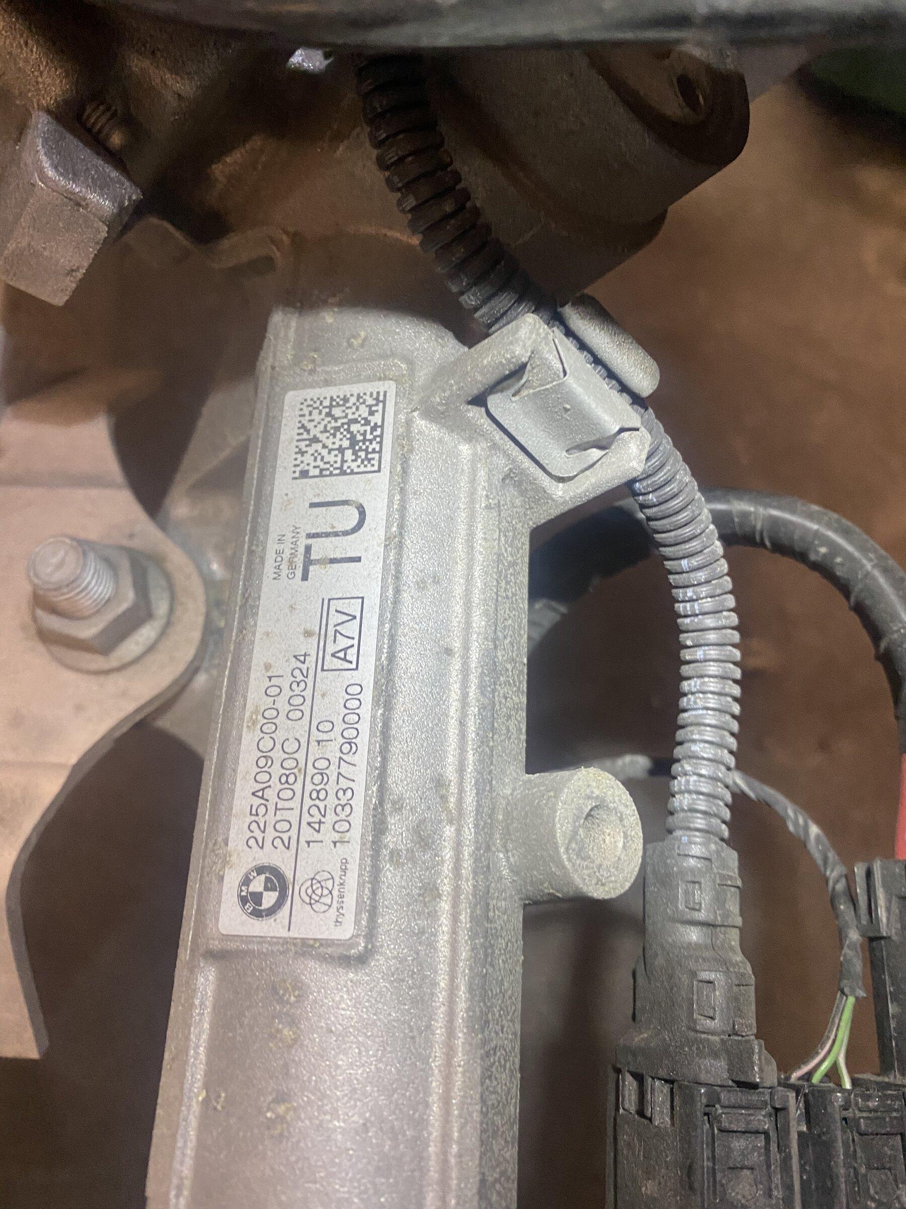

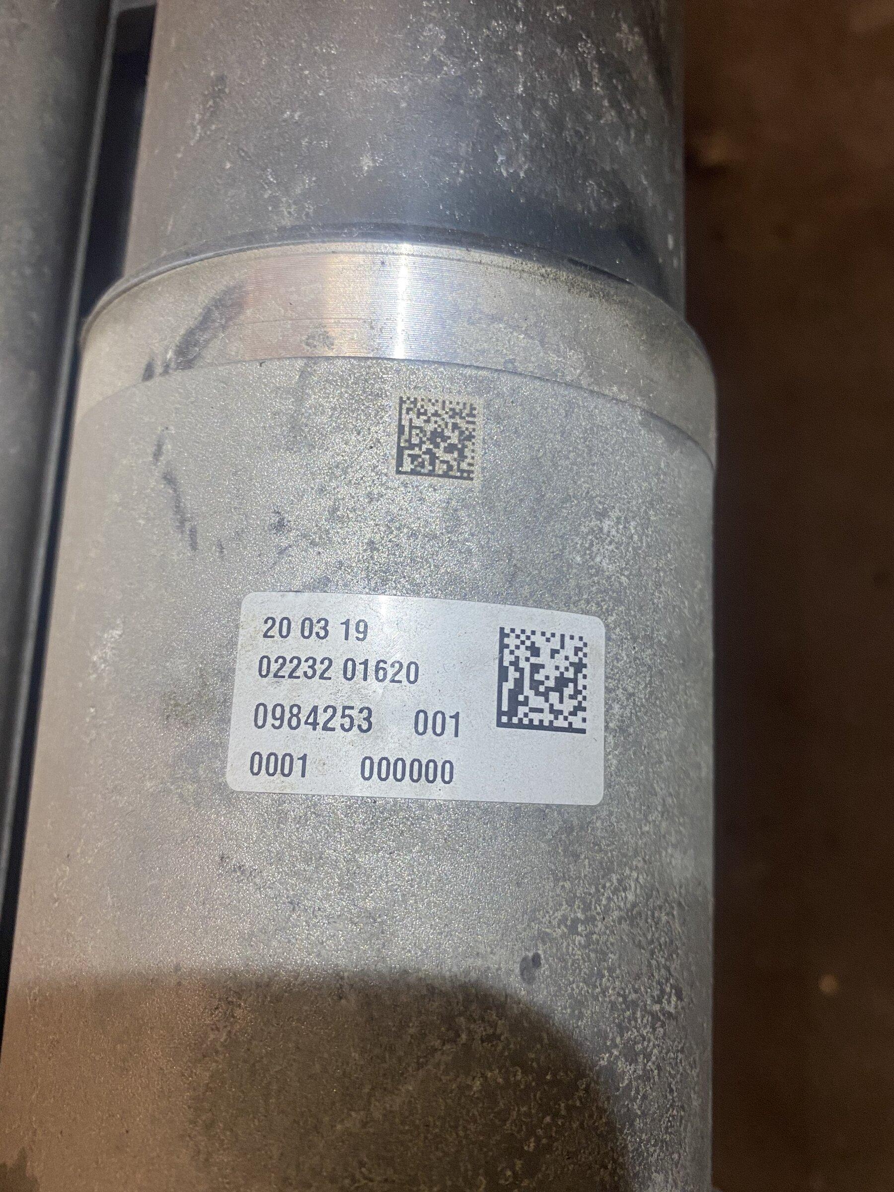

Wanted to add to the pool that I recently was diagnosed with a slipped Steering rack belt. 2020 with 9,200 miles. My abs ecu failed when I unsuccessfully tried launch control. I believe we slipped the belt trying to man handle the steering pulling it in shop. Talked with the Supra tech for quite awhile and he was told in training that they have seen this failure a few times. Most notably was when securing car on Dyno and trying to center car with steering when roller turning . Part numbers for rack attached

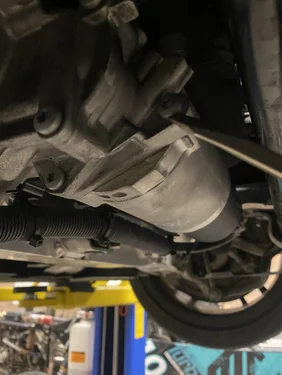

Ok, since I haven't seen a write up I'll give basic info. First off the rack has a small Gilmer belt inside it that assists the manual rack. They are independent if each other so if belt fails you still have unassisted steering, not death. The large brushless motor has a position sensor in it(verified it has over 900 degrees readable travel) that is used for various things including lane control and assists. What I think happened on my car was we pushed it into shop for abs dme failure and I turned key on while cranking on wheel. This caused the pinion angle to slip to -200. Dealer said I needed new rack but decided I'd try to repair. The repair is simple if you have a lift and you need a scan tool that will read pinion angle. View pinion live data to see where it at first(should be significantly off) With vehicle in air Pull lower aluminum panel. Locate 3 torx holding in electrical unit and remove them. Ignition on and with wheels straight , pull unit out while looking at scanner and reinstall as close to zero as you can. Tighten screws and you should be good to go. The whole process took me 1.3 hours . My car required a dealer trip because we cleared ps data that reset the zero point reference . Hopefully this helps someone from spending 3k for a slipped belt.
