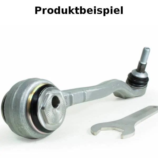

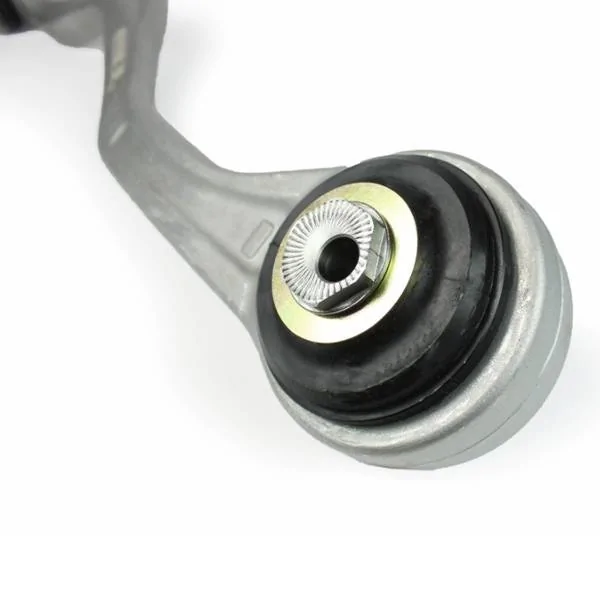

I came across these polyurethane bushings from Powerflex, which have a slighty offset stainless-steel sleeve to offer some adjustablity for camber/caster.
Anyone have some experience with these? How would these compare to let's say some Millway Monoballs, considering they are a fraction of the price?
Manufacturer description:
1. For the front lower wishbone: PFF5-5402G Front Lower Control Arm Inner Bush Camber Adjust is essentially the same as PFF5-5402 but with the addition of a stainless-steel adjusting sleeve and spanner. This allows for ±0.5° of camber adjustment to the front wheels, for improved front-end grip.
2. For the front radius arm: PFF5-5401GBLK is made using our Black 95A durometer material and supplied with anodised aluminium outer shells to increase bush stiffness by 300%, controlling longitudinal wheel movement under braking and cornering, and improving longer-term durability. It performs as the non-adjustable bush and allows for +/- 0.75° of caster adjustment, improving turn-in and steering feel, and correcting any steering pull.
Links to the products:
https://www.powerflex-deutschland.d...-innen--fuer-sturzeinstellung-pff5-5402g.html
https://www.powerflex-deutschland.d...osserie--mit-sturzeinstellung-pff5-5401g.html
