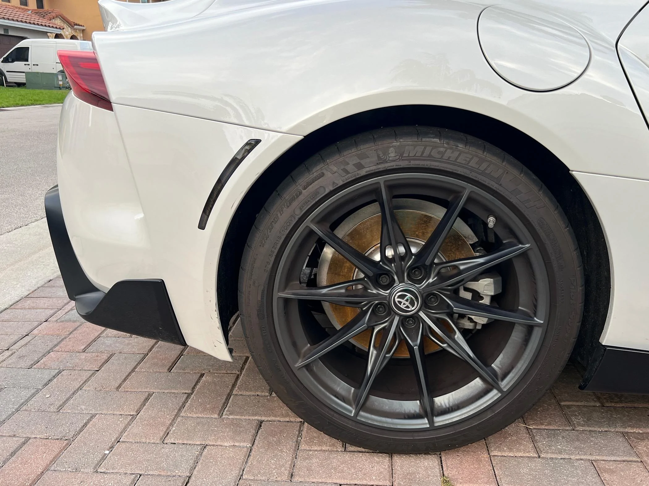

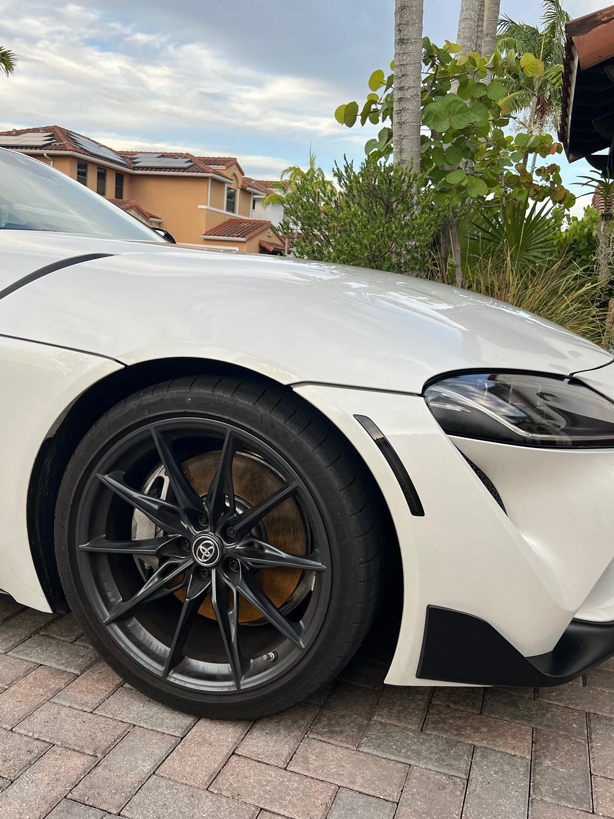

✅ Brake pad / fluid / lines upgrade
❓Why: Braking is more important than more power. OEM brake equipment is great for street driving, but on my first track weekend my brakes felt mushy and my stoping was not great (takes away a lot of the confidence). My instructor recommended to change the pads, fluid and possibly the lines for equipment that could take on higher temperatures for my next stint.
?Difficulty level: ? (Took the car to a shop with experience in this. I was not familiar at all with what would be needed)
? Equipment / products needed
- Front Hawk DTC 60 Pads Hawk $224
- Rear Hawk DTC 30 Pads Here $230
- Castrol SRF Racing Brake Fluid Amazon $110 (2 1 Liter bottles)
- Turner Performance Stainless Steel Brake Lines - Front & Rear Kit - BMW G29 Z4, Supra A90 MKV Turner MotorSport $169
- Rear brake kit 345mm x 24mm $600 (bought from fellow supra owner)
? Installation: Shop. 4hrs $480
?Total cost: $1813
Result: High performing brakes, fluid and lines
?Notes:
1. The ultimate brake guide for the car is Here: Mandatory read.
2. The base model rear brakes are 330 x 20 mm. There are no good options for high performance pads at that size. It is a better bang for the buck to change the rotors + calipers to the Premium model spec. IMO this is the only valuable difference between the two models. There is an active market and at the time of install $600 shipped was a fair price. (Rotors AND calipers)
3. These pads are dusty and noisy. NO way around that.
4. The shop installing the brakes, pads, and lines did a full flush of the system including the ABS. That requires specific equipment that I didn't have
5. The pads HAVE TO be bedded in obsessively. If I would do this again, I would’ve installed new rotors (they are not that expensive), I ended up warping the front ones on the track. So maybe new pads = new rotors when you are changing compounds. (We did everything possible to clean compound and bed them and again and again until they smoked and smelled by someone competent)
6. This car brakes very efficiently and the braking feels better as the laps go by. It was the opposite with my OEM stuff.
My car is driven very little on the street. SO I will keep the current stuff and not change to less performing pads. I dont see a need. My neighborhood thinks that the trash recollection truck is going around by the sound of my braking and that is ok.
Rotors replacement options Here. I think that for my current application, things like slotted or perforated rotors or big brake kits are an overkill and may actually not be as good as the standard OEM rotors with good pads and fluid.
? Rating 10/10 boost in confidence that I have enough braking power and that the risk of fading and spongy braking is decreased.
