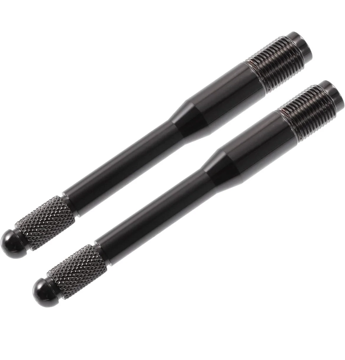

Changing tires in the Supra a pain the butt because of the lack of studs, the wheel falls off and replacing the wheel is also a pain.
The ultimate fix for that is a stud conversion.
Picking up the right studs requires knowing if you will use spacers and finding a good quality studs. Usually close to a $200 value.
I will not convert to studs at the time being until I have my second set of wheels for the track.
In the meantime, this little gadget fixes the issue of the wheels being difficult to change. And is very cheap.
Wheel Alignment Pin Mounting Car Wheel Hanger. $13 in Amazon
Highly recommended. Get it as part of your basic Supra Mod toolkit

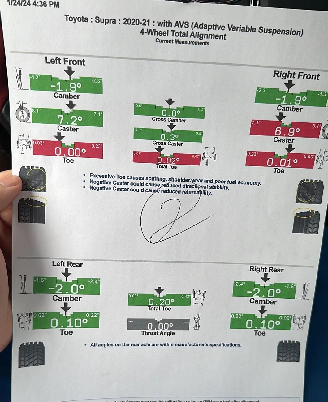

Stage 2ļøāƒ£ Mods
āœ… 4 wheel alignment
ā“Why: after dropping the car with the adjustable lowering springs, OEM alignment is lost. Need for a better alignment for the track
?Difficulty level: 1/5
? Equipment / products needed
- none
? Installation: shop. 0.0 hrs
?Total cost: $170
Result: proper performance alignment really transforms the car’s handling. Even though only the pros can feel a few degrees of camber or toe change, regular folks can tell the difference while driving in familiar roads. Provides a huge Boost in driver’s confidence with a car that feels sharp and stable.
?Notes: the OEM alignment serves one purpose: make it street friendly; but is not the best alignment for this car if you are planning to track it.
Natively, this car can’t have more negative camber, adding an adjustable suspension and lowering the car increases the negative camber which improves cornering, and allows earlier acceleration after exiting the corners as well as increasing stability and grip.
But the biggest bang for your alignment buck will be by neutralizing the large amount of toe in the car comes with OEM. It will improve tire wear and make the car much more stable on the straight and the entry of the corner eliminating that floaty feeling that many people complain about
Be sure to discuss with your alignment specialist whether this is a daily car, the amount of driving per year, what type of roads you drive on, and how many track days you will be doing.
look for an specialized Supra or BMW shop. Don’t go to a generic, or even worse, dealership center.
Load your vehicle with a full tank of gas. A very specialized performance alignment shop will align the car with you inside.
I will time the next alignment at one point next year when I have finished the aero part of the project and tested its effects on the driving characteristics of the car; taking into account how much downforce the car will gain, I’m expecting that I will require some adjustments.
? Rating: 10/10. This is a must for your car. The ride improves significantly.
What exactly do you mean by "neutralizing" the rear toe? Because more toe-in makes the car more stable, not the opposite.
Coming from a dedicated track S2K, I prefer the car to rotate easier. Thus I tried adding some toe out (up front) on the Supra. She didn’t like it however, lol. Got some errors on the dash. My car was lowered at the time. Hindsight is 20/20. It was too much all at once. Went back to neutral toe up front, height back up to OEM (for rub issues) and slight toe in, in the rear. You definitely could notice/feel more under hard trail braking when the toe was changed in the back.
It seems My car came in with a high degree of Toe in from manufacturing or maybe I introduce it during the Spring install.
What the shop did was to bring back to neutral toe in the front and slight toe in in the back.
It may be placebo effect, but the car feels more stable, specially on the back where it tend to go a little loose when coming out the sharp corners on the track.
Unfortunately, I never got a base OEM alignment and my figures were skewed by the MSS installation (I did it and it was my first time)
You are spot on. The shop tech where I took it recommended almost neutral on the front and some toe in on the back with the camber that the MSS springs allowed and no camber plates or more toe in the front as I was:
ā€œToo green to try a more aggressive settingā€

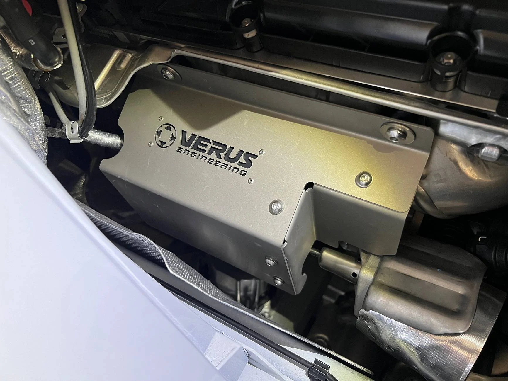

Stage 3ļøāƒ£ Mods
āœ… turbo cooling plate
ā“Why: in the crammed engine bay, the heat coming from the turbo mixes easily with the rest of the engine components and increases the risk of heat soaking (heat damage to the car once the car is off and the cooling mechanisms are off line). a cooler engine is a healthier engine and has more room to perform better.
?Difficulty level: 2/5
- Six port turbo heat shield by Verus
? Installation: Self. 0.5 hrs
?Total cost: $175
Result: there is a demonstrated decrease in temperatures outside the heat shield
?Notes: Recruit a friend to help you. It’s a crammed space and you will need an extra hand to hold the plate in place while at the same time adjusting the screws. Installation is straightforward
? Rating: 10/10. Turbo is shielded. The manufacturing quality of the Product is exemplary. Made in the USA ??

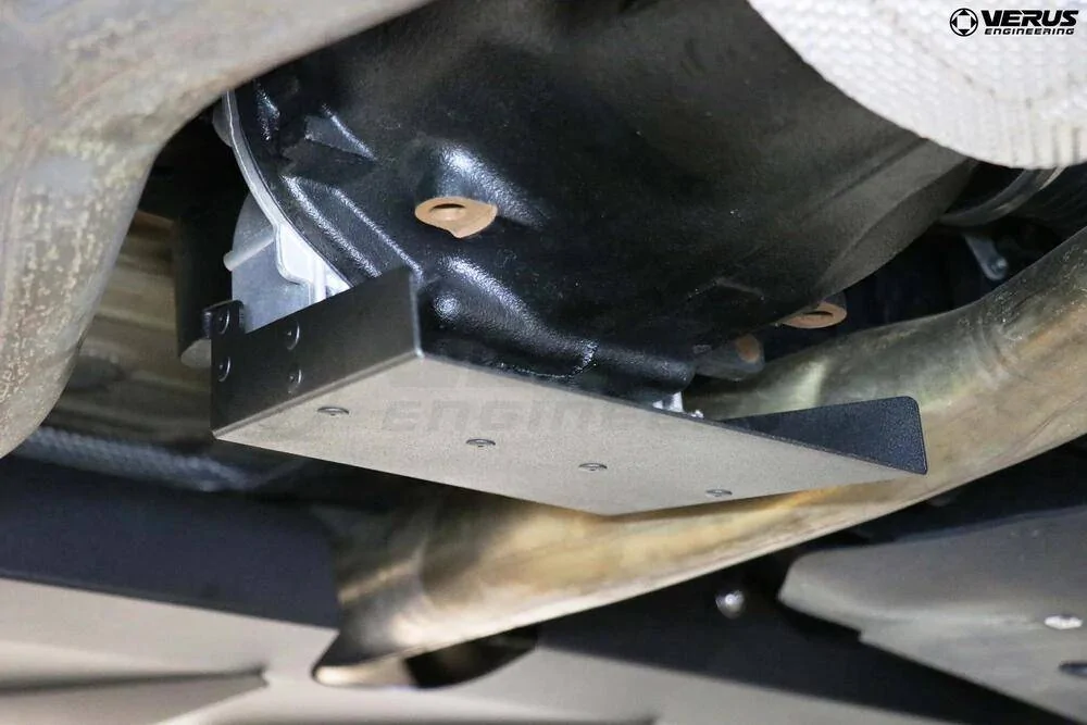

Stage 3ļøāƒ£ Mods
āœ… Differential cooling plate
ā“Why: another cooling mode that is easy to install and is backed up by data.
Trying to get as mucooling as I can get short of messing with the radiators or the manifold.
- differential cooling plate by Verus
?Total cost: $97
Result: Verus has published data on decreased temperatures on the differential
?Notes: very easy to install after lifting the car. Hoping that these cooling mods make a difference on the track. Time will be the judge on whether they carry downsides, like collecting debris. Installation is straightforward
? Rating: 10/10. Plate in place. is shielded. The manufacturing Product is exemplary. Made in the USA ??
