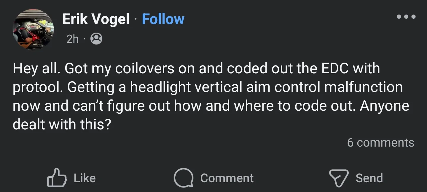

I’m getting the “headlight vertical aim control” error still after completing the steps exactly as shows in the razorlab doc. Is there a known solution for this? Thanks

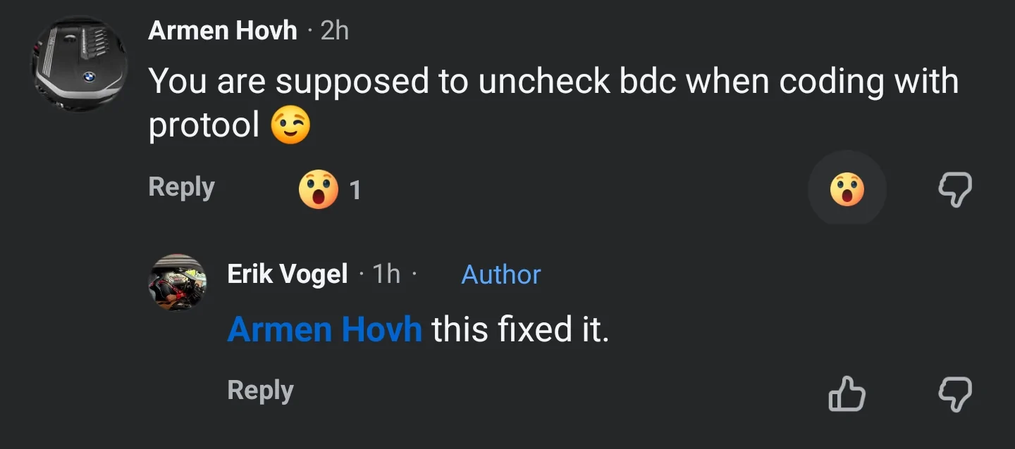

Correct also uncheck BDC. It'll be obvious when you get to that part.

So - I uncheck the FA, save, recode all modules and AFTER that I get a second coding screen where I deselect EPS, VDC, CAS and BDC - right?
