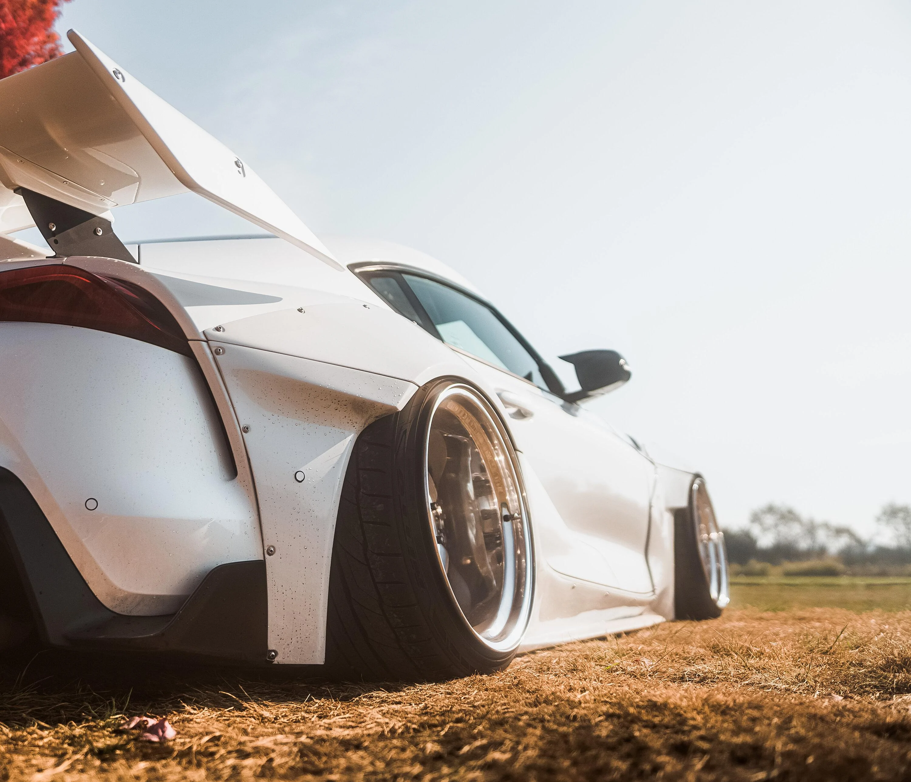

Look man, people on the forum want to help you out. The reality is if these wheels were of quality you'd be able to take out those bolts and just rebuild them to spec as you should with 3 piece wheels. Aohdan is mega cheap stuff so naturally when you're talking about building a big power setup we are going to suggest a good alternative.
As for first hand knowledge, as I said before a lot of people in this thread are already very knowledgeable. Here is a pic of how I am set up for my "first hand knowledge". I run a stretched tire setup. Is it the safest? No. That being said, it's a good quality tire on a good quality wheel. All I am trying to say is you're taking a genuinely bad quality wheel and further reducing its integrity. A lot of oldheads shit on my car all the time. People are just trying to help you. 😂
Also it looks like it will fit, to answer your question. I plugged the specs and it's practically identical to stock. So you'd actually want to run a 15-20mm spacer in addition.

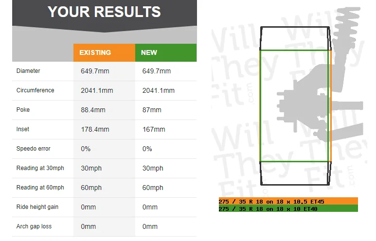

I plugged in your requirements into the wheel site for you.
I used OEM specs from here:
https://www.wheel-size.com/size/toyota/supra/2021/#trim-v-a90j29db-2019-2024-30i--382
Here are your results:
https://www.willtheyfit.com/index.p...=35&wheel_size=18&wheel_width=10.5&offset2=45
You will now have to climb under the car somehow and measure to see if you have 11.4mm inside and 1.3mm to the outside of the wheel well to verify.
This guide might be able to help you too:
https://support.apexraceparts.com/hc/en-us/articles/1260802325669-GR-Supra-Wheel-Tire-Fitment-Guide
Hell yes THIS is what I was looking for that helps a ton now I have something to go off let's hope this carries over to real world lol. Thank you!
