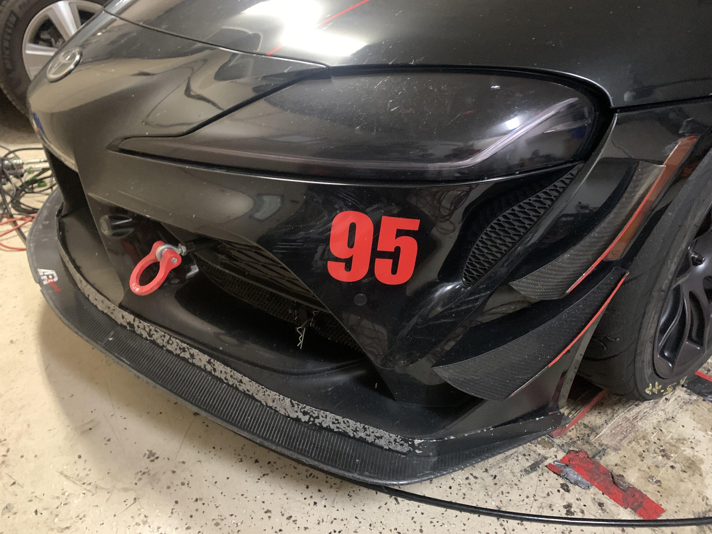

How are you guys keeping the front of your cars so nice? After just one season, the front of my supra is pitted pretty bad, just like my previous cars I have tracked.
Maybe I follow people too closely?
Ignore the splitter and canards as I literally just put them on right before these photos...
Mine is always sand blasted. I made the air dam on mine out of aluminum. Have painted several times with truck bed stuff just ends up back like this. Not a show car(lol) but hopefully a go car!

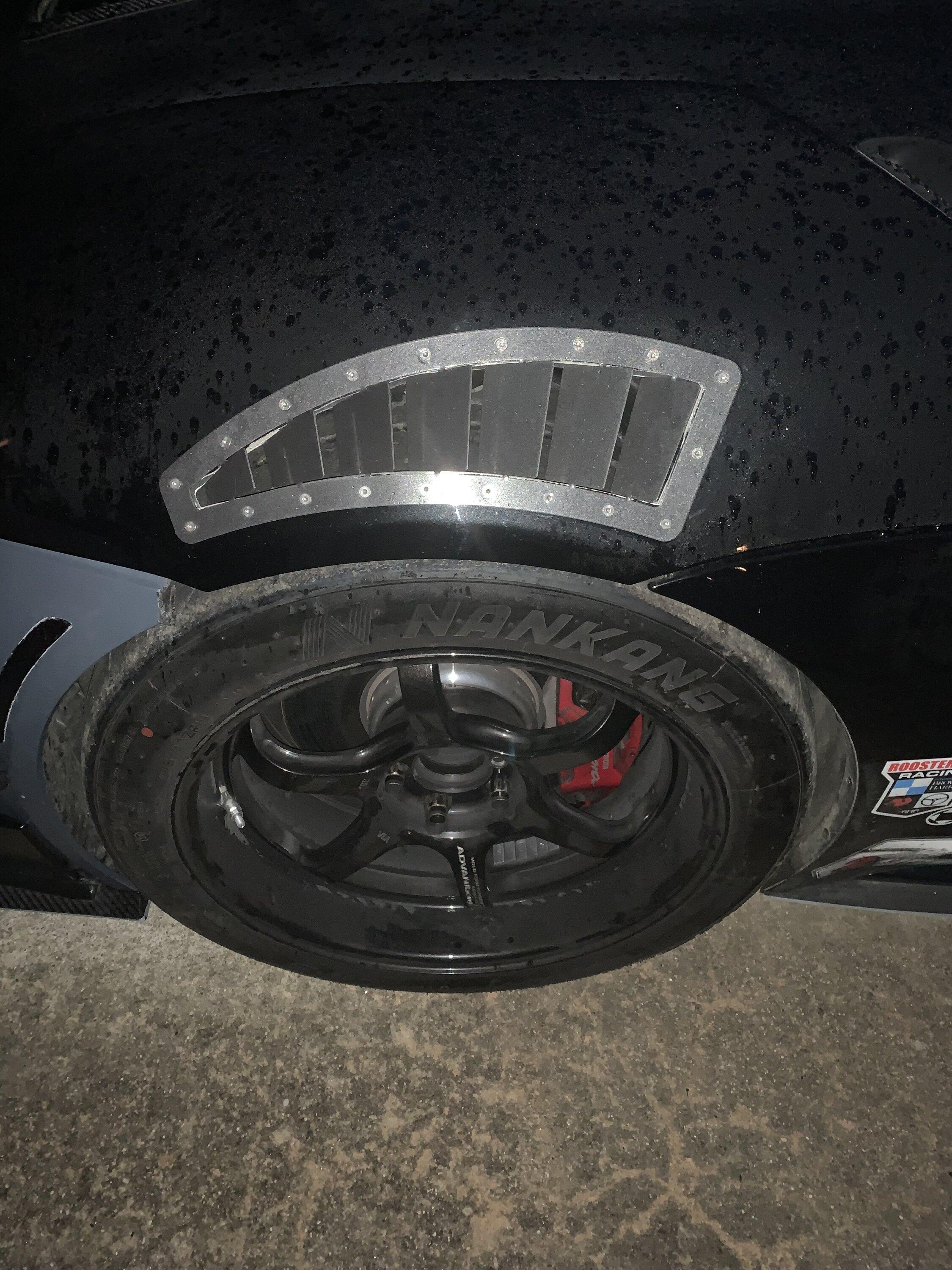

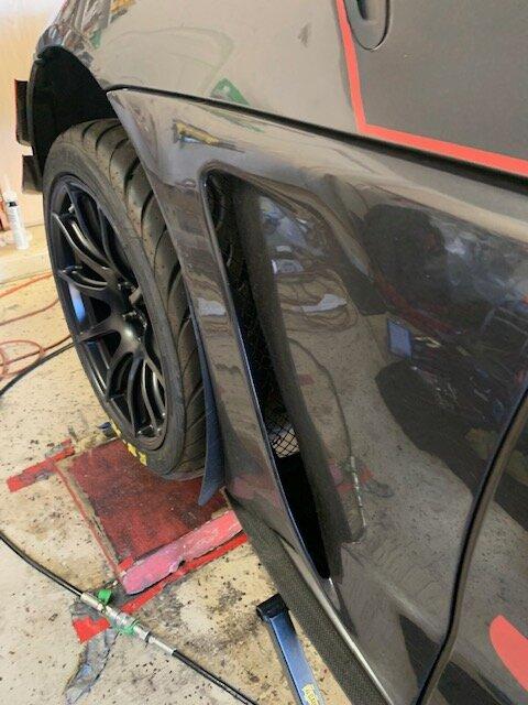

I am also glad that a few others have done the verus hood vent - just needed to get past cutting a hole in your brand new hood.... I also put vented fenders and cut out the wheel well/ screened it. Again trying to manage brake heat. Here is a pic so for those going full track mode.
Have you gone with the Verus brake cooling kit? That is night and day for maintaining brake heat

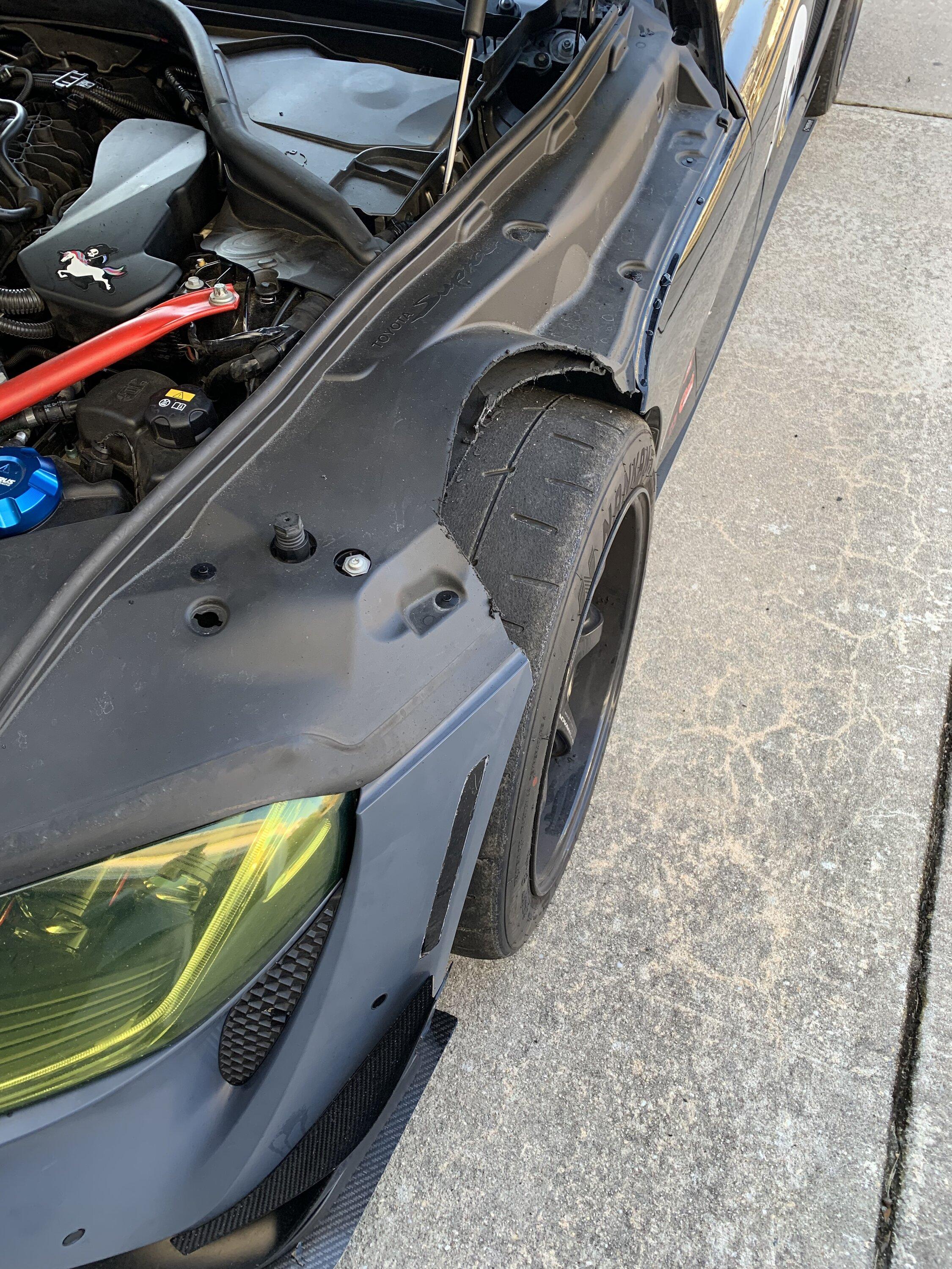

Thanks for the pic. I was looking at the top fender vents but wondered how to get that open so let us know how it works. Now just have to cut another whole in hood and get a good vent. I also found the 4' grinder with a cut off wheel does wonders on that plastic vs a small Dremel.

Also….Dremeled out two layers of plastic and wheel liner to vent wheel arches today
I completely removed that upper plastic piece completely when I did the intake manifold/heat exchanger and never put it back. I have wondered if there is a practical reason to need it other than cosmetics.
