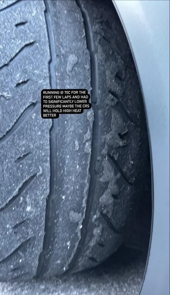

Friday was a good track day.
It was a hot day but my tires got unbelievably hot @ 158F...recorded by the car.
Not sure if it's a RT660 thing or a combination of the heat that day.
Hoping CRS will wear a bit better
158 is actually not bad at all. Almost to perfect operating temp. Keep driving!
Your photo of the tire looks normal? Most of that is track rubber you picked up.
Looks normal to me and I wouldn't consider 158F overly hot either. Above optimal temps but nothing to worry about as long as you know you may need to start braking earlier or reduce corner speed. In the afternoon sessions in June/July in the south I can hit 200-215F near the last 1-2 hotlaps of a session.

Good to know those temps are fine, I always thought a hot tire should be in the 125-150 range, good to hear I was in regular temps. Those of you running a super 200, what pressure are you aiming to run hot?
