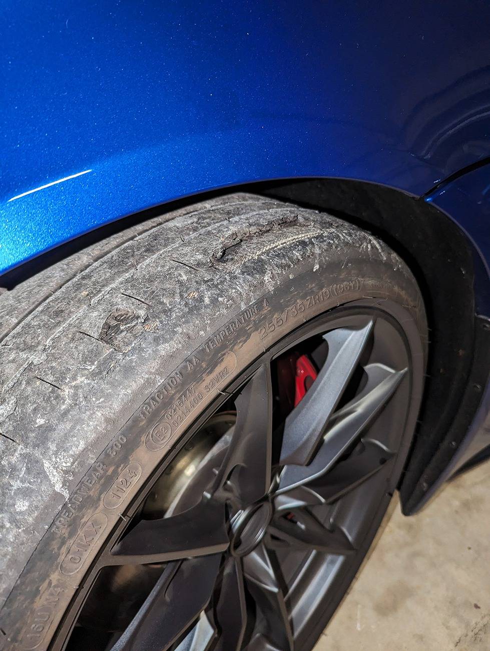

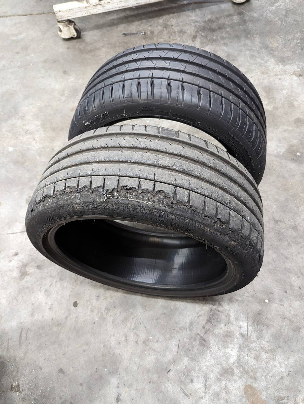

It's a track-dependent tire issue, not camber. I've failed PSS and PS4S in the exact same way on cars with solid track alignments. There's not enough sidewall strength so they roll over and peel the shoulders off.

In the case of the car that shredded 3 pairs of PS4S with a good track alignment and a check-every-box list of SPL parts -- that was solved by switching to a more track appropriate tire. Zero other changes and never a tire issue again. No amount of negative camber is going to make a PSS or PS4S survive a fast driver. And I've run RE71RS (and many many other 100-200TW) without issue with -3 or less.
Look at the sidewall of the PS4S I posted above and tell me another 1-1.5° would have solved that. :rofl:
