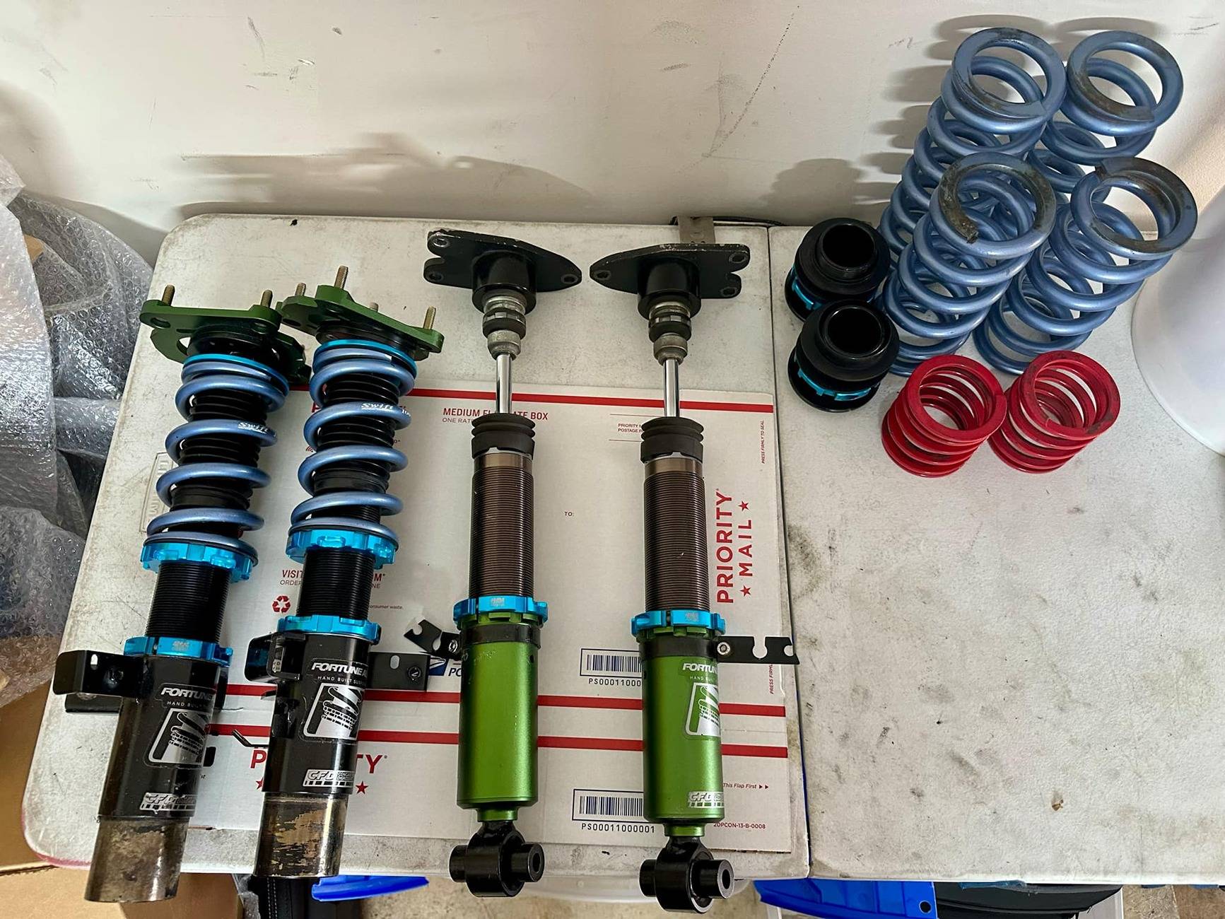

After reading @rwense review of the FA510s, I reached out to a member of the supersecretsupradiscord who had a set for sale.
10k fronts, 14/18k rears. Tighter low speed dampening per the original shop that spec'd them. Aluminum shock bodies, heim joints, the whole nine yards.
What?! Lemme in! ?
