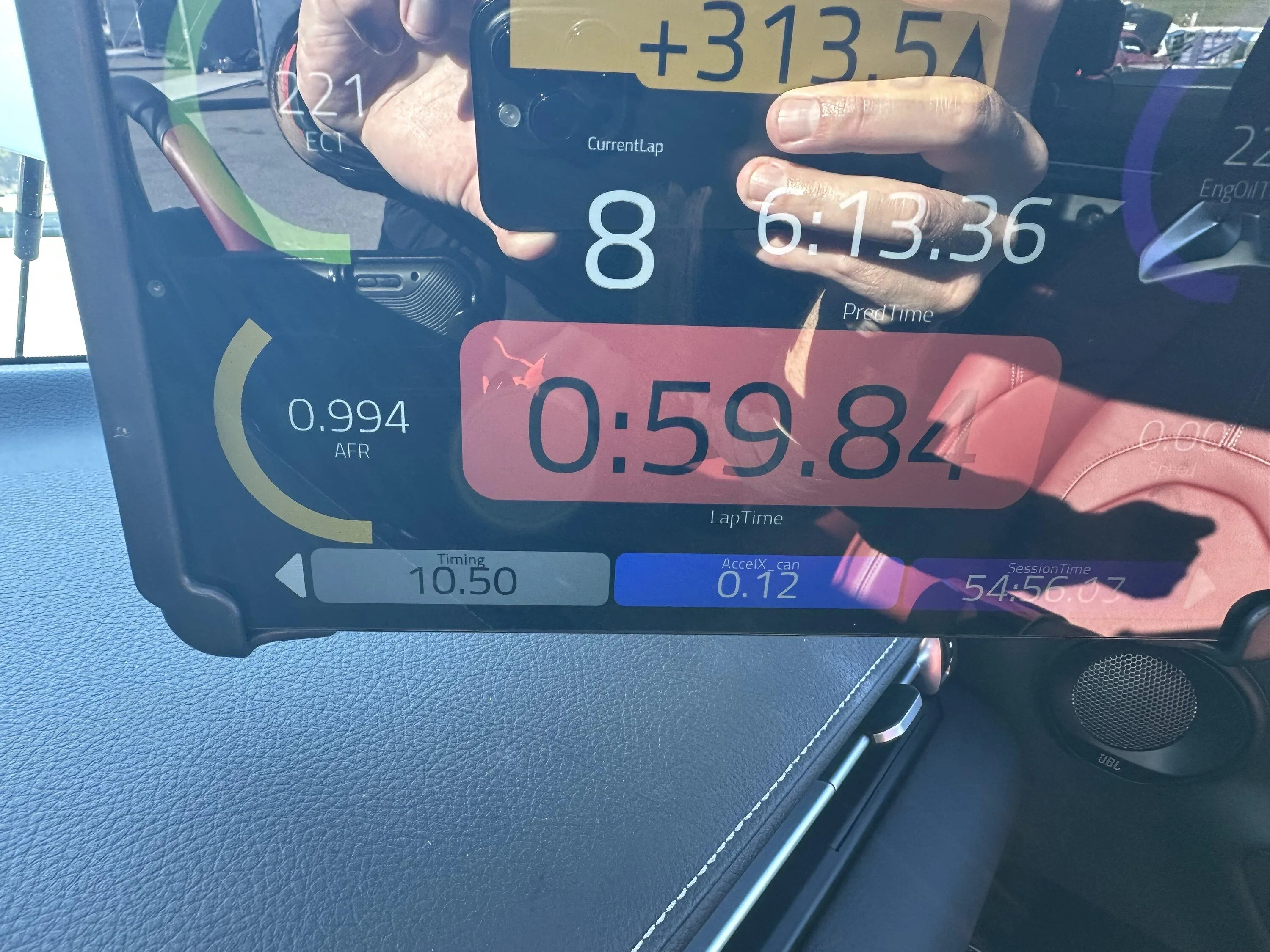

I monitor AFR, Manifold Temp, Coolant and Oil temp via my tablet display.
@neverknowsbest Here is the display I used last season.
Nice thing about the software is you can configure items to flash or even the whole screen to flash when things hit certain thresholds, because as we all know, you rarely have your eyeballs on a screen while on track.

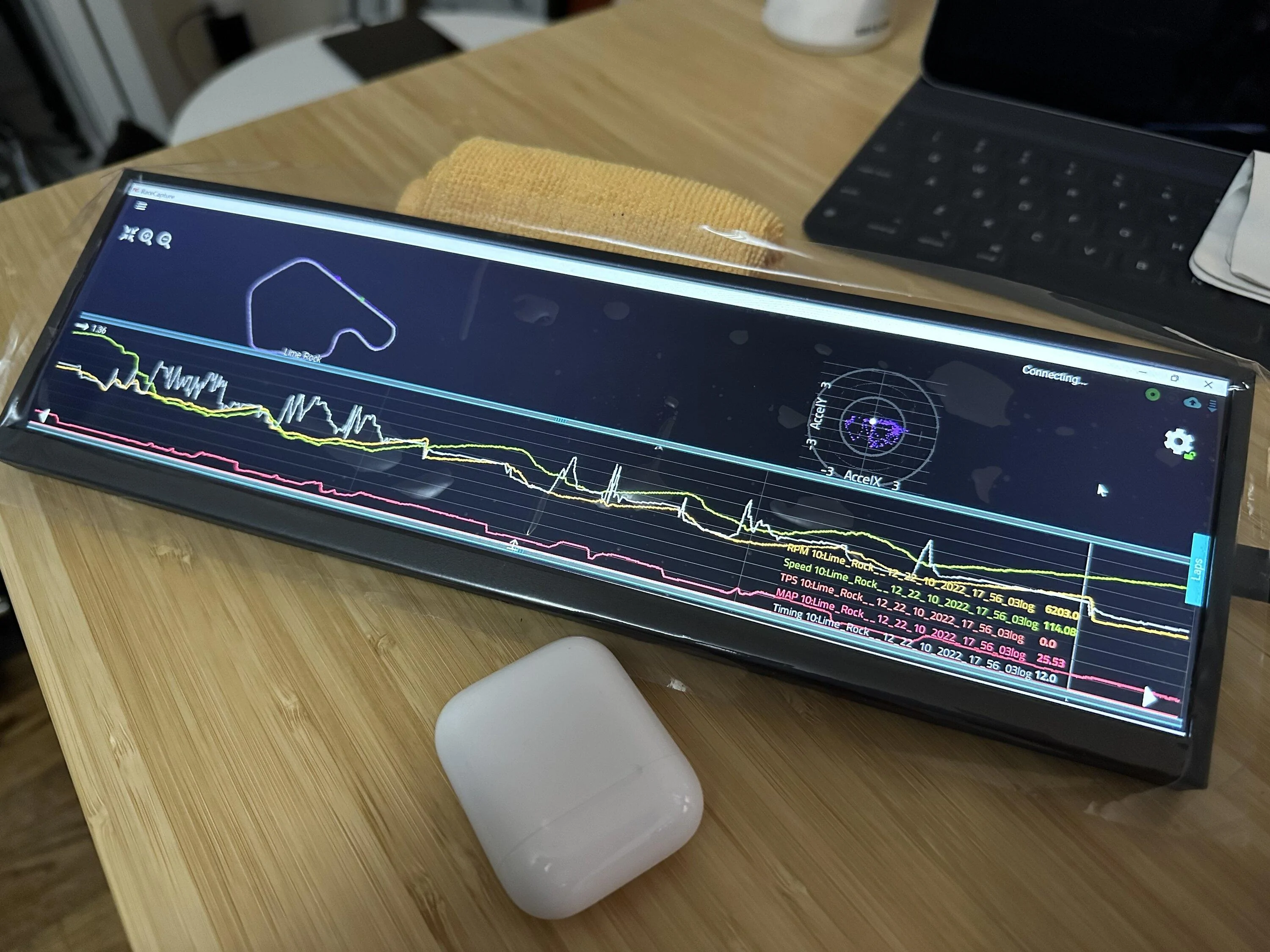

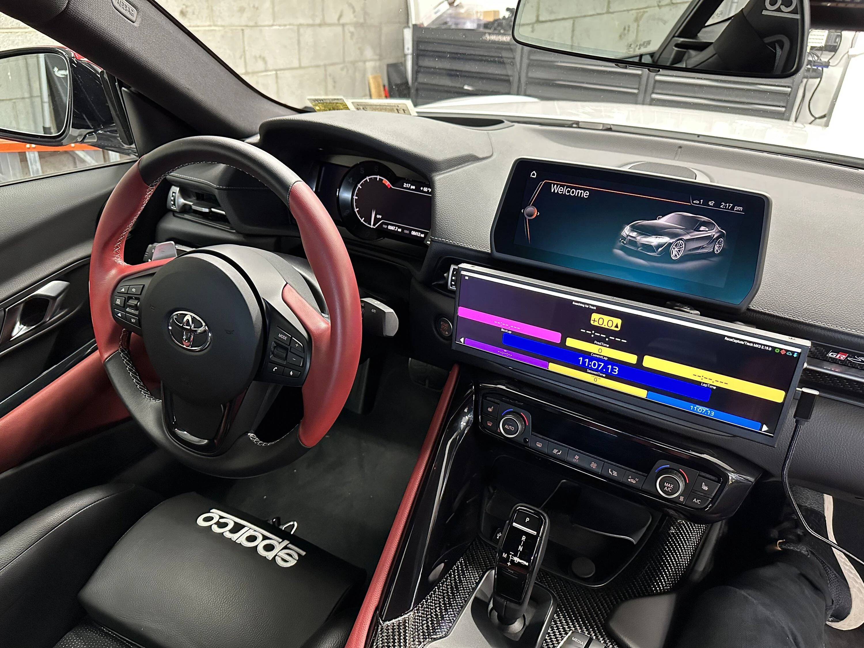

I have a new setup I will be trying out this season with a couple different sizes, this being the largest:
and probably too large, but will work great for after session data checking:

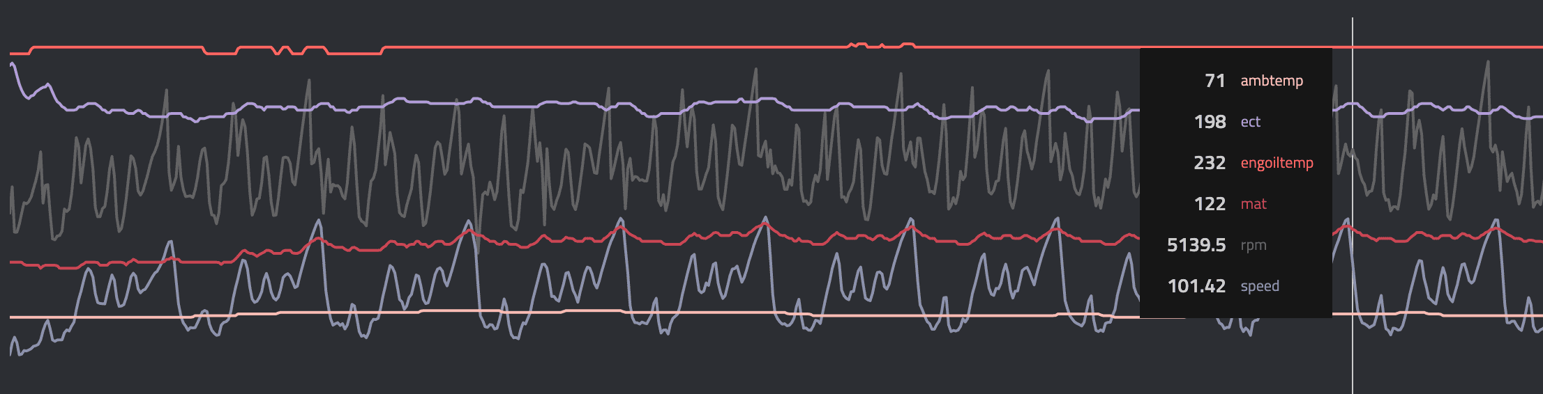

Here is some data from a session at Lime Rock in 71* ambient temps. 100% stock power, stock tune, zero power adders, down to the oem paper intake filter.
You can see the system does a good job of cooling. Oil temps basically don't even move.
https://datazap.me/u/razorlab/updated-lrp-log?log=0&data=10-18-20-33-44-49

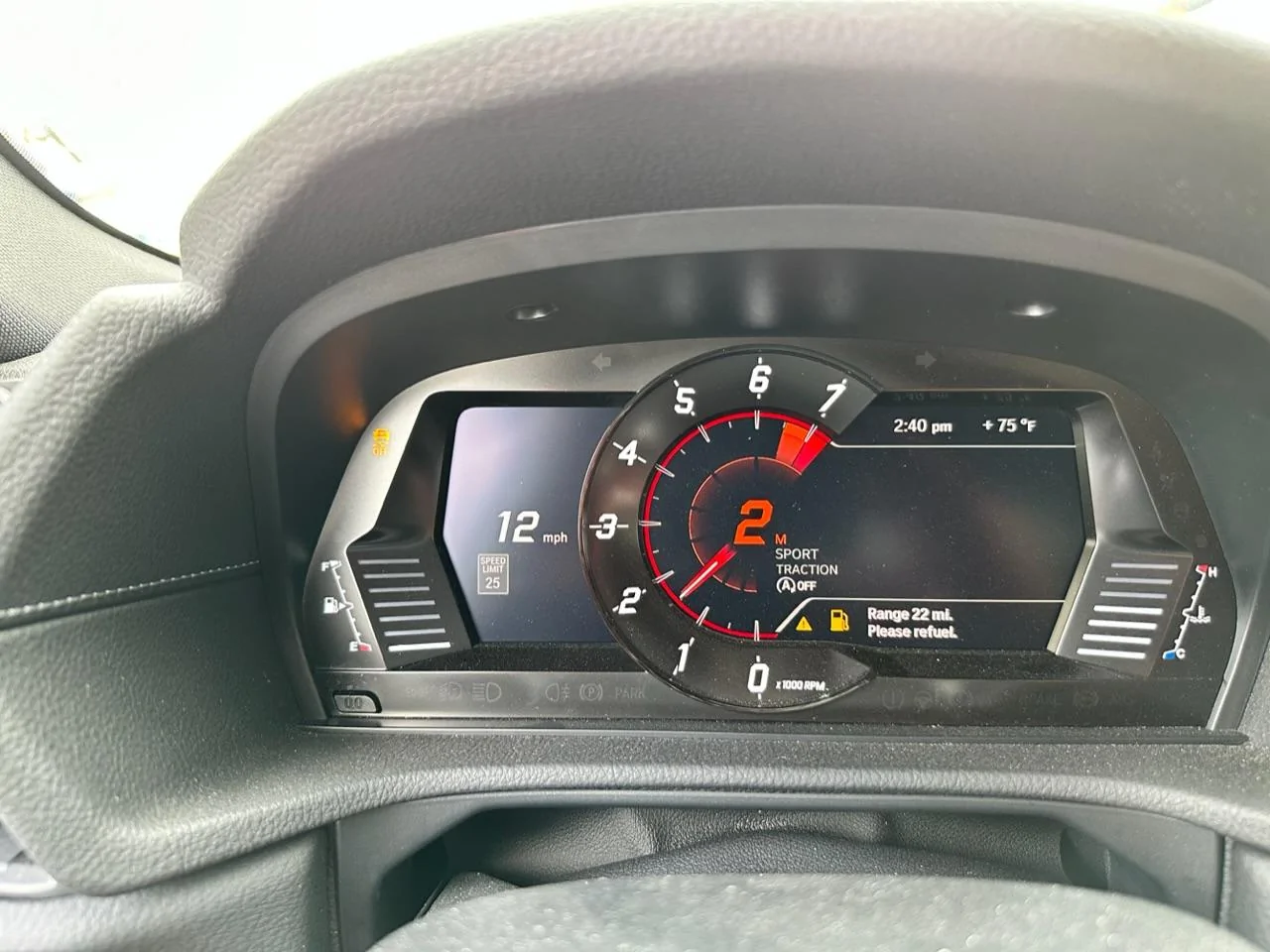

Real quick info (running to work) after a great weekend at Homestead. Last session I ran her hard on fuel reserve. No hesitation or fuel starvation. My lap times were consistent all the way to the end. I’m not recommending anyone do this but wanted to share my experience. I kept the “miles to empty“ on the dash and can say she was accurate all the way to the station ⛽
I definitely will be more careful next time ?
Also LOVED the Garmin Catalyst. My 1st weekend using it. I’ll have to go to their cloud and figure out how to off load the videos. Lots of cool data on their phone app. And the unit itself has tons of information & great video! Will share when I get around to it :)
