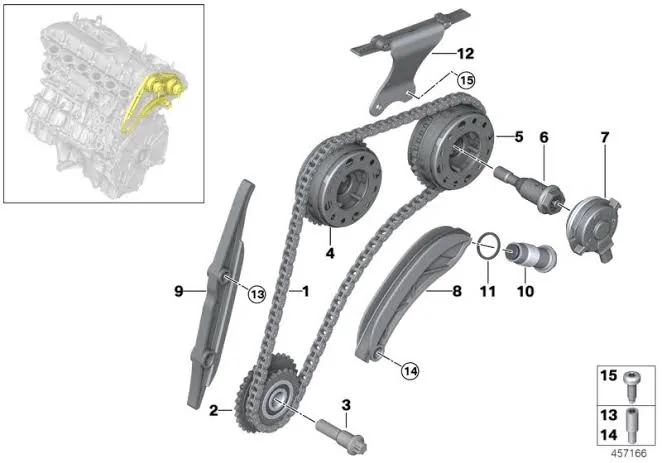

As I mentioned in the no rev issue thread sounds like the vanos solenoid.
/me thinks there(theory) is a batch of faulty actuators which are causing issues with the supra B58 engine.
Located at rear of engine next to timing chain the solenoid controls the variable timing of the engine and instead of replacing the solenoids in the new updated B58 the actuator can be changed instead.
A special pin wrench tool is required to remove it. Part is about $58 but the special tool is required.
Best to take it bmw and get it done as it's common issue with the B58. Toyota should pay for the service under warranty.
Toyota as usual are clueless on this issue sweeping it under the carpet.
Part #7
Part #7
This actually seems pretty plausible. Did you bring it up to a Toyota tech? Seems like something they would try to look at, maybe they (Toyota) could even call BMW to verify
