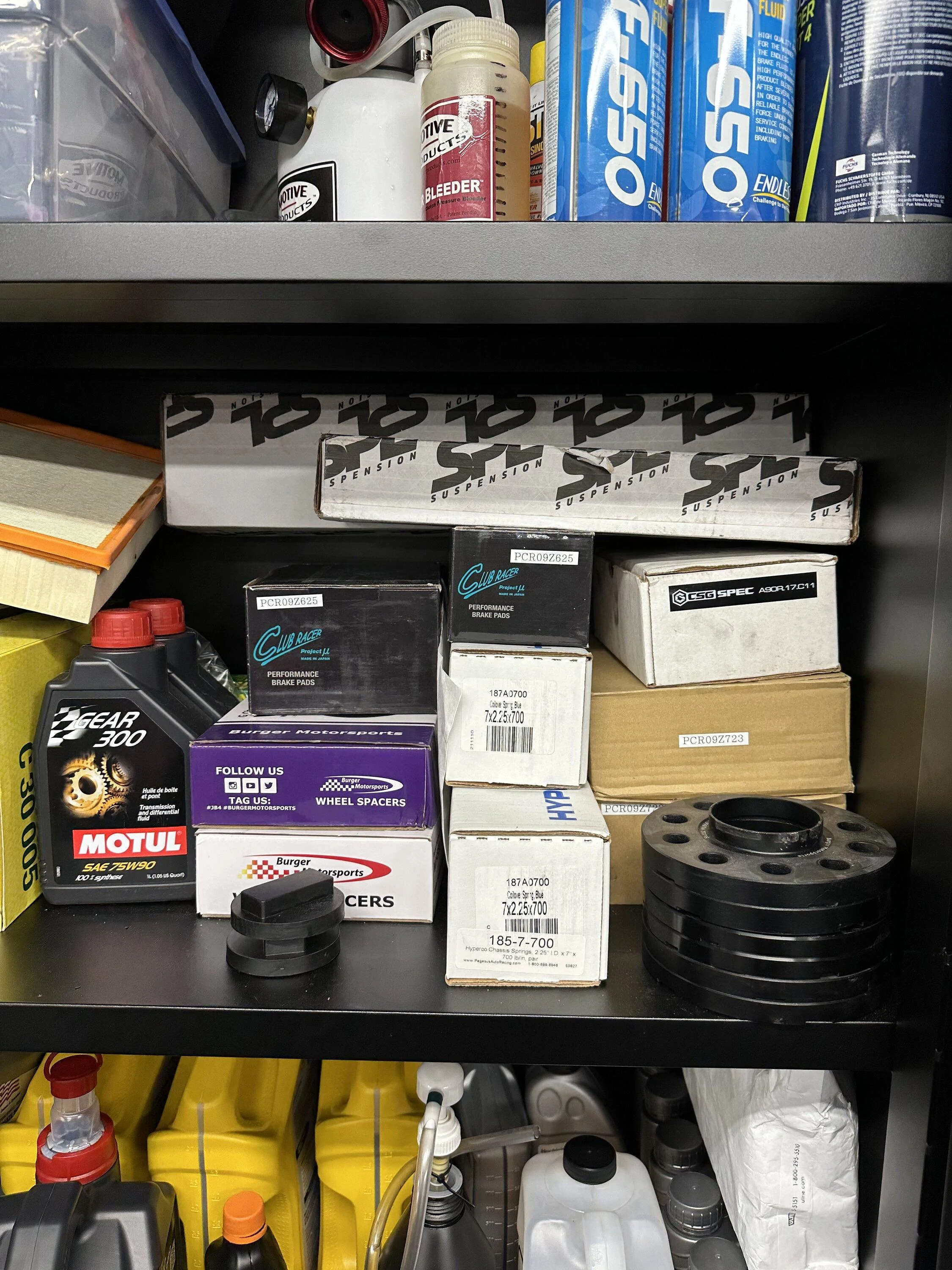

Motul is for the rear diff. OEM for gearbox.

The F is happening here. The oil is fine. I personally have a billion laps on track with it, as have a bunch of others. Myself and others have shown the work while you just yell in all caps.

Ordered Project Mu Club Racer front brake pads months ago and finally came in, after my season was over of course. I guess these are like gold nowadays because I inquired how many more sets they have in stock now so I could snatch more up but POOF, out of stock again.
On to the shelf they go for next season....

Sorry for the capitalization, by mistake. I was just saying that Motul says it's not suitable for your car. The differential isn't broken, but the self-locking system may not be as efficient as it should be and that's harder to figure out.

Bro your replies are killing me. It's not that hard to do them properly. How do you mess them up so much?
Also, the oil is fine. It hits all the same requirements/standards as OEM. OEM is GL-5, so is Motul 105777 and LiquiMoly 22090. Both of which I have used for over 70 track days, and tons of other track guys use.
Sorry, you are wrong. Real world experience > whateverthefyourrepliesare
