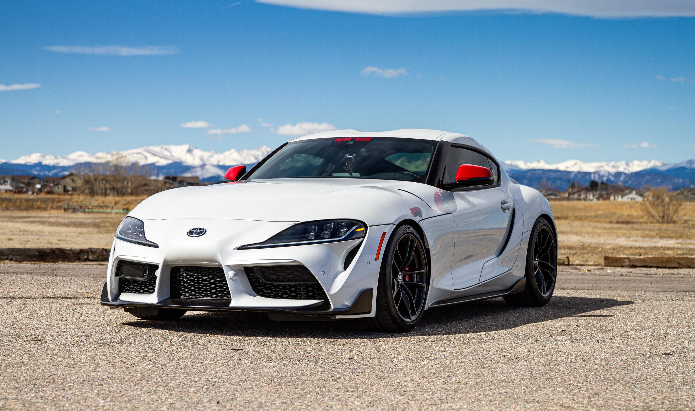

2020: When I first got the car, took it easy for the first 6-700 miles then took it to the track completely stock. 1000 miles hit, went to a Titan downpipe, Titan pro tune module, H&R springs and spacers. The same stuff probably 80% of owners do. Quickly decided I wanted more and went to BM3 around Feb. 2020, and then met Jeff Payn as he's local to me and made the switch to ECUtek once that was going, around April if I recall. Added the Rexpeed duckbill and TEs beginning of summer and the car stayed that way until early 2021.

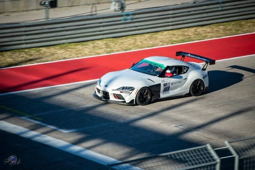

2021: Now was getting into wanting to do a little more with the car. Got a set of HKS springs on order and an LG carbon front lip. Think it was March when the Tomei finally released and got that on order ASAP. Did a couple lapping days with the car like this and then added the Verus wing towards the end of May and the EVS fenders. Car stayed this way through 2021, all of the other upgrades I threw at the car in preparation for this season.

Nice! Fellow Absolute White LE track driver here.
How was the cars balance with just the Verus wing, without the verus front splitter?
RichSC
RichSC
Rich
Dec 3, 2019
212
277
Parker, CO
2020 LE Supra #86, 2018 Raptor
Little bit of imbalance there. Not crazy like I felt out of control or anything, but the front end didn't have the grip I wanted/needed with faster sweepers. I was also on the HKS springs and factory struts at the time. The springs were good for the added clearance, but were still on the soft end of things.
8,785
17,248
Did you feel that it added stability to the rear with just the wing, without making it an understeer machine?
I'm on MCS coilovers and SPL bits.
RichSC
RichSC
Rich
Dec 3, 2019
212
277
Parker, CO
I think it did, and without making it just awful to drive. Front end I felt wasn't really where I wanted it till I added the splitter, but wasn't terrible.
