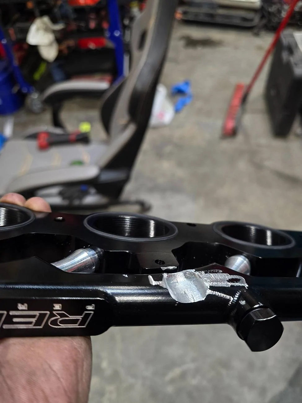

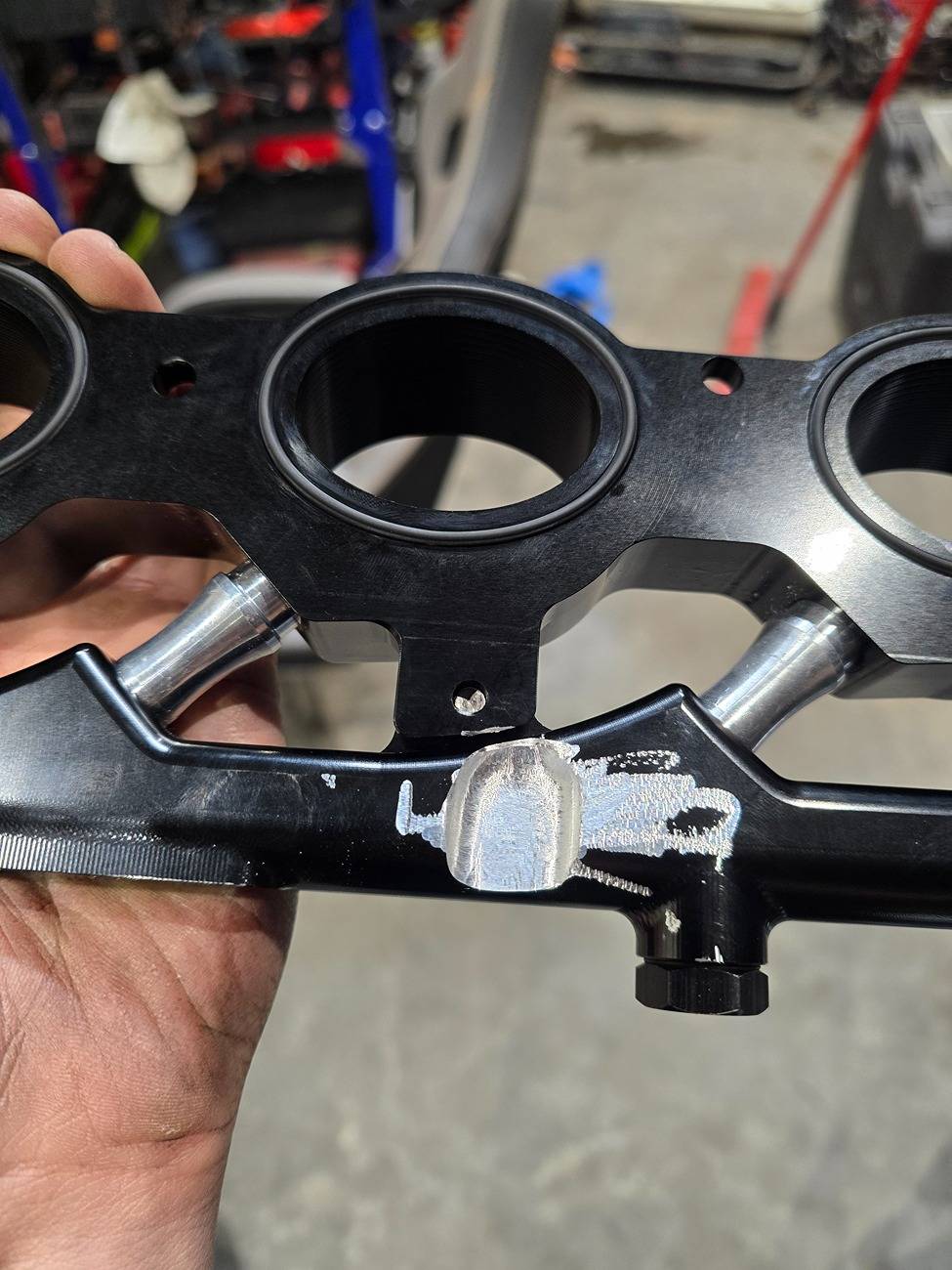

I am having an issue with the remnant PI Plate hitting the water manifold. It can be seen with the orange marking. I had to take quite a bit of material off the PI plate fuel rail to get it to fit, and still only have about 1.5mm of clearance all around(luckily I didn't go through but idk if I'd trust 80psi of fuel not to break through ? regardless we're using port injection through the intake manifold). Alec was kind enough to send another PI Plate to test fit and it was hitting the manifold as well. He also offered a full refund, even though it was modified and pretty much installed, but we declined as I appreciate the build quality and research gone into the product.

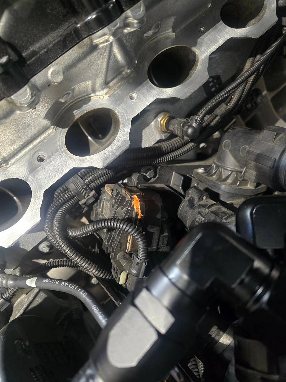

My question is, does anyone know of any revisions done to either the oem water manifold or the intake manifold deck on the head? I dont think its an issue with the water manifold though because even with the pi plate clearing, the manifold still sits too low. Client has owned the car since new, and Im the only shop that has worked on it or modified it. I've worked on quite a few mkvs and even more b58s so im not inexperienced but i also dont know everything. Can anyone send a borescope down underneath to show how much clearance they have so I can attempt to replicate it?
The intake manifold sits too low even with the modified PI plate rail & phenolonic spacer, and pulling the oil filter out is gonna require loosening the intake manifold. I have probably 1-2 threads remaining when the oil filter housing hits the Remnant intake manifold. It did however pass a 20 psi smoke test but we plan on pushing quite a bit more then that with this build, so we will see.

Spacer is used. I was able to finally get the intake manifold to seal after slowly grinding down PI plate.

I considered putting spacer under PI plate, but is it not possible because of bolt pattern. And that would make it even more difficult to get oil filter out. With the way it sits now, the oil filter hits the manifold with probably less then 2 threads remaining. It's almost like if i didn't shave the PI plate down, it would clear. And I'm beginning to wonder if maybe all the PI plates are hitting the manifold allowing them to somehow seal and lift the manifold to clear the oil filter just enough. It's worth mentioning that I did not try to fully install the PI plate until I made it clear the water manifold.

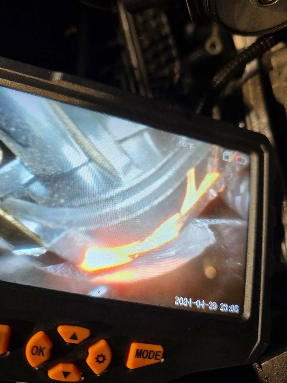

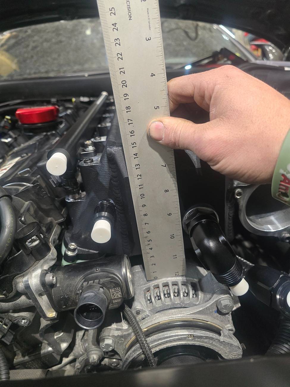

I do not have clearance issues here. Reserving this spot to post some pictures under the IM with a borescope. Mine is a 2020 model.

I bought a borescope the other day. I'll check mine out too. I can't change my filter either without loosening up my mounting bolts, but that only takes 5 minutes so I'm not worried. I took my manifold off this winter to make sure I installed it properly and I did. I watched the install video so many times to make sure I didn't flip something wrong or skipped a step.
