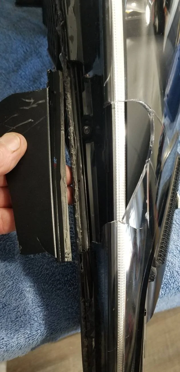

Ok. Headlight lens is connected with a very deep channel with high stick butal.
Have been working on headlight for a while.
Took out broken part by cracked part of my lens.
Channel is a1/4 inch deep. ( See pic).
Heating with the heat gun barley touched it.

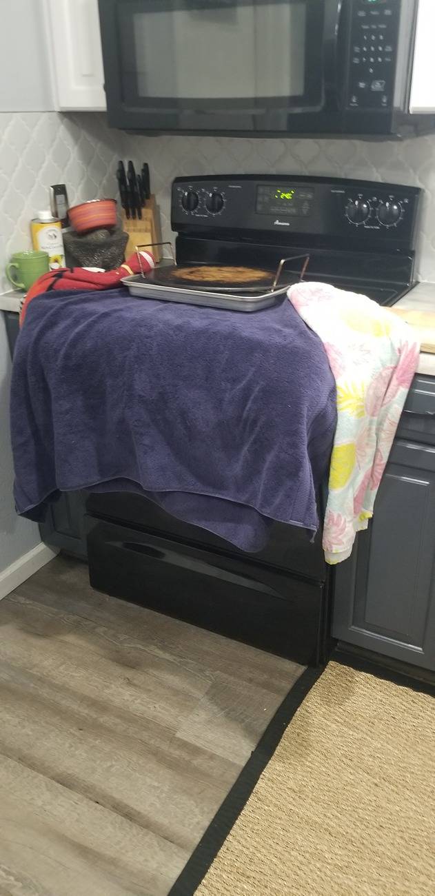

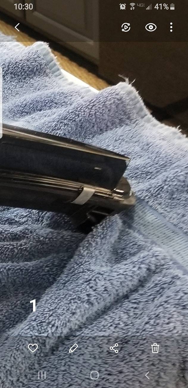

The oven works with door open, just have to place something over door. I used a piece of ply wood, then rolled up towel between door and wood. Filled in sides with small towels then covered all of it. See pic below.
Video said 20 minutes at 240 degrees.
Barley was able to move lens after messing with it for 6 to 10 minutes. Put back in for another 20 minutes.
Started moving better, so maybe try 25 minutes. If not moving throw ot back in.

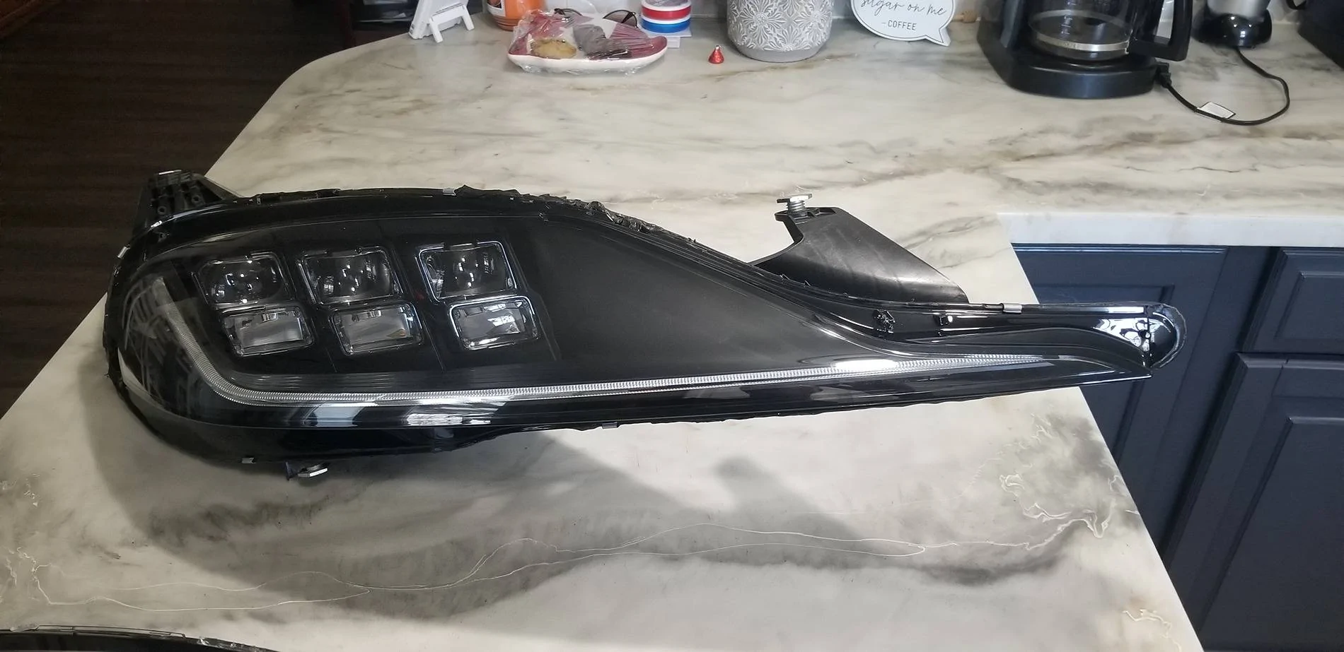

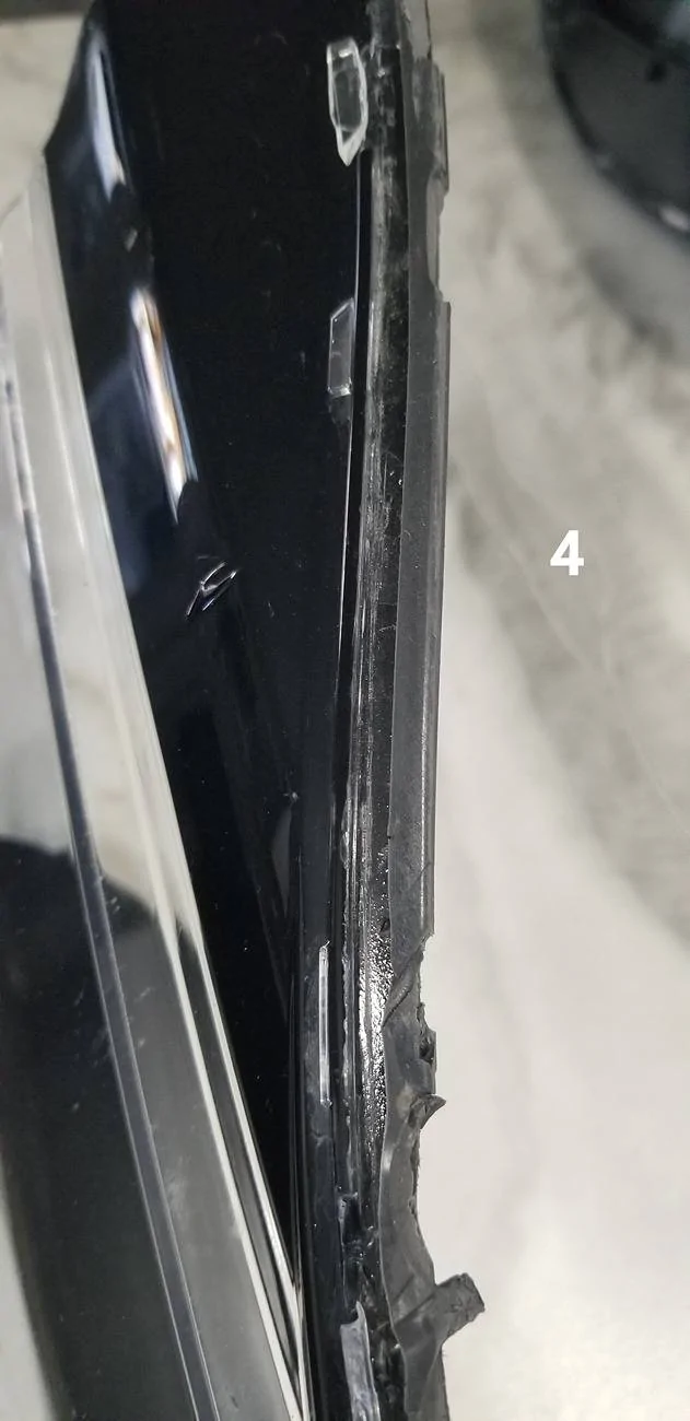

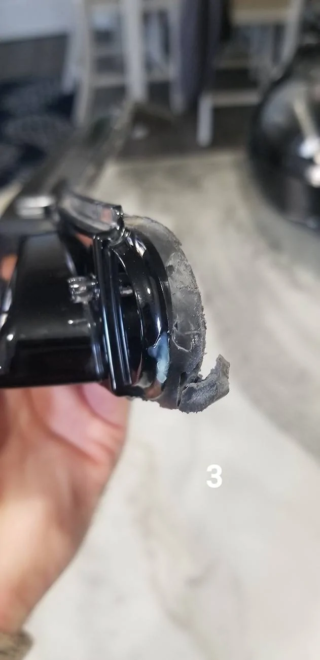

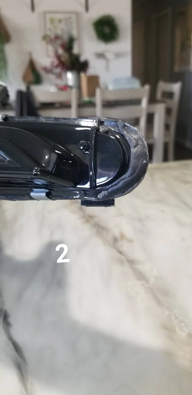

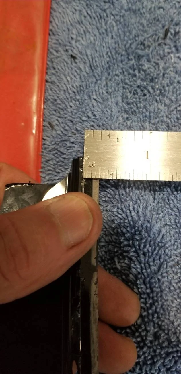

This is Not easy, the lip of olds lens is a 1/4 inch on main body.
At small end it's not as wide. There is more butal at small end, but this is where I would start trying to pry open at 1st..... see pic 1. Before 2 after 3 thickness. 4. Width of main lip.
It took like 4 or 5 times back in oven to get lens off all the way.

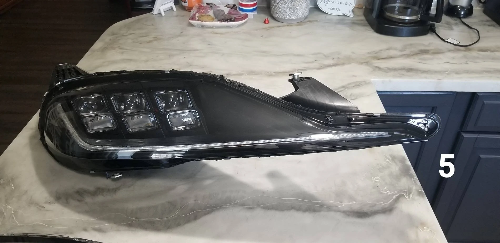

After getting lens off, put back in oven to make it easier to remove old gray butal.
I bought 3/8s black butal of Amazon. Gol the gap all the way since all will be gone.
5. Is finished product. Good luck!
