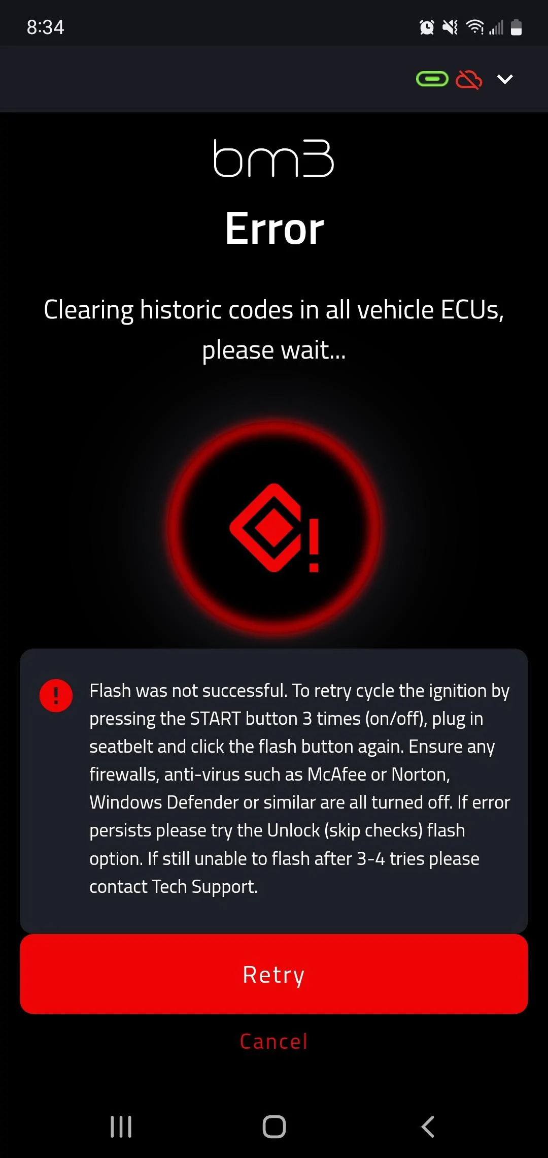

Flash to stock and lock. They're not 100% sure. Connectivity issue between phone and dongle probably caused it. I'll stick with wired from now on.

I used the USB Dongle and the Ethernet cable on my phone and that seemed to cause issues.
Will you try flashing the ECU to Stage 1/2 using a laptop now?

It most certainly has to go back to Femto. Protuningfreaks confirmed this, no charge, and Louaye really is the man.
When we flashed back to stock it was via obd2 ethernet + ethernet USB adapter and windows laptop. Connected fine flashed back to stock. Now I'm just chasing this EVAP CEL that popped up. Toyota supposedly repaired it. I thought it might have to do with the flash back changing the reprogramming that the dealer did or IF they did via ISTA. But bm3 said it wouldn't effect that. In my EVAP thread, zrk mentioned it shouldn't either. If there is no physical problem I'll delete the code once I have bm3 but still gonna have another shop look at the stuff that Toyota replaced.

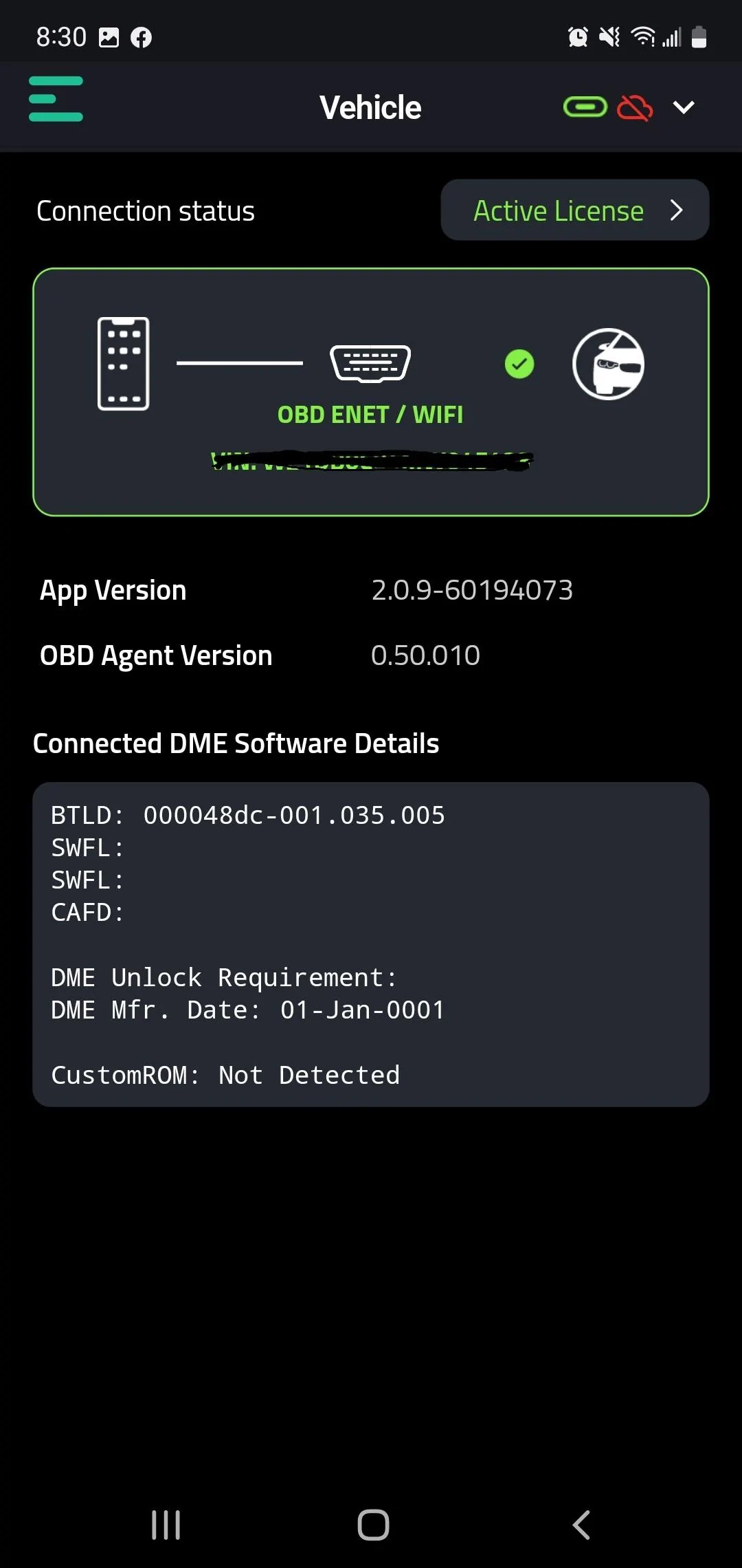

I had a connectivity issue that caused the flash to fail at 2% - this could have been an issue with the bm3 dongle, my phone, or some other sort of misc interference. The bm3 guys supported me 100% and verified that the unlock was performed properly by Femto, the method I used was correct, and everything for the customROM was registered properly from before.
I personally will go for a wired connection from now on as I always have in the past. I've used LT1 edit, HP Tuners, COBB, Hondata, all wired, no issues. There are tons of videos of BMW guys doing everything with their phone and wifi dongle and everything went smooth. I had to be that 1 guy that bricked the dme and shat bricks for 2 days until we figured it out.

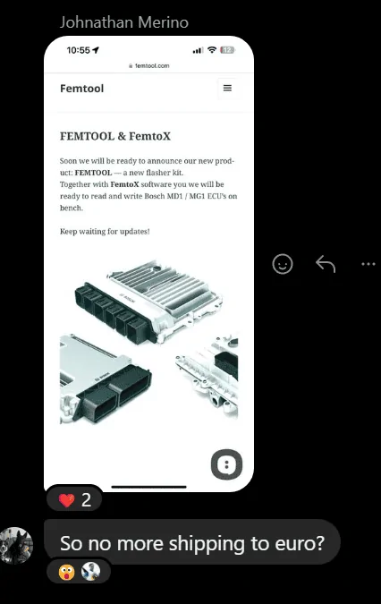

Also someone posted this in on the IG group message boards I'm in, someone mentioned bench unlock coming soon w/o shipping to Femto, has anyone heard of this?
I'm not sure if it's for post 6/20 ecu/dme. The post doesn't specify. Maybe similar to what MHD came out with for an @Home unlock tool? But it's for pre 6/20.
81
8,473
14,122
This is just BFlash in a smaller box.
