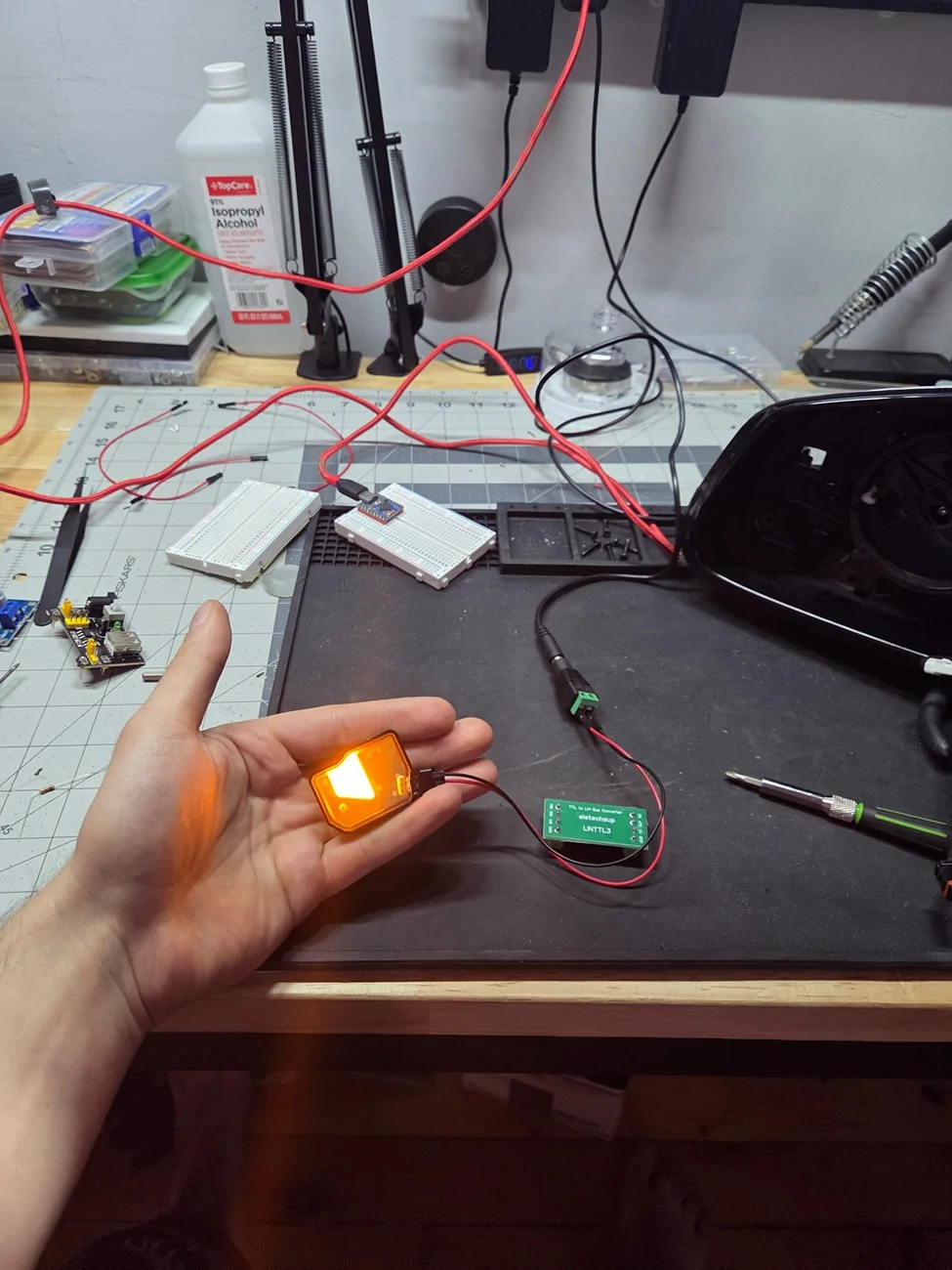

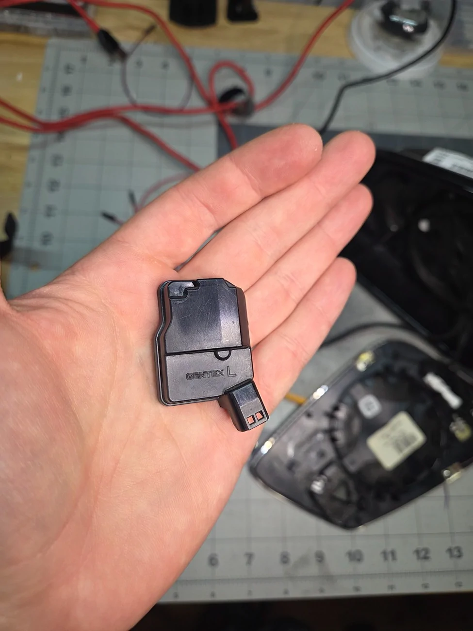

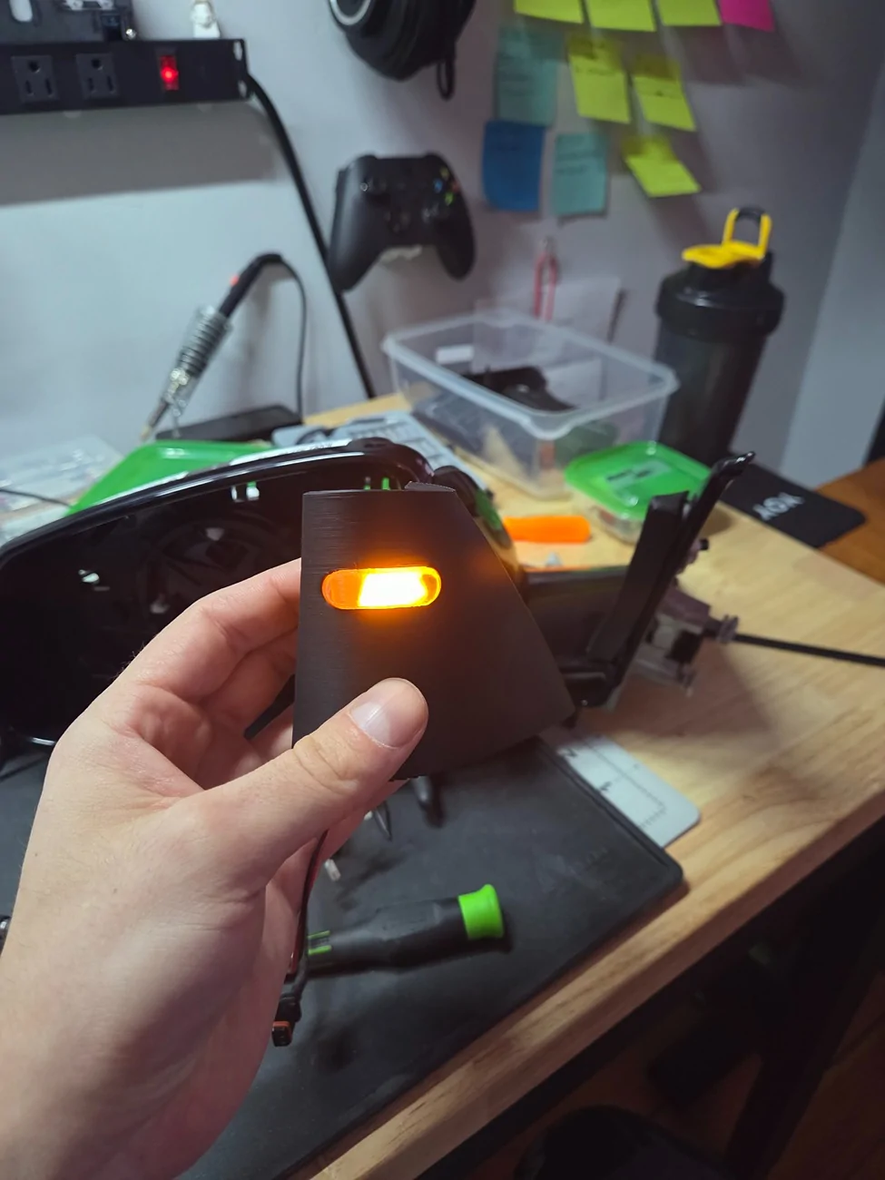

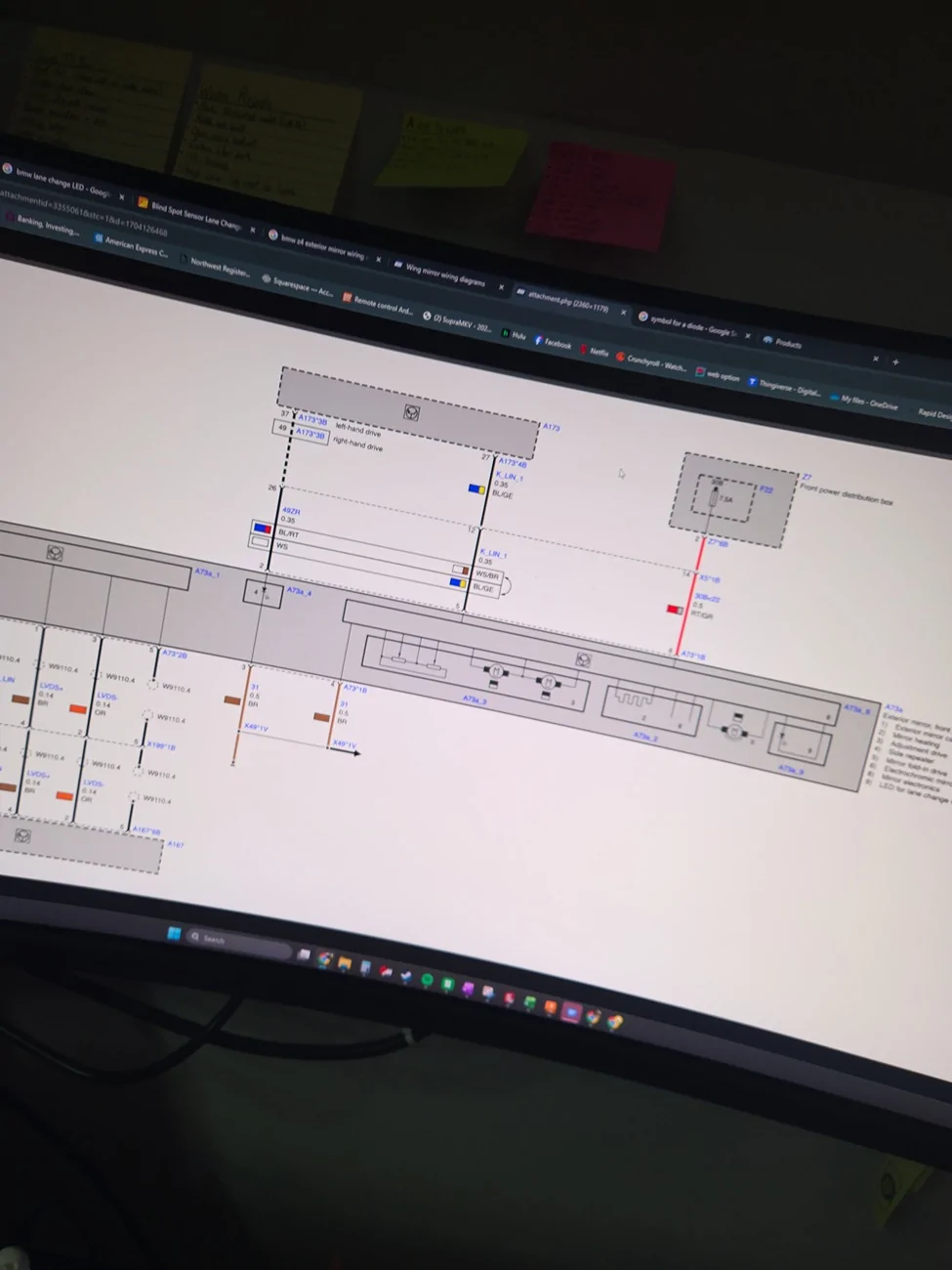

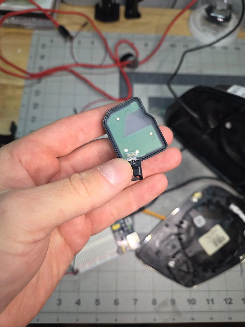

Hi there! Its funny you started this thread as im sort of doing something similar.
Instead of a full retrofit im creating a kit to bring the BSM LEDs into the interior (specifically the black plastic trim piece that is at the corner of the window and dash) for those who want to run aftermarket mirrors.
Im still early in the process but ive been making some headway. Unfortunately the LED module itself is not a simple PWR/GND unit, it is definitely LIN-based. Its also a slave to the "mirror electronics" module inside the mirror. Ill be tapping the bus to translate rhe LIN messages somewhat soon.
All this to say, more than likely it is doable but it will be a pain in the ass for sure. And you'll probably (?) Need the rear radar sensors calibrated, which may or may not pose a problem at the dealer considering the car didnt come with the package from the factory. You may have better luck with an independent shop however.
