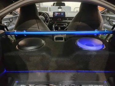

Maybe this thread may be able to assist me with another audio appearance issue.
I want to replace the sub grilles with something that pops a little more. The OEM grills pop right off with the pry tool, but unless I want to screw the new grilles into the sub enclosure cover, there are no existing holes. I'd prefer to use the existing holes / placement, so I am going to return. Considering spray painting the grill covers.
Anyone know of grill covers that use the existing setup? Thanks in advance!
