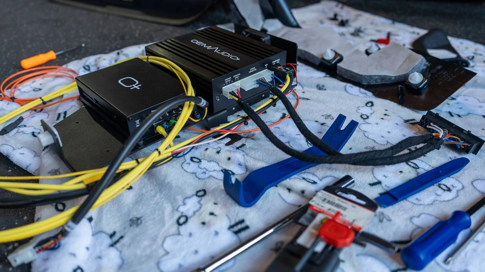

Desperation. Lol I am trying to get the photo without taking my car apart again. I installed am Mobridge amp and we are having trouble getting all the speakers to work. So we need to customize the harness to get it right. So if I can find out what pins and what wires go to what speakers I can save time and one less time I need to take apart the hatch.

Glad to hear that they are increasing the mids with the unused speaker. The system oem+ system uses a Mobridge most25 signal processor followed by a match 7 channel amp and a cheap small mono amp. On my harness it appeared that many of the speakers don’t work because the connection isn’t connected, relying on the tuning to make the front speakers do most the work. I am curious how they get 7+ channels? Do they replace the harness or is it all done with tuning?

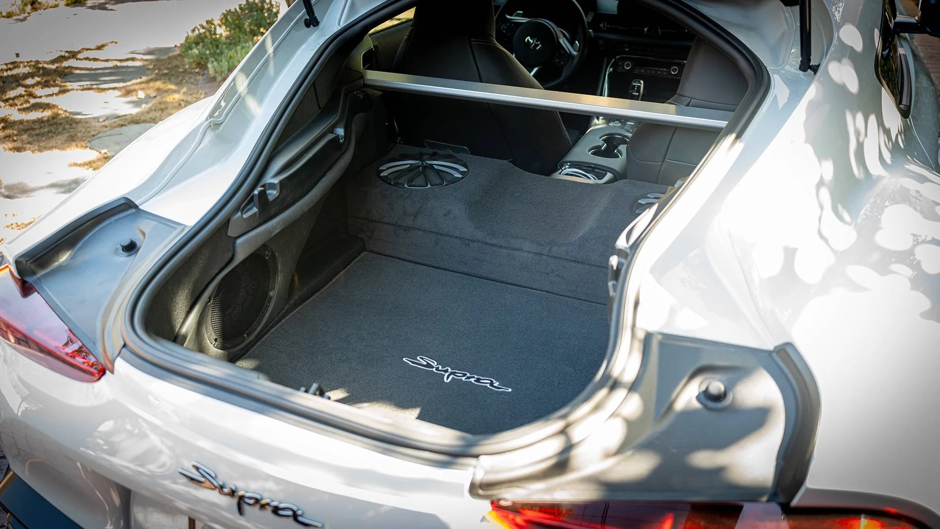

I recently installed the latest OEM Audio+ system and I'm happy with it. That's the tl;dr. Now the long one.

Anyway, before committing to punching holes and stuffing woofers, I removed the woofer panel and tweaked the EQ to simulate the Full Tadda mod. Basically, "Tadda on the Cheap". And TotC was a very good improvement, which made me want more. But given my audio system was still stock, I felt I had an opportunity to comparison test an aftermarket system.

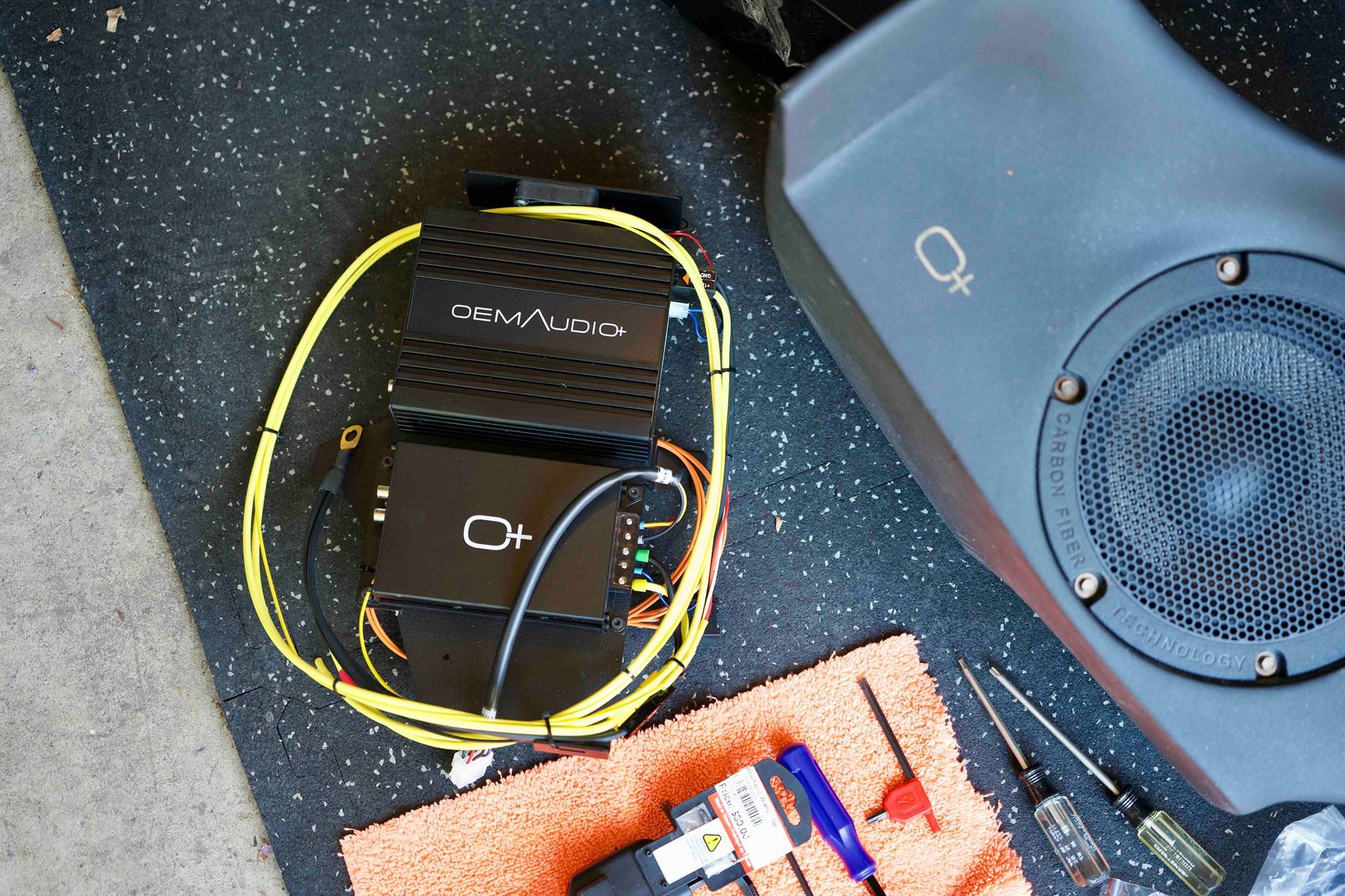

So I committed and purchased the latest OEM Audio+ Kit.
The parts arrived with some missing cables, which actually ended up being a super cool experience. OEM Audio+'s support is EXCELLENT. When I called for follow up questions, I got to chat with Sandy (owner) who shared a ton of info and some history with me.

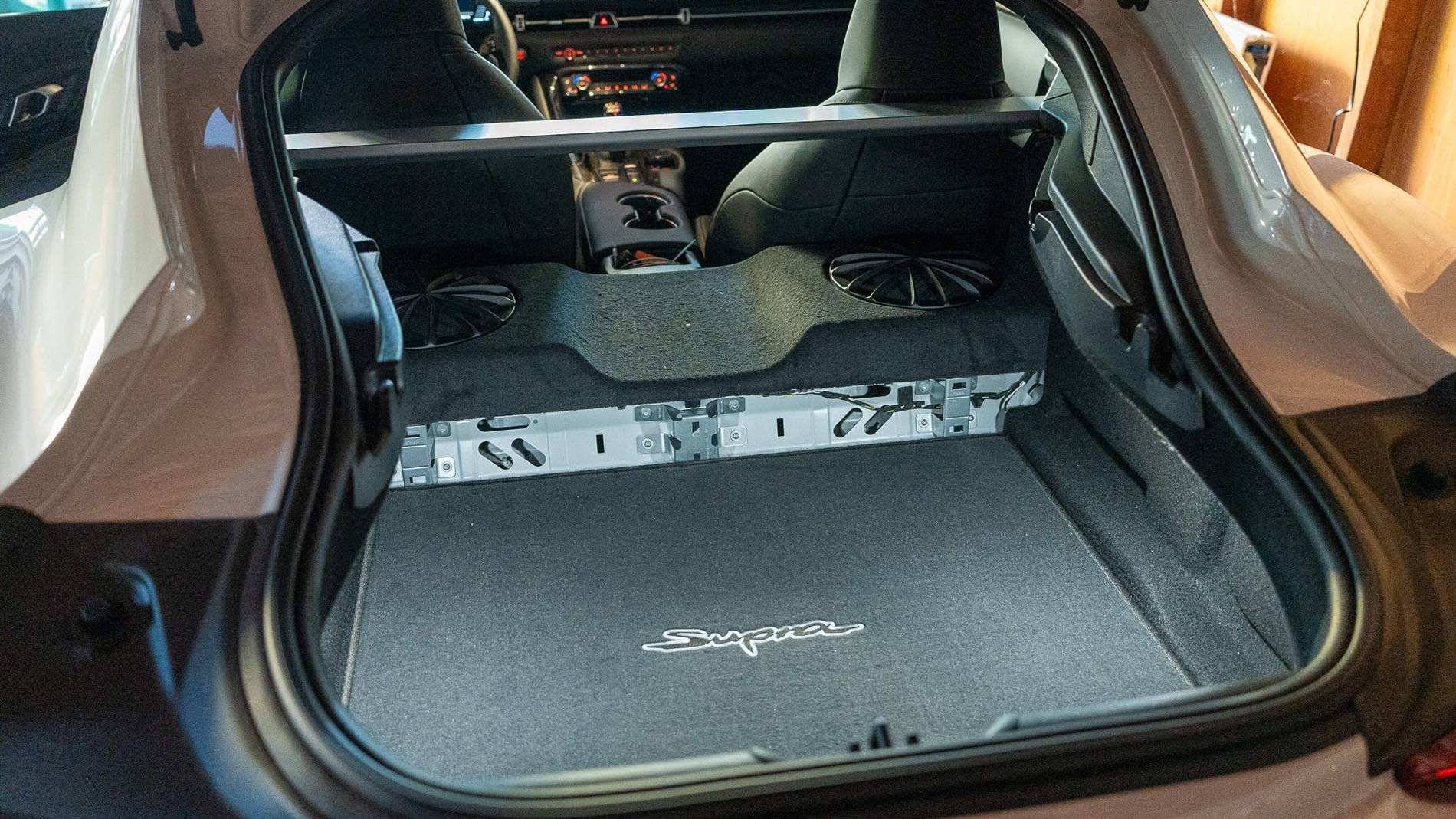

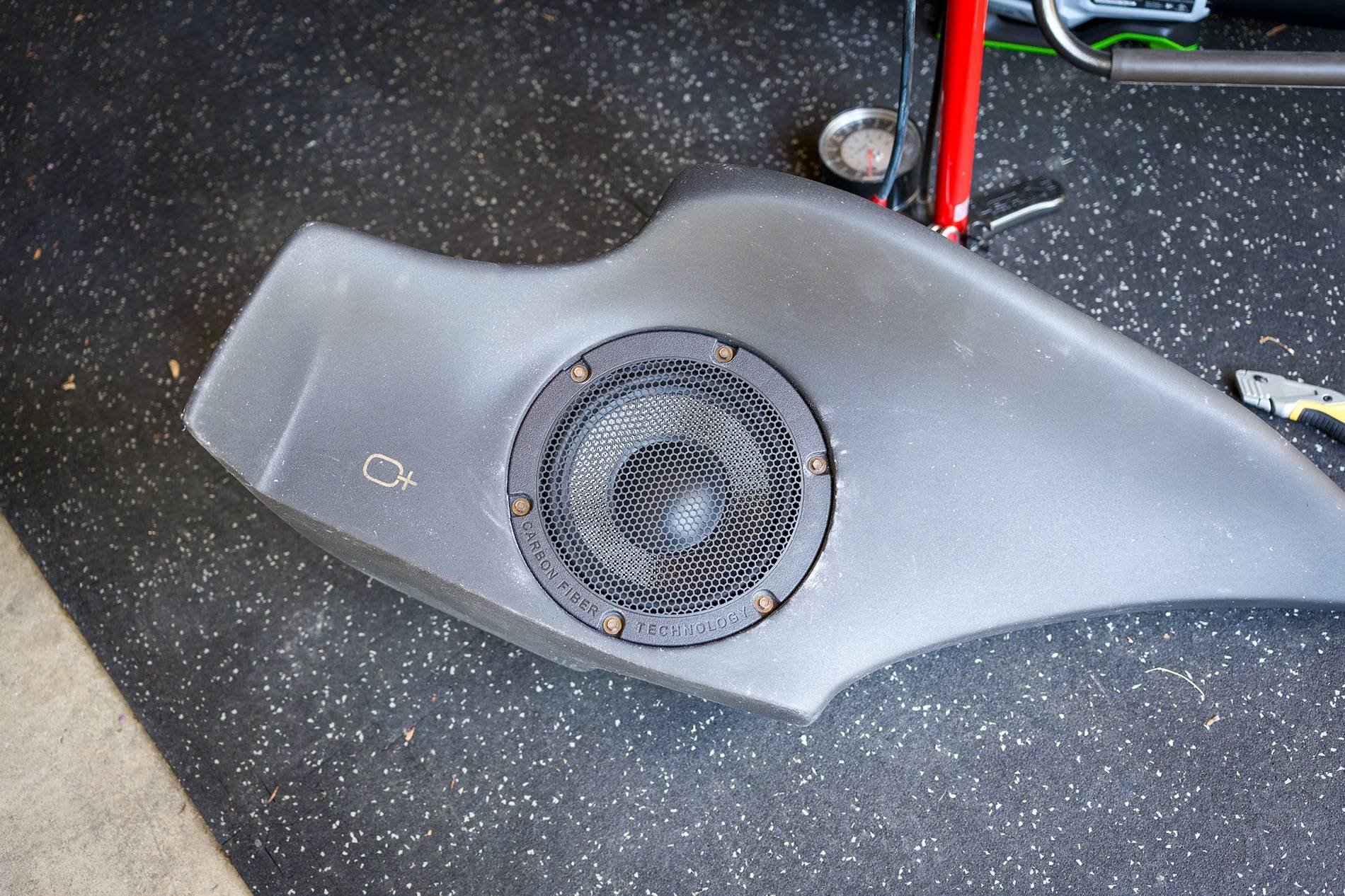

Third, the current generation OEM Audio+ kit repurposes the 8" subs to Mid Base (60~90Hz) to bridge the smaller speakers. Reasoning is exactly as stated by previous posters. Many folks have e-mailed OA+ to take in Tadda's feedback. OEM Audio+ received, listened, and responded to the community. And here we are in 2024, going into 2025!

OEM Audio+ (Config 4) absolutely sounds better than Stock Amp (Config 1). I also spent multiple back-to-back midnight Canyon Runs comparing (Config 2) vs (Config 5). Config 5 sounds and feels much better than Config 2.
Config 5 also sounds noticeably better than Config 4. Removing that sub panel is a big help. Intuitively, this makes sense. Given that the 8" subs have been reassigned and back alive, the speakers need to open up so they're not suffocating for air. The physics has not changed. Basically, OEM Audio+ with TotC sounds best so far.
