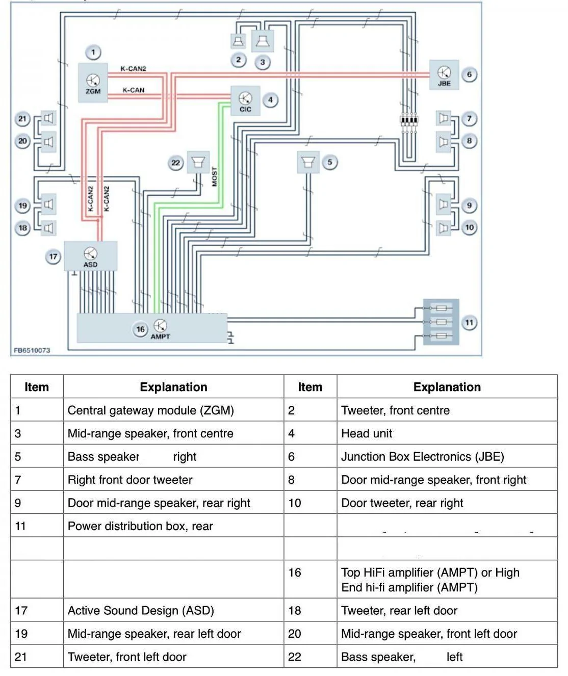

Im starting from scratch and building new doors to hold 6.5
I took the Factory amp all the way out and used the Fiber Optic output into a Audison Bit DMI. That Audison is programmed for the car and takes the unprocessed signal and then i am feeding that in the Audison Bit Virtuoso for processing. For now Im only running doors 6.5 and a tweet all active crossovers and one 12inch sub in hatch. I have one of the Best shops in St Louis doing most of this work, JML Audio. I and making a Video Series for my Youtube if you want to follow along.

Hi Jason,
I watched your build on your youtube. I am amazed cant wait to see the project unfold. Please can you advice the Audison Bit DMI does the connector from the OEM premium amplifier just plug directly into the Audison DMI unit? So I can simply remove this amp and place a Audison DMI and from there into a DSP/amplifier that takes a Fibre optic input?
Also anyone know what male socket can mate with the female speaker connectors so I dont have to cut into the wiring loom?

The following wiring loom carries all the speaker wires. (See area marked with red circle)
I have to test the polarity of each to identify which colors are positive & Neg.
Would you mind sharing your speaker wire results?

@tadda, do we know the factory amp size or the overall area in there to possibly fit an aftermarket amp?

Has anyone been successful installing a signal processor for the mid/high speakers? I believe the budget route would be to install a signal processor for the mid/high speakers and adding polyfil or foam to the subwoofer enclosure. Iā€™ if there was a s signal processor that could plug into the factory amp as intercept that would be great.
Yes, you install a LOC post amp which sends signal to your processor.
Adding any processor will require an amp to re-power the speakers you proccess. At this point the oemaudio+ system is a better option unless you wanted to do the tuning yourself.

anyone have a photo of the harness that plugs into the amp on the JBL system? I need to know what pins go to what speaker.

Sorry to revive this, just wondering if anyone has made a more detailed diagram. with pinouts and wire colour coding and polarity? Purchased a bavsound Amp and am trying to get it to work.
