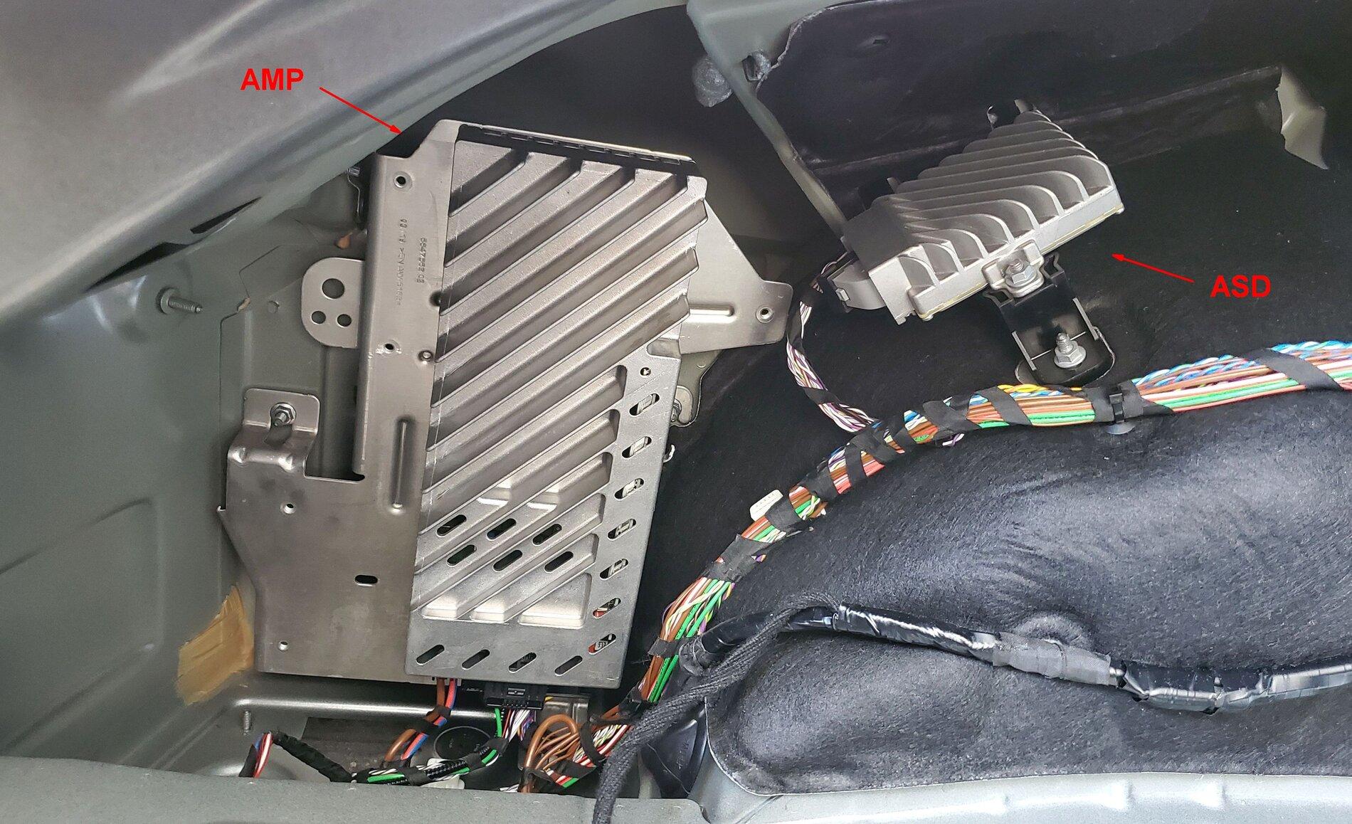

Supra Audio Amp, ASD Amp, and System Diagram
I recently had the panels off in the cargo area and also did some further investigation into the OE audio system wiring and component layout ...Here is what I have gathered so far which might or might not be helpful...I don't have pin designations yet but our system and components are identical to that of BMW's...
OE Audio Amp and ASD Amp location:
Harman Audio Amp and Active Sound Design Amp Location and Mounts:
Audio Amplifier Connections:
Harman Audio Amp p/n 2622901:
ASD Amp Connection:
Supra Audio System Diagram:
Active Sound Design Description:

☝This could not have been more timely. I had my car at the shop today and they are putting an amp and sub in and was able to send them this, as they’ve not worked on a Supra yet. Thanks for posting this!

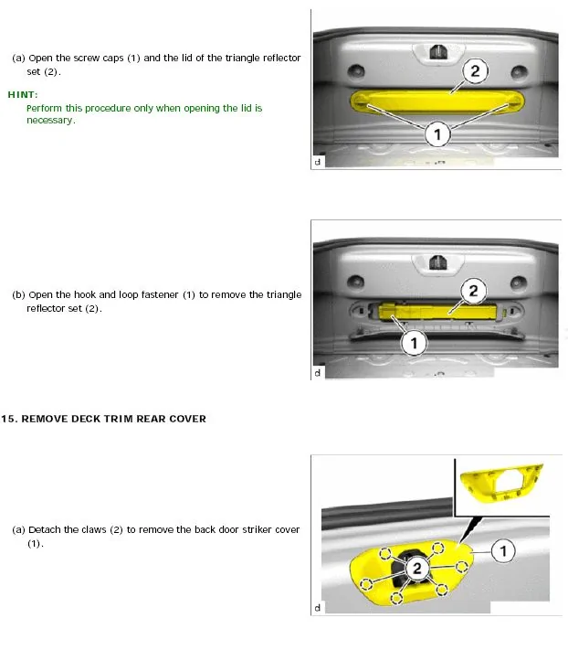

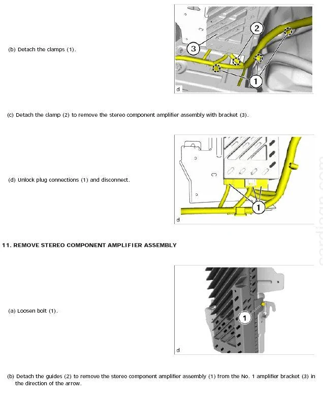

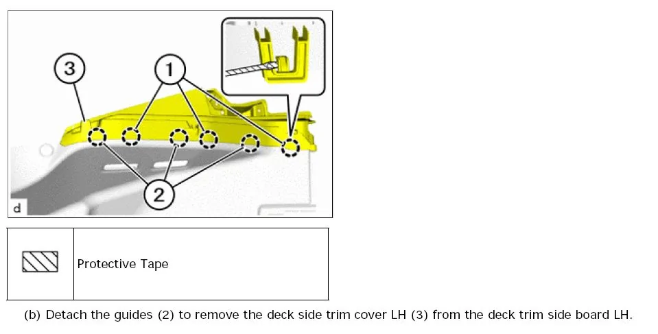

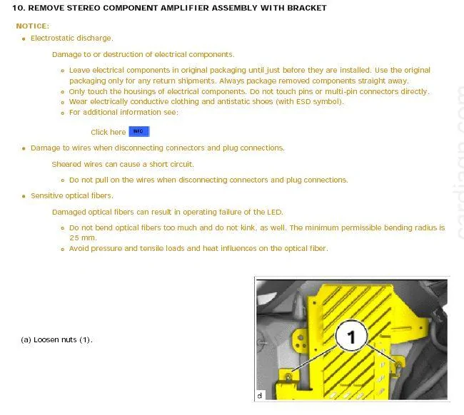

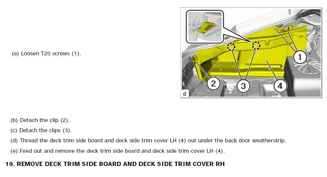

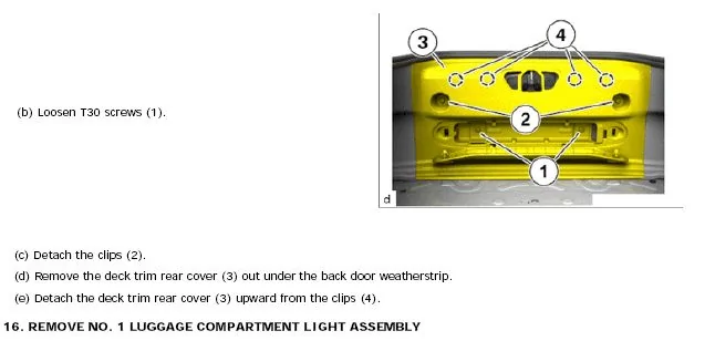

Here is shop manual instructions on how to get to the amp....It's fairly easy with only 2 panels to remove...

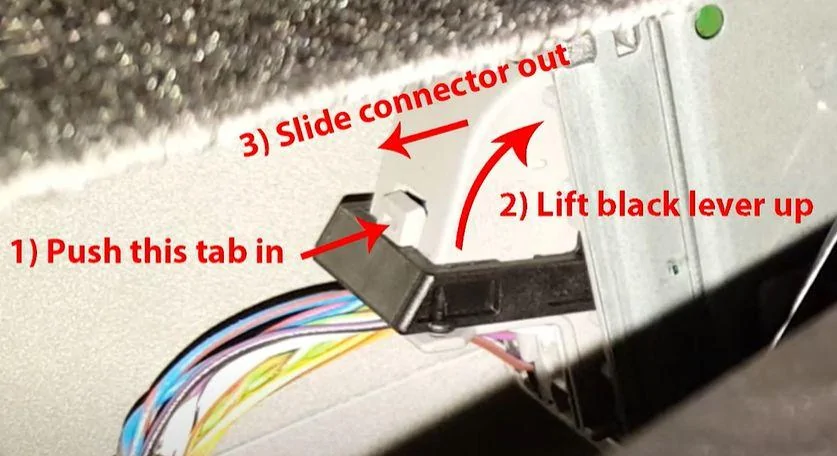

And while you have those 2 rear hatch panels removed to get to the Amp I would also eliminate the ASD (Active Sound Design Generator / i.e. faux engine noise) from the sound system by simply unplugging it...I got the chance to unplug the ASD module from the Amp today...No codes were thrown and does not affect sound quality in anyway...
You can also disable the ASD module using Bimmercode...
