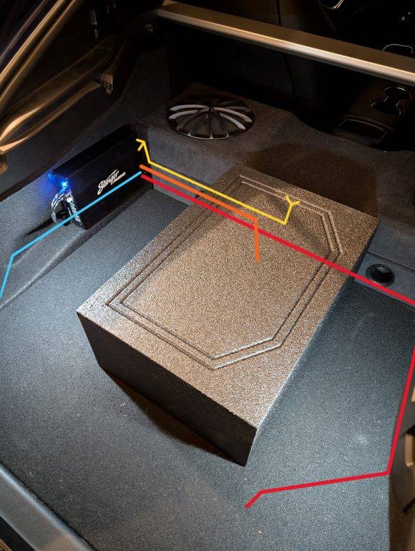

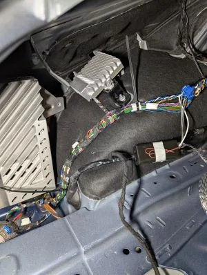

Following up, I got my DME back and in the car last night and have since spent hours driving around playing with MHD and listening to music.
Femto unlock totally worth. Even the OTS maps are good. I'm running the stage 2 91oct map and it is a huge difference.
As for the sub/amp, I'm happy. I do see what yall mean about not feeling like it's getting the whole lower range, but I just wanted a little more "boom" and that's what I got for a relatively good price. My only real complaint is so many vibrations and rattles in the trunk. Hopefully some dynamat type material will fix that.
If you feel like you are missing some frequencies, you cloud try and connect one of your channels to a rear speaker.
Then you should have the full range covered.

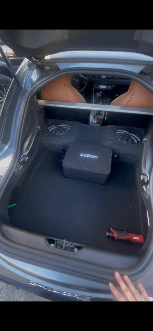

Thanks to your write up I was inspired to do mine!
Didn’t want to add much weight, and it’s an open cabin so an 8in Audison was plenty. Got this used off eBay, $300, and about $50 for the install materials (seller poorly shipped it and some connectors work broken…) It fills in exactly what the stock system was missing without doing too much.

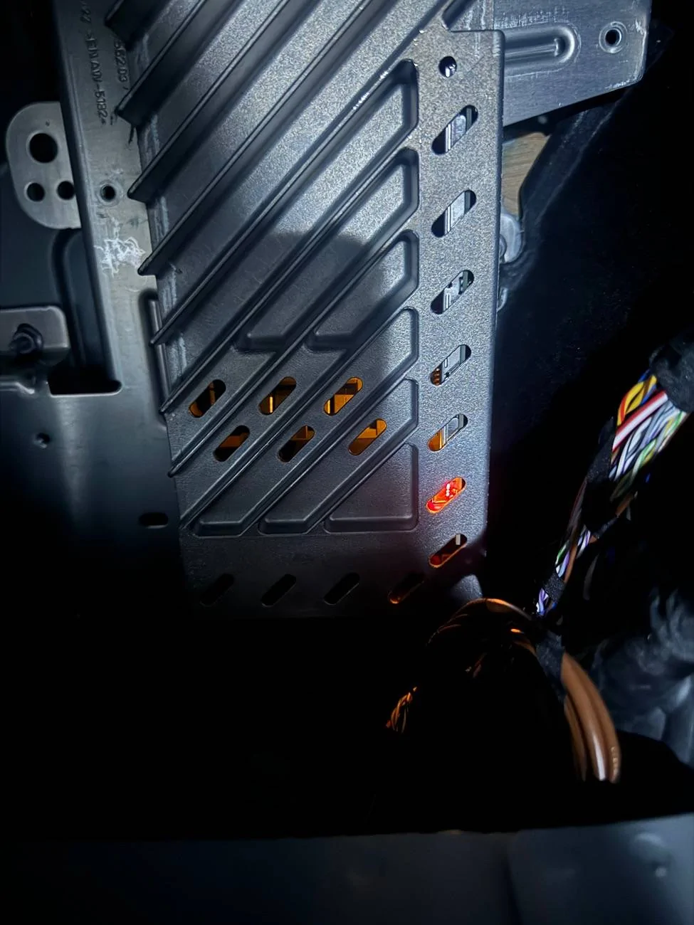

What’s up guys , finally got around to adding a aftermarket amp and sub and when I got to the tapping into the existing subwoofers wire I must’ve sent the OEM amp into protection mode and now no music or audio is playing but I can see my car play and everything, Amp has a red light don’t know if that means anything. Any help would be greatly appreciated. Thank you in advance!!
Jordan
