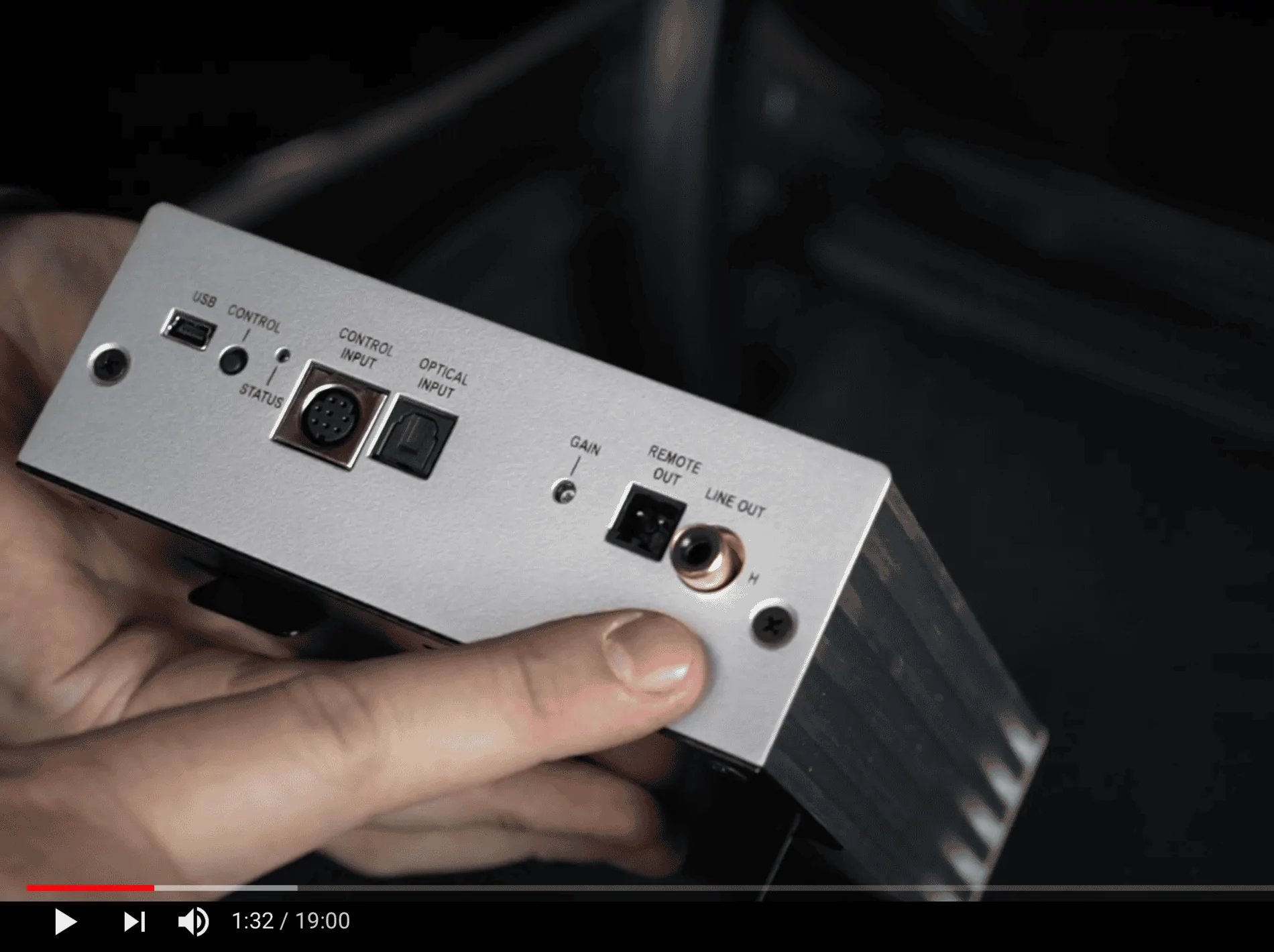

Being interested in the BavSound Revenant amp as well, I have been trying to gather some hard specs for the amp from other platforms, but with no luck. Seems Bavsound doesn't like talking about specs but words on "how great it is."
Watching some videos, hoping there will be some details given out, I came across this.
It was mentioned in the video that you can use the remote out and the line out for an aftermakert amp and sub.
Thought it was worth brining up.

Thats a good find. Didn’t realize they would have a line out on it. I will definitely rewire away from my 8” splices and go to that if/when it comes out. I was excited when I heard they released a new version of the revenant amp the other day but was dismayed to learn it’s just for the BMW side. Hopeful that they load it with the Supra spec sooner rather than later.

Just got off the phone with Justin with BavSound. He had no info regarding specs or if and when they'll have an amp for us. Though he did confirm that their amps do have a useable remote out and single rca line out.
The signal is processed through their DSP with a 80hz crossover built in. The single rca line out has the L/R combined, you would just use a splitter when connecting an amp.
I did forget to ask if the gain knob pertained to the line out. I know in the video it was mentioned to never touch it.

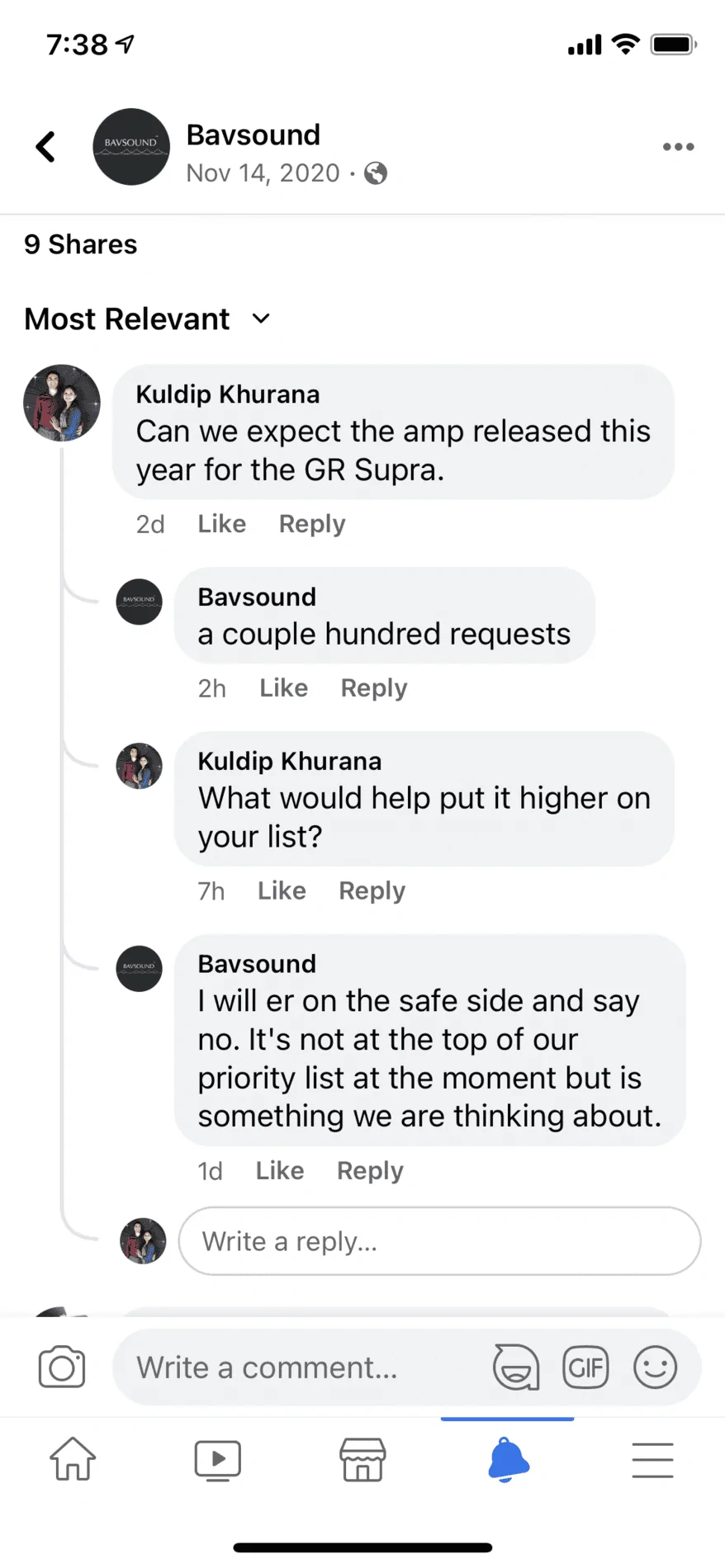

Yeah they have yet to "get their hands on one" I was told. They have other platforms with higher demand atm. So really everyone that wants one should just start blowing up their feeds with demand.

So Bavsound pretty much said tough luck, not this year. OEM+ states a March release date so I may just go that route.
