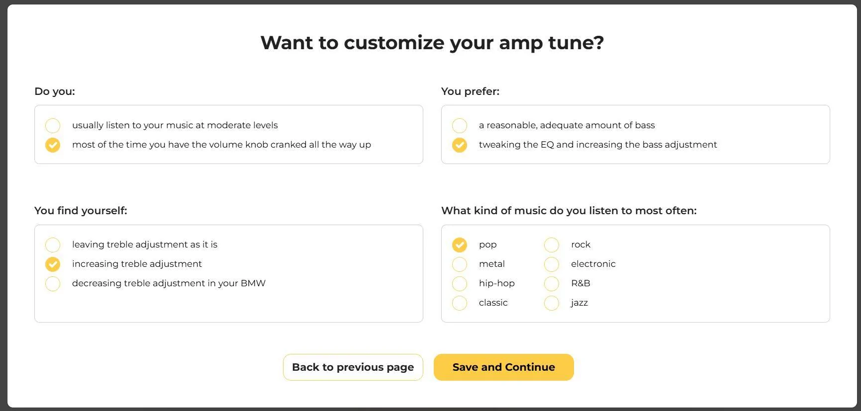

That's awesome!
Stock speakers good enough?
Oh, yes! They sound much better.
But I did eventually upgrade them since I went with the greater bass file.
