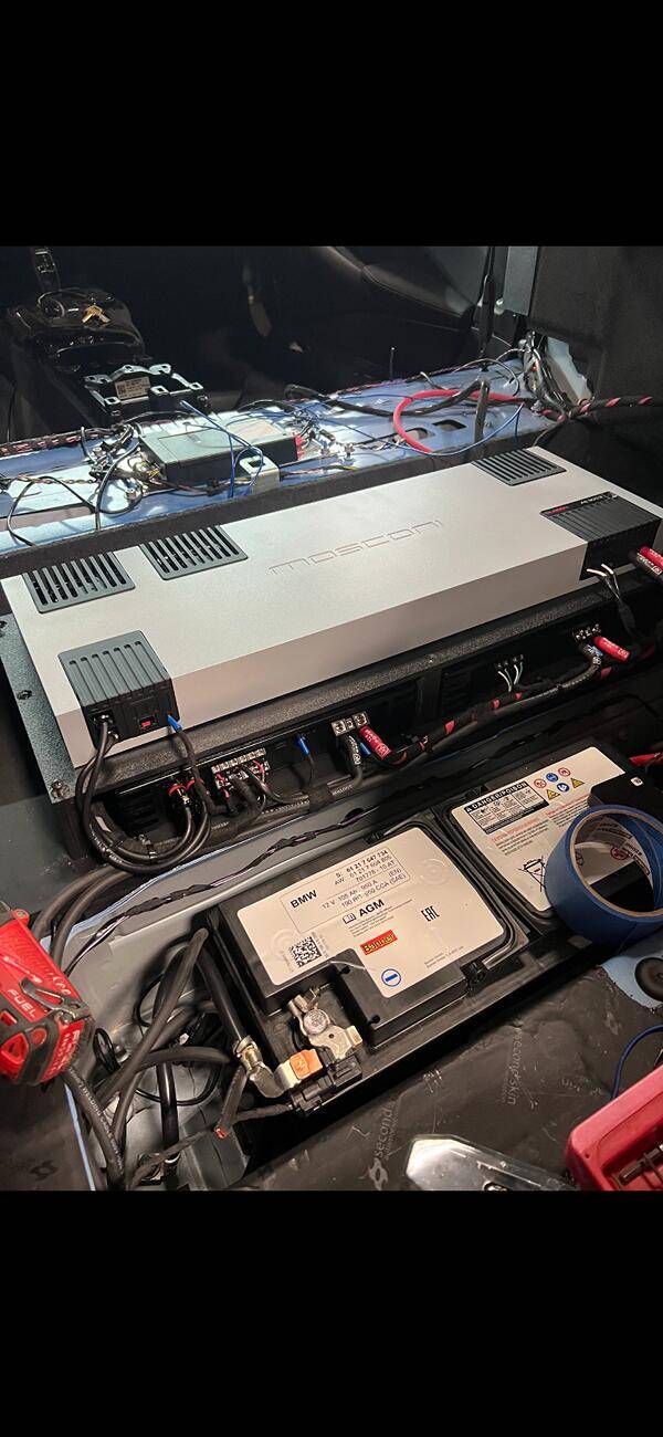

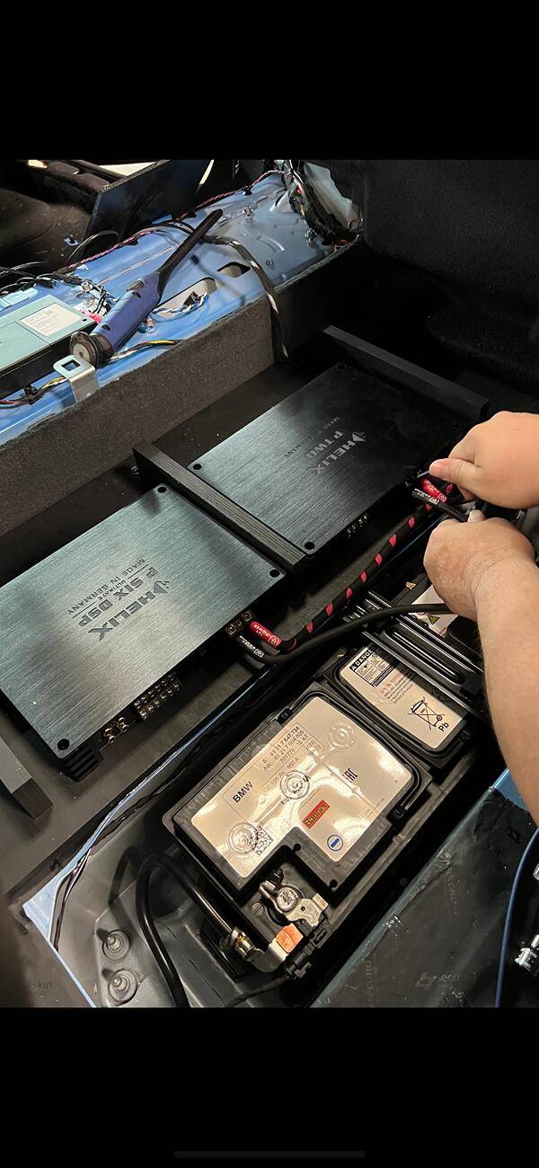

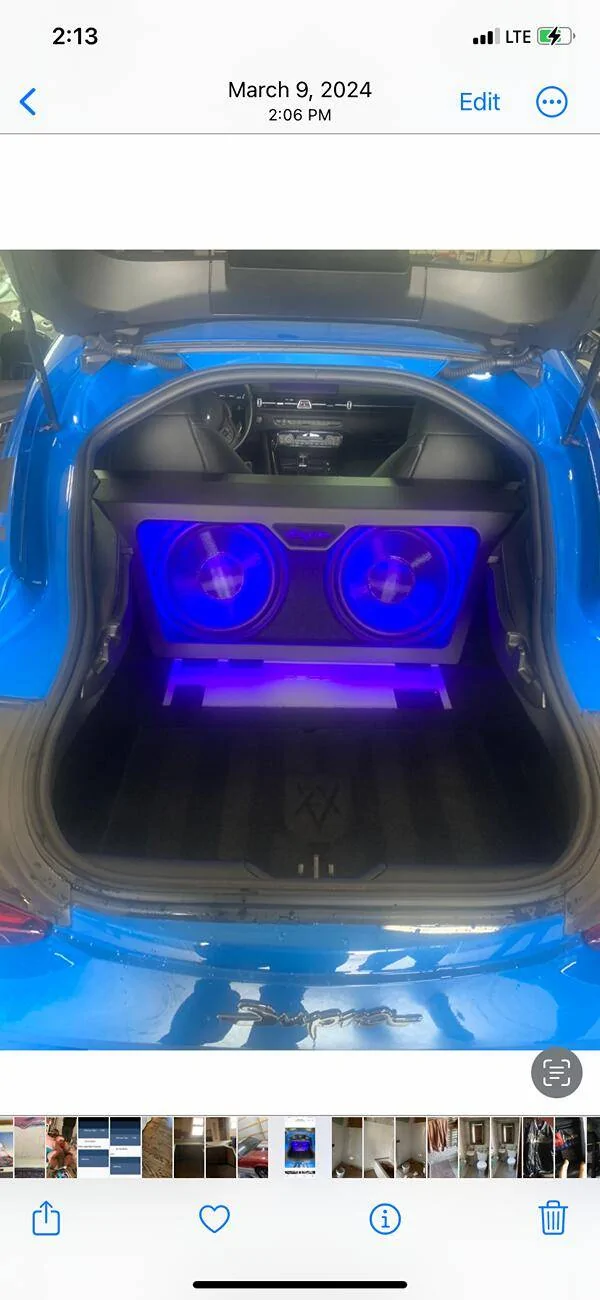

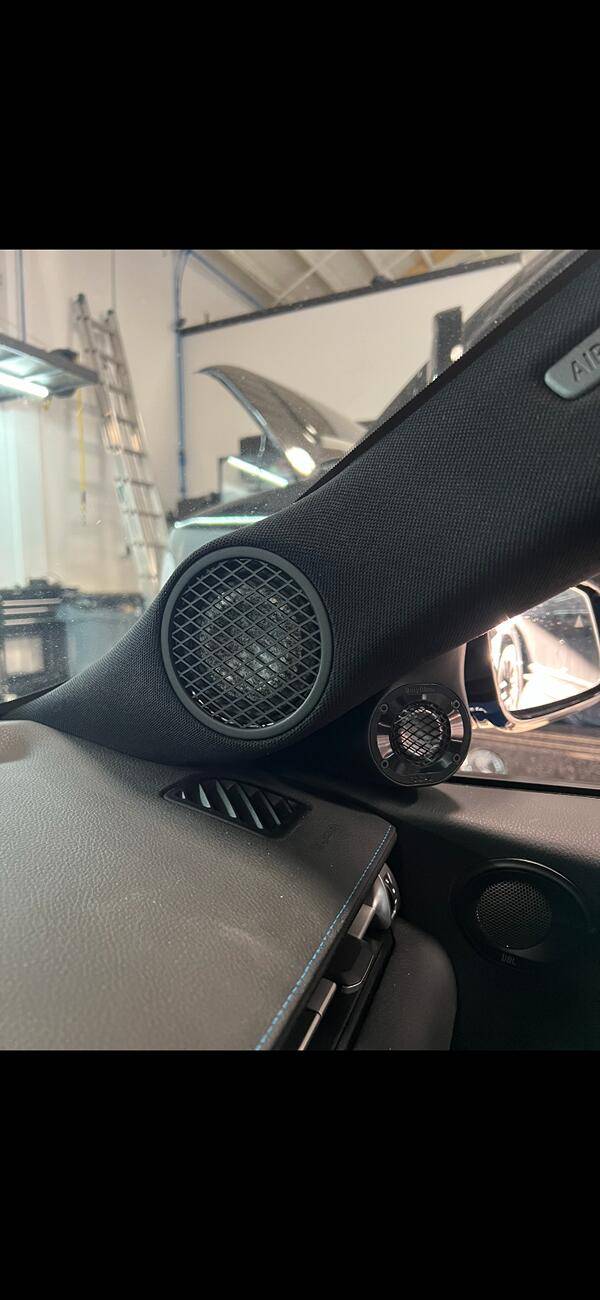

I’m not showing pics to be arrogant. I went down the exact road you all are. I added a sub. Then wanted more. Then I did a full setup. Then did an extreme full setup and changed every speaker location. 6.5” in the doors and all.
What I’m trying to save you all from is. The base audio in these cars is so poor. It’s not worth building off of. Get a helix sdmi and start over from scratch if you want good quality SQ. The Supra is actually a good platform for audio.
