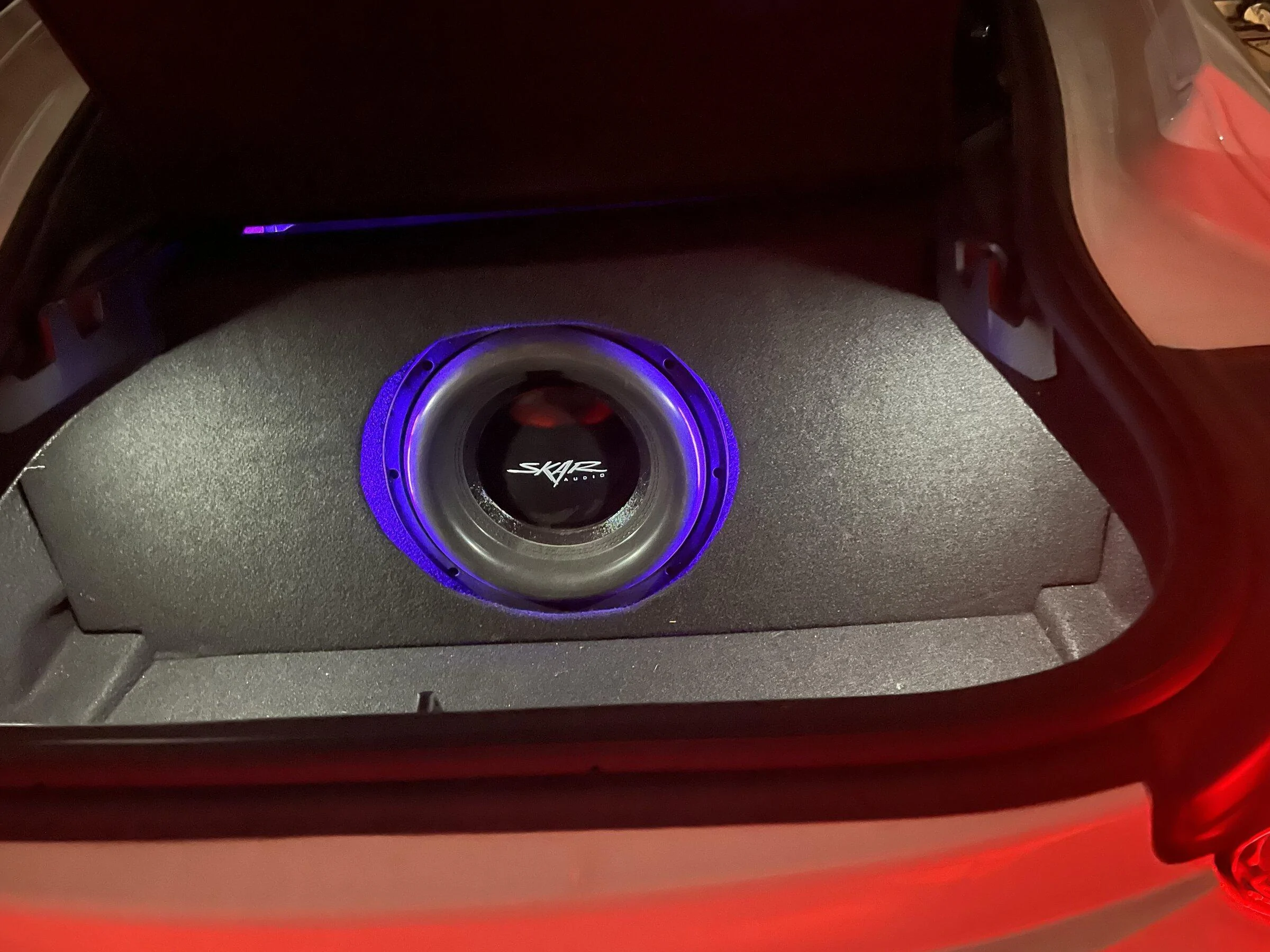

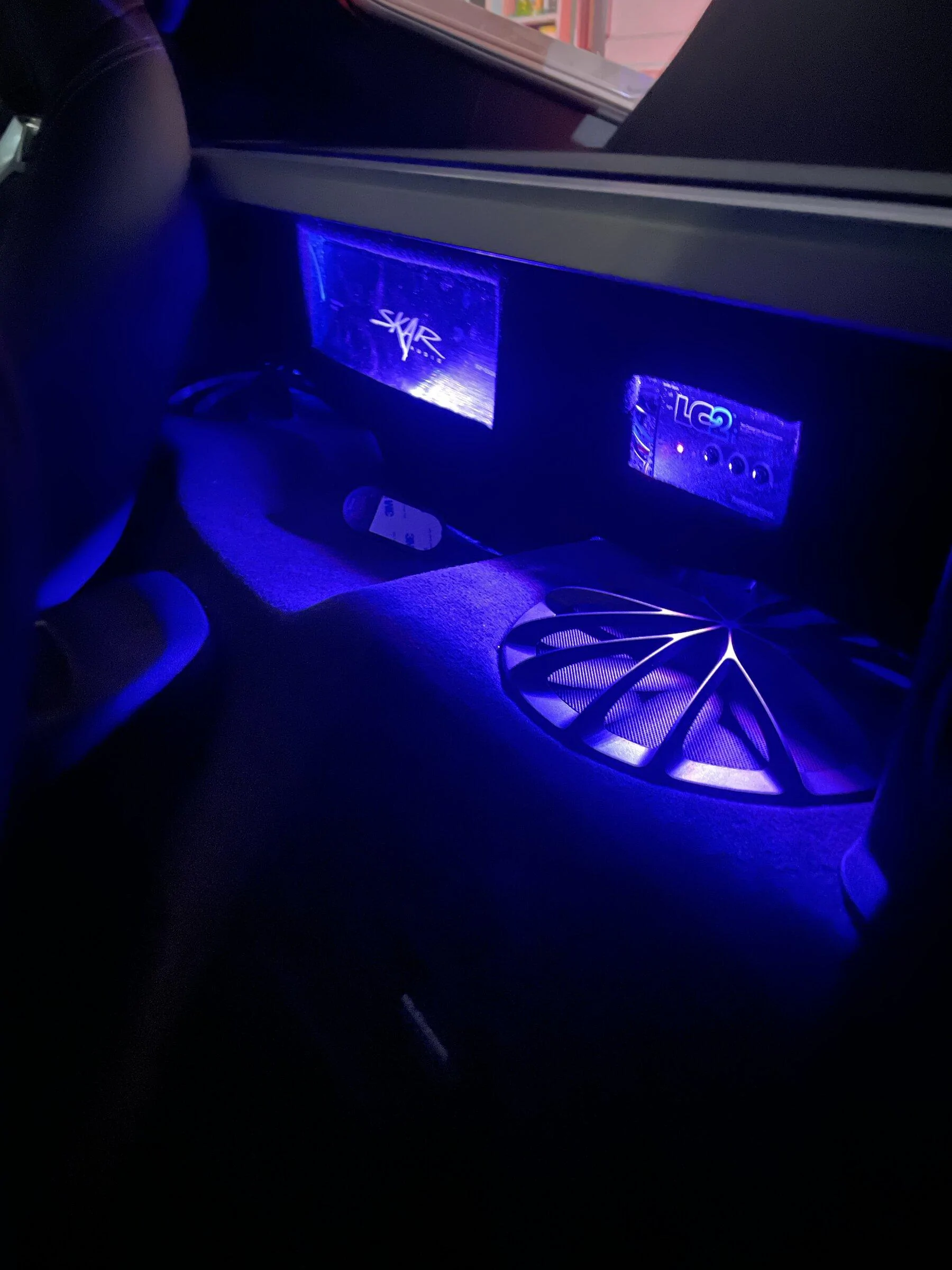

You'll need quite a bit of stuff depending on your goals. I have an 8 speakers setup with two amps a dsp and MOST25 adapter with custom door panels and custom sub enclosure. I spent $13k with install.
If you're just trying to get more bass, you should follow what others have done in this thread by using your LC2i but don't touch the factory amp or oem enclosure/speakers. Have a custom enclosure built on the side cubby area like @Sam B did or use your trunk space.

If you are set on replacing the oem subs/enslosure add back a couple smaller subs in that enclosure to play the higher frequencies that you don't want the subs to play.
Here is a similar build for reference.
If you can do that you are good to go.
