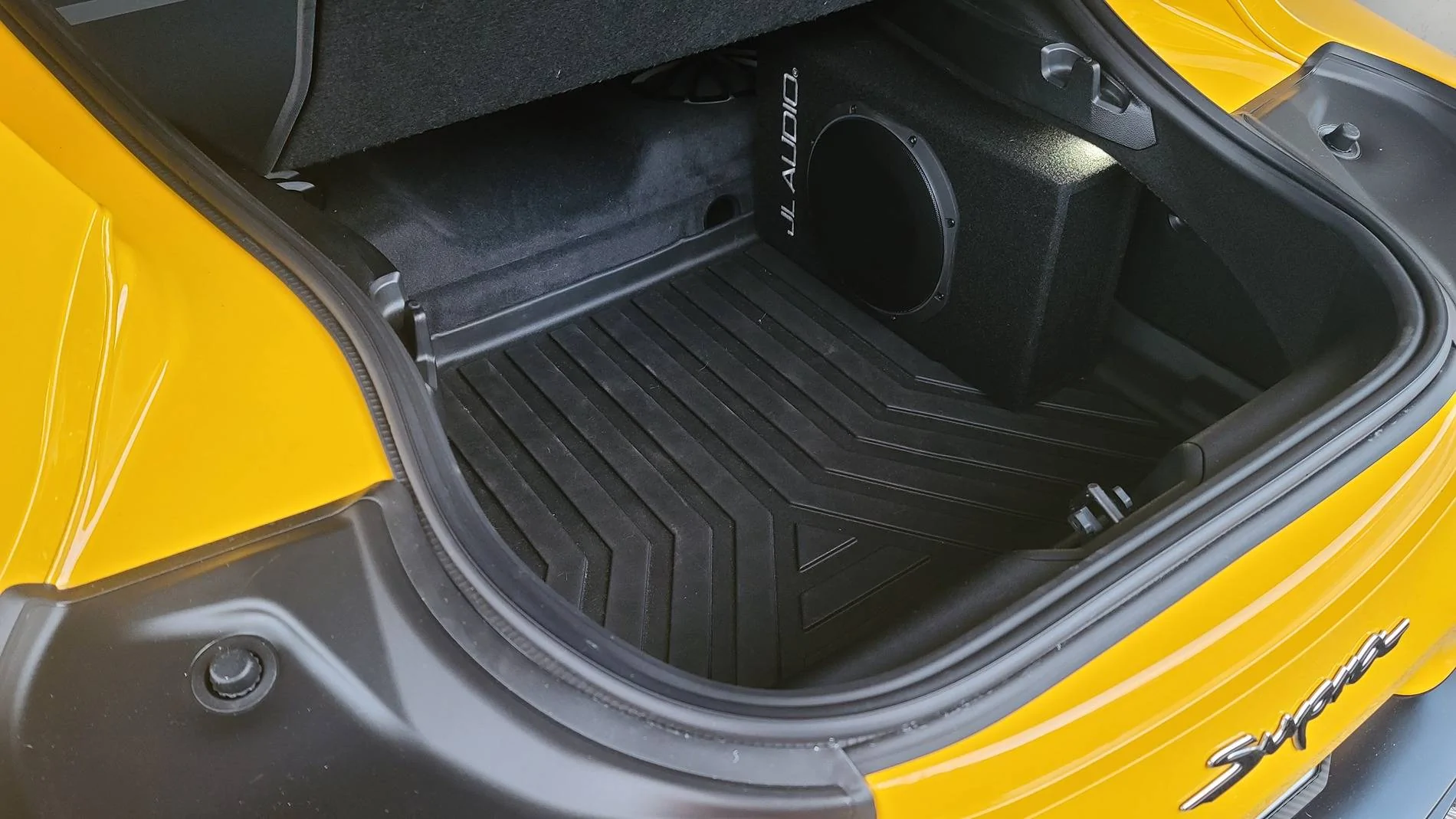

I thought I'd contribute a pic of my install. Not the prettiest, but it is removable and I do retain most of my storage space. I can still carry a set of golf clubs in the back. IMHO the mod adding the ports are fine for most types of music, but occasionally, I want to listen to booming bass and that's when the stock subs fall short even with the mod. That's when you do need another amp and sub. I'm a little partial to JLs, they've been my goto subs for the last 30 years. The bass is now is more than enough for me, especially in a small cabin and is still clean sounding.
Do you have the link to purchase the sub and amp? How hard was the install?
does the amp come with its own adjustable Bass knob?
