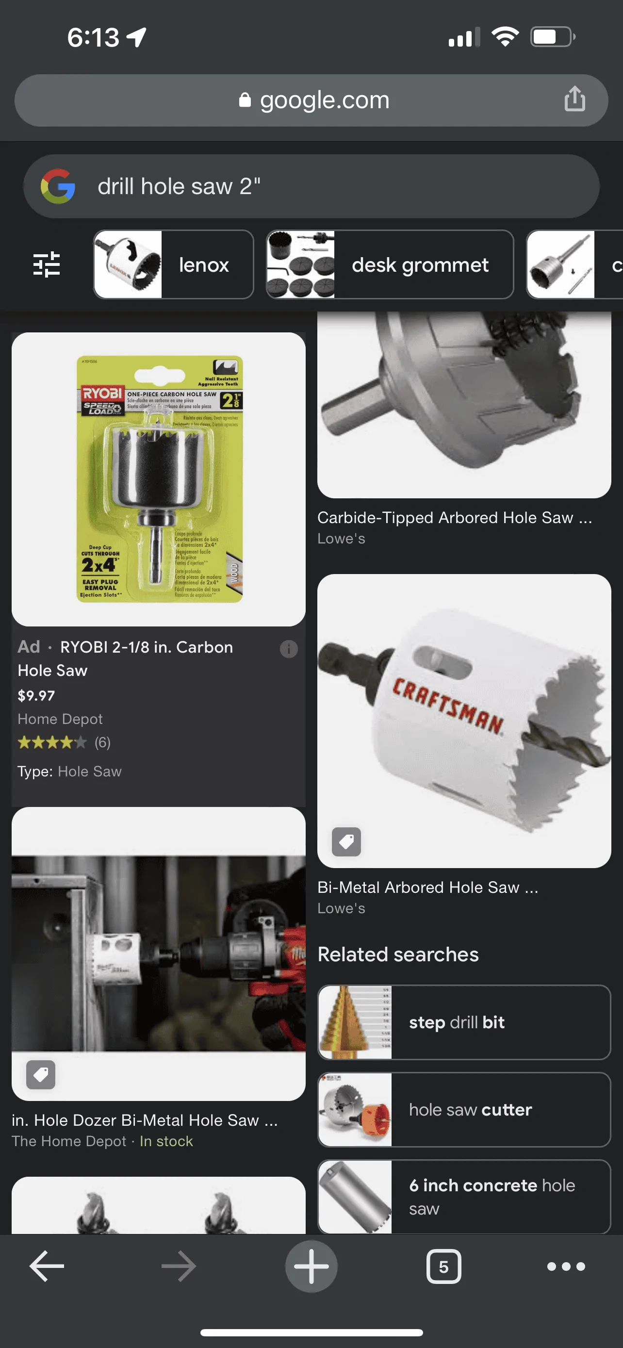

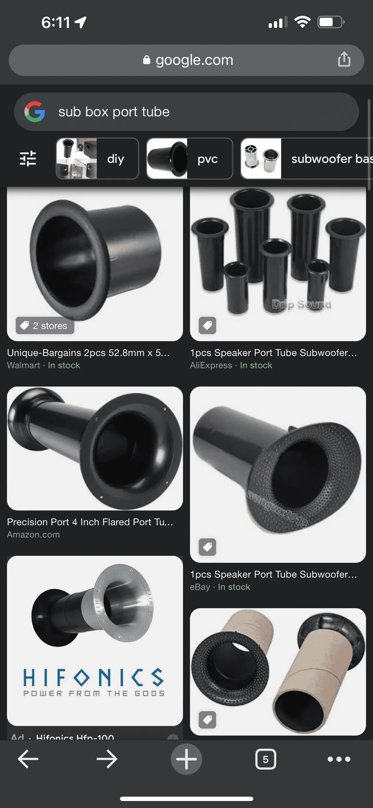

I am interested in adding the port holes. Can someone explain why just using a 2” drill hole saw and a subwoofer port hole you can’t just punch 2 holes in? Instead of tearing up the whole interior?
This is my plan eventually. I actually just removed the whole trim piece for now and the bass is much less farty.
