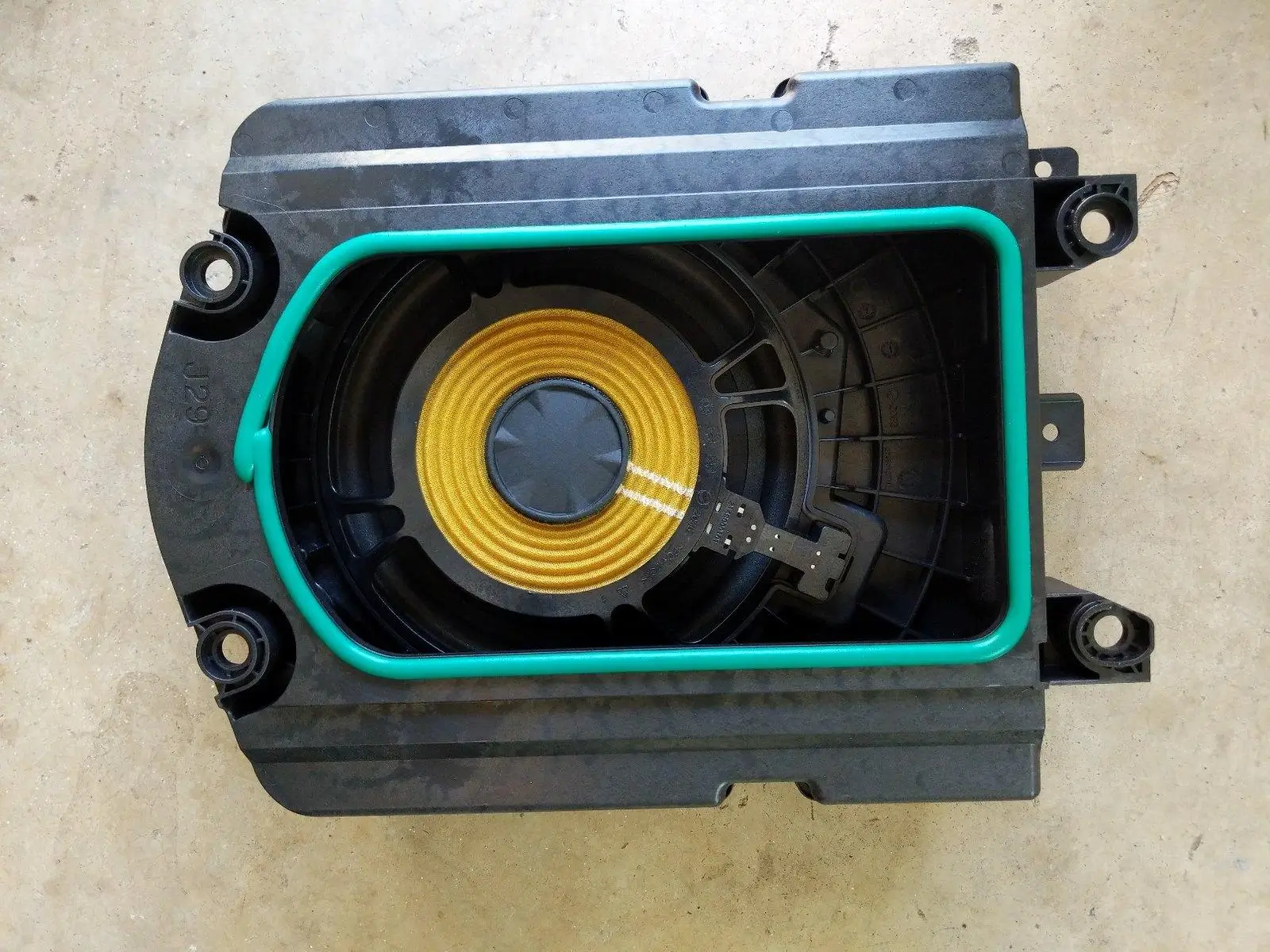

So after reading the majority of this thread, as well as watching a couple videos of people doing these modifications, I came across a comment that said the subwoofer are in a sealed plastic enclosure. Which then means as he noted, that adding ports does absolutely nothing to change the bass response. I could see the foam eliminating some vibrations, but that has to be minimal at best I would think. Has anyone put their hand at the ports and felt air movement when at a high enough volume to expect to feel something?
Yes, there is air coming out of the ports.
mack73
Nov 17, 2025
67
100
'26 Final Edition
The plastic enclosure has a giant hole in the bottom. It is not sealed by itself. There is a photo earlier in the thread showing the green gasket that seals the plastic enclosure to the metal of the car. The metal of the car has holes on top that lead into the big space where the batting is placed, and has holes on the sides that line up to where you drill the holes for the ports. Yes you can feel air moving at the ports

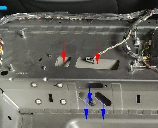

No, they are not sealed enclosures...There is a lot of misinformation in the videos I've seen posted! This has been discussed in great detail throughout this thread...And yes, you can definitely feel the air pressure exiting during deep bass hits.
This is the bottom of the woofers plastic enclosure...
Air vent paths exiting from the bottom of the plastic woofer housing (see arrows shown below).

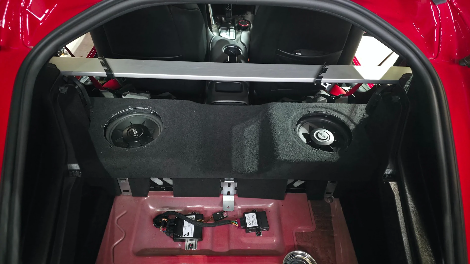

Great write up - I just completed all of the steps. It does sound a lot better, however I am still getting some rattle whenever the bass hits hard. It's coming from the top sub cover/carpet enclosure because I can eliminate it if I reach back and pull/put pressure on it.
I'll probably take it apart to see if i can adjust or add anything else, and I might as well do the SWS speaker upgrade while I'm in there 🙃.
