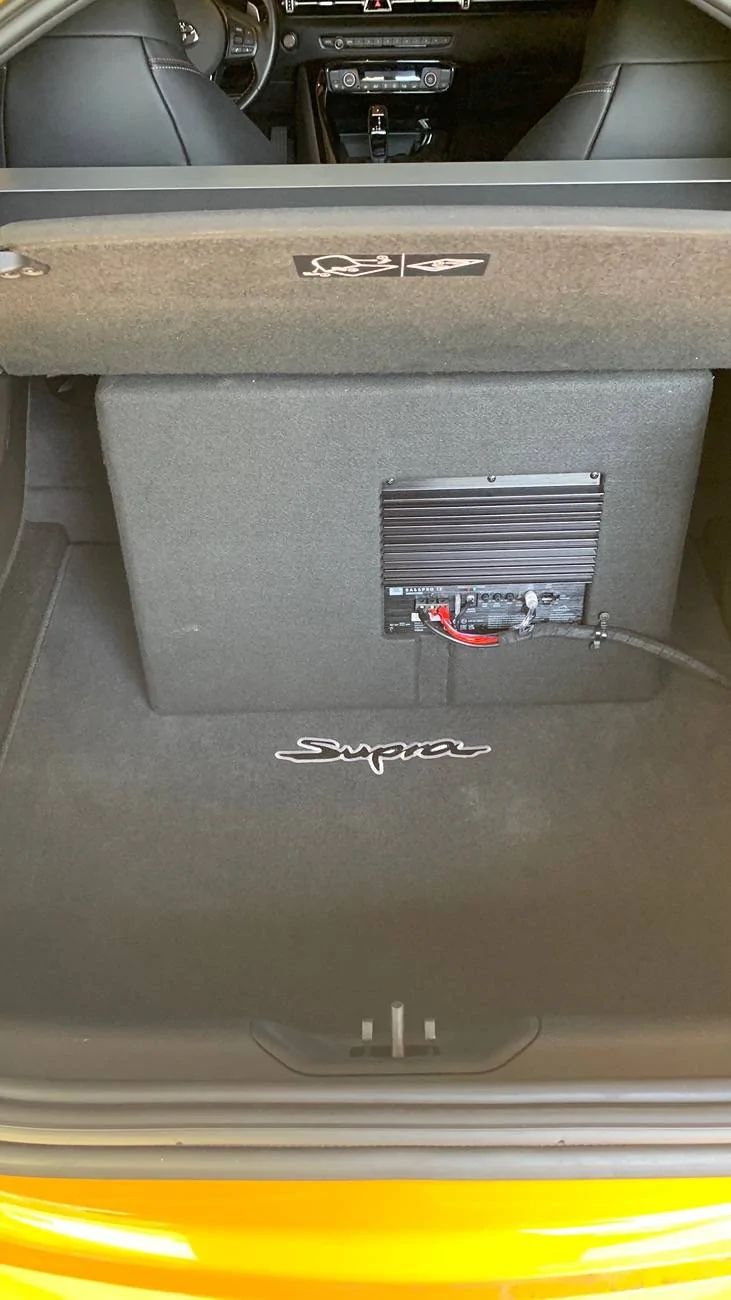

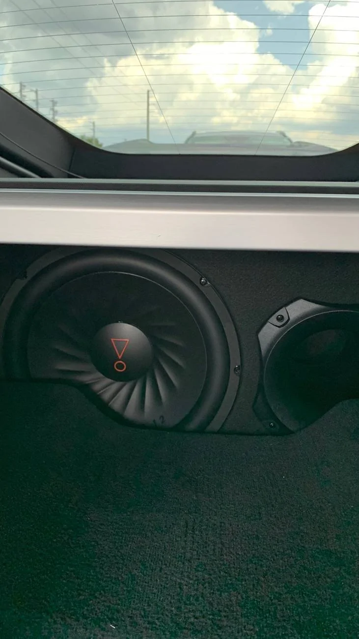

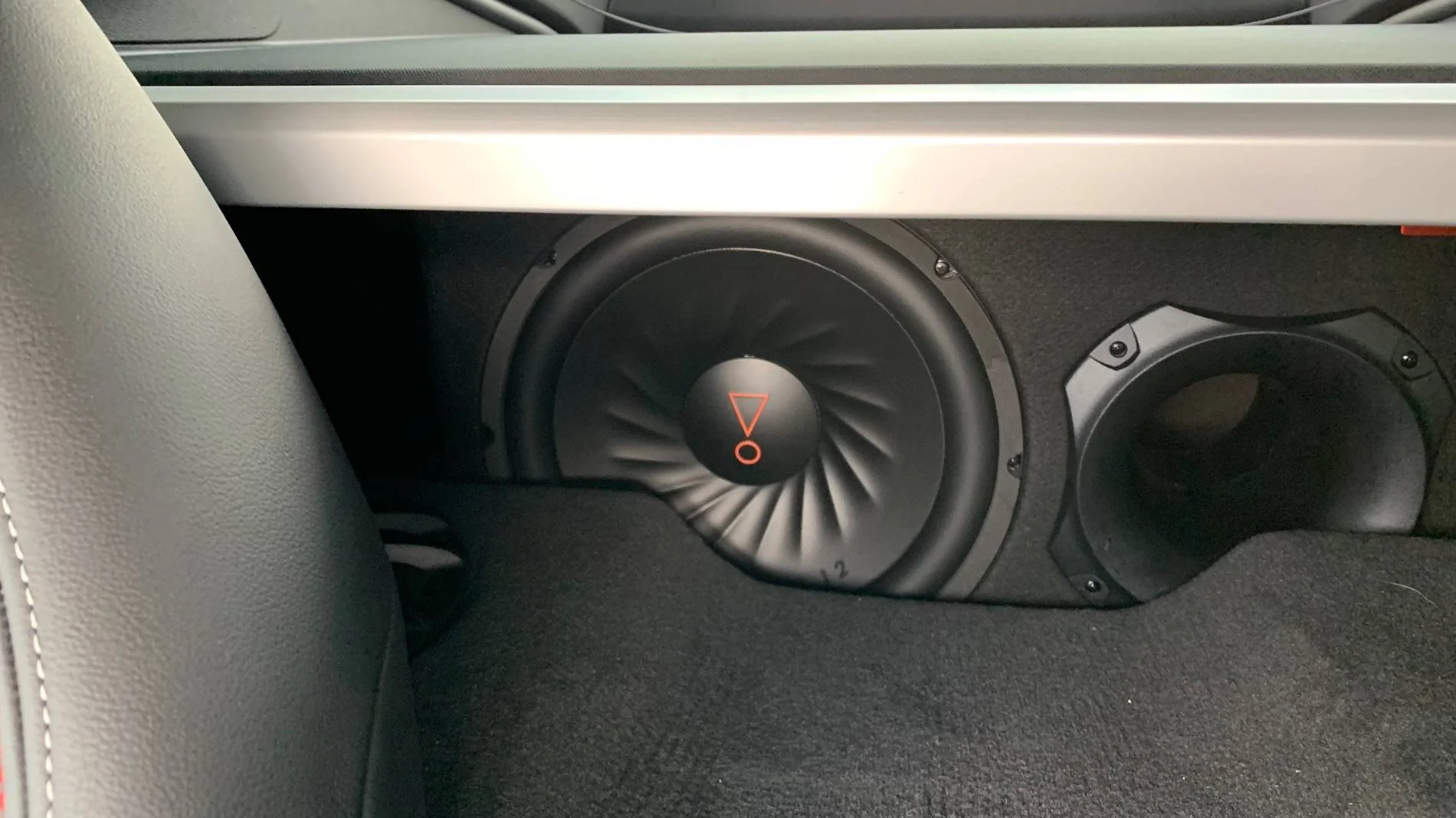

Hello everyone, I was looking for some sound advice. Can anyone here tell me what all I would need to install this in my Supra. I just purchased one today and its being shipped. Would a line out converter or harness be needed? I want to make sure I have everything that's needed when it arrives. I appreciate the help. I hope this fills the Bass I'm really missing.
This turned out to be amazing!! Awesome low bass that fits perfectly and still leaves more than half the trunk/hatch space
MK5_Ger
May 13, 2024
96
74
Germany
2023 3L Premium
Do you have a pic how the trunk looks like with the sub?
