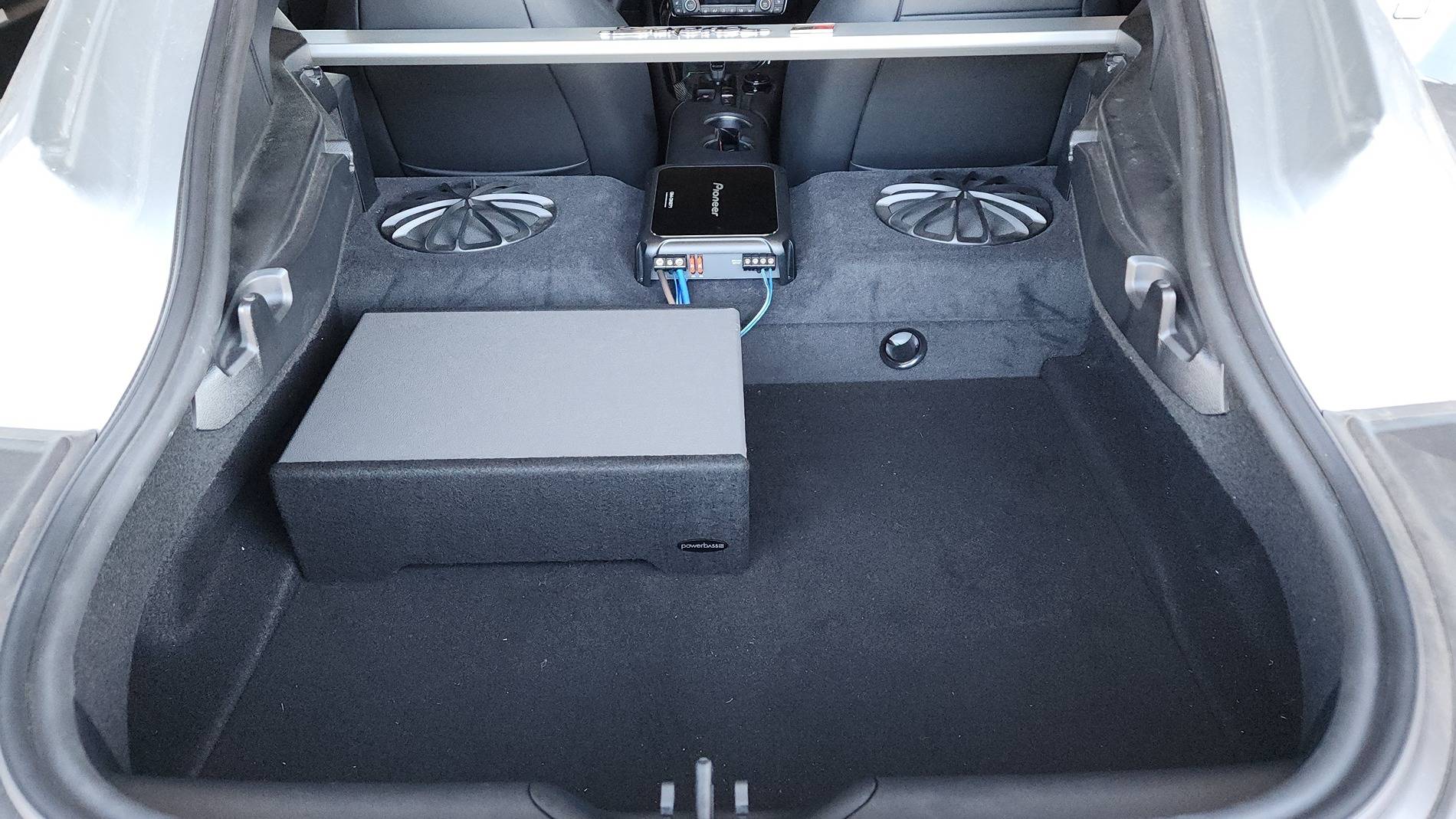

If your intent is to put it behind the seats for more bass, it will fit, but I'd suggest don't. The area behind the seats muffle the bass pretty badly. Maybe 50% of the bass tone versus just putting it in the trunk.
I have a PowerBass 10" shallow sub/box and experimented with trunk and seat placements.
Apart from placement, those compact, self-contained, builtin amp units are pricey and don't make the bass/power you are probably looking for.
For a little more money there are the Kicker, Pioneer, Alpine, etc. 10" subs too that are all in one, or get a box and amp. I went with the Powerbass as it's the smallest solution at around $150 that fit my total budget of near $300-$350. I use a separate Pioneer bass amp ($150) to power the sub to squeeze every ounce of bump from it.
