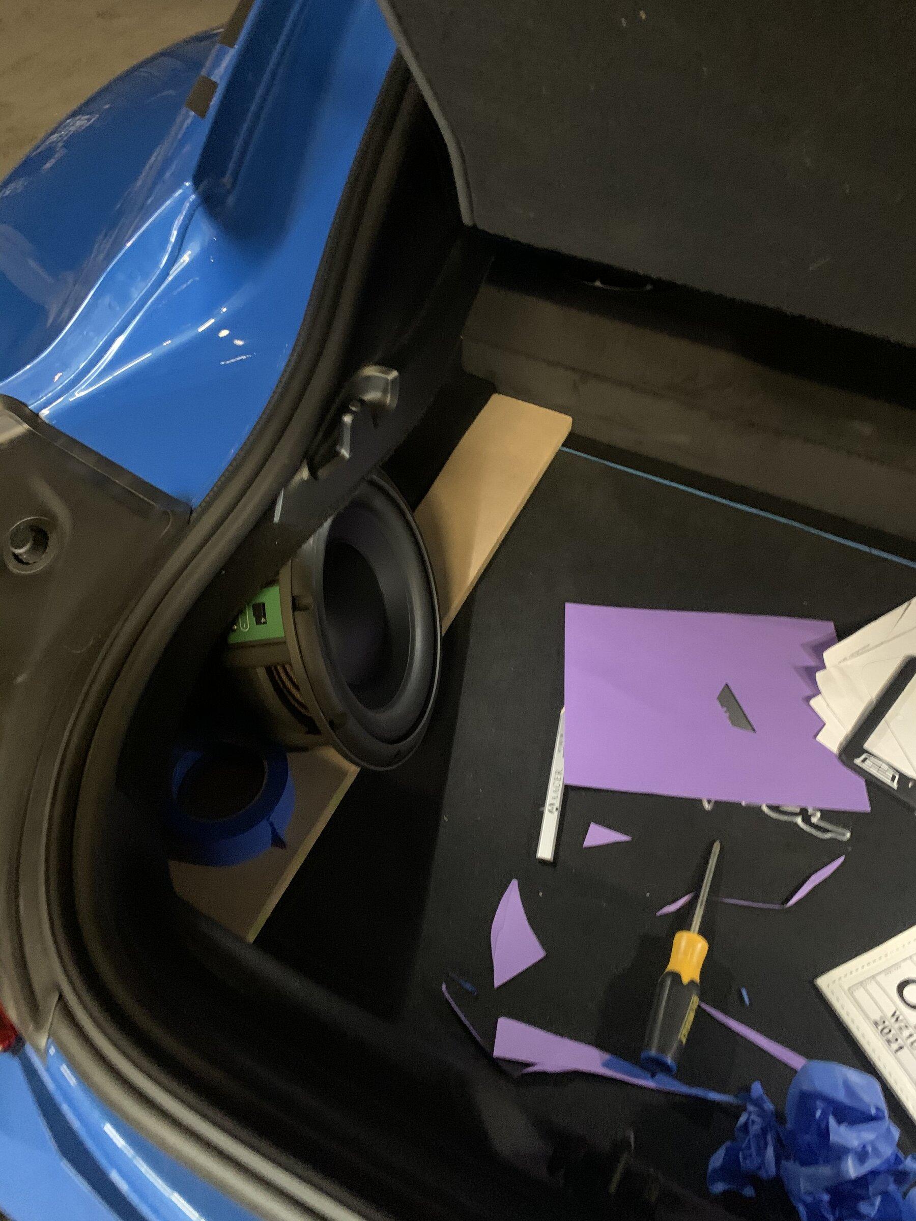

thoughts on swapping the stock subs out for 8” 3 ways to act as more mid bass?? Planning on adding a 10” sub, amp in mine and I’m curious as I have gear sitting

I’m not sure you will be happy installing 8” directly in there place. I’m working on the same thing right now. I’m using Steven audio mb8 8” mid bass for there and building a small enclosure on top of the existing one. Only need .3 cubes.
Then a 10” sub in back corner

Without modifying the stock sub box like Sam is talking about it will be pretty hard to swap out to a traditional 8” sub. It’s just due to the shape and depth of the stock enclosure.

Better off building an enclosure on top to accommodate 3 speakers, 2 for mid bass and one for sub.
