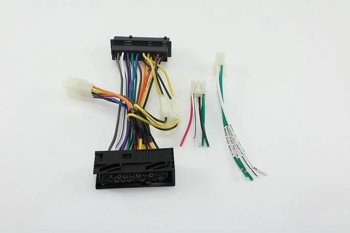

So I took the plunge and bought a pnp kit from Technic that fits the 3x/8x series and can confirm it fits, though I haven't gotten it powered up yet. The included harnesses, for our purposes, provide a 4-pin speaker input connector and a 3-pin power/ground/remote out connector for an LOC. But I was advised the 20-pin main connector does not supply anything but speaker signal, so I'll still have to find a remote turn on signal to relay as @static63 did in his (very helpful) thread. Was it worth the kit price? As someone who didn't already have an LOC, yes. (Which btw has gain adjustment, which is very nice) It's not as thoroughly integrated as I'd hoped, but it's straightforward and relatively clean. Hope this is of some help.
Update: Powered up the stereo today with the harness in place and everything sounds/works normally (with nothing else attached yet). I don't have a lot of time to work on this each day, so I'm installing/testing one component at a time so if there's an issue I don't have to start back at square one.

First things first:

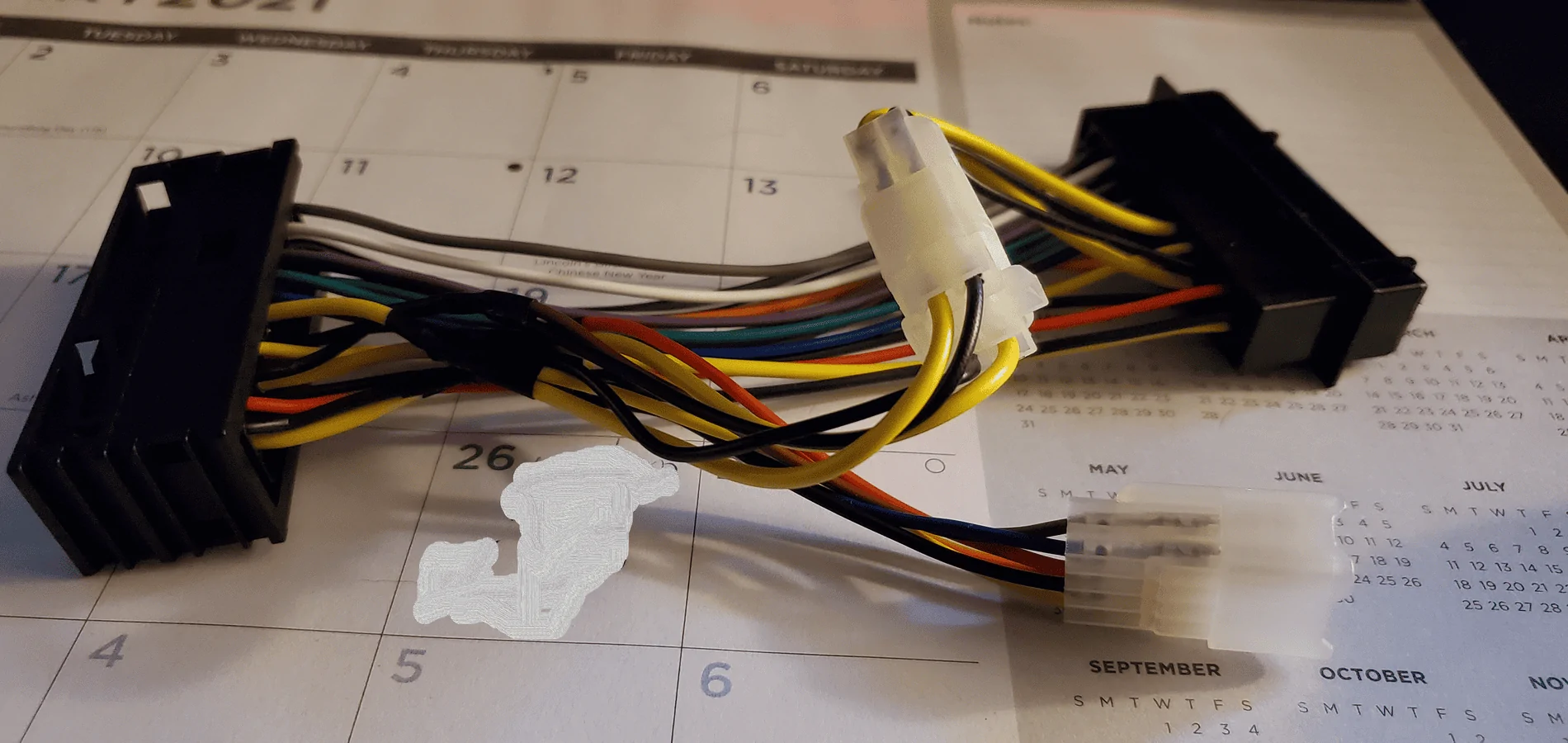

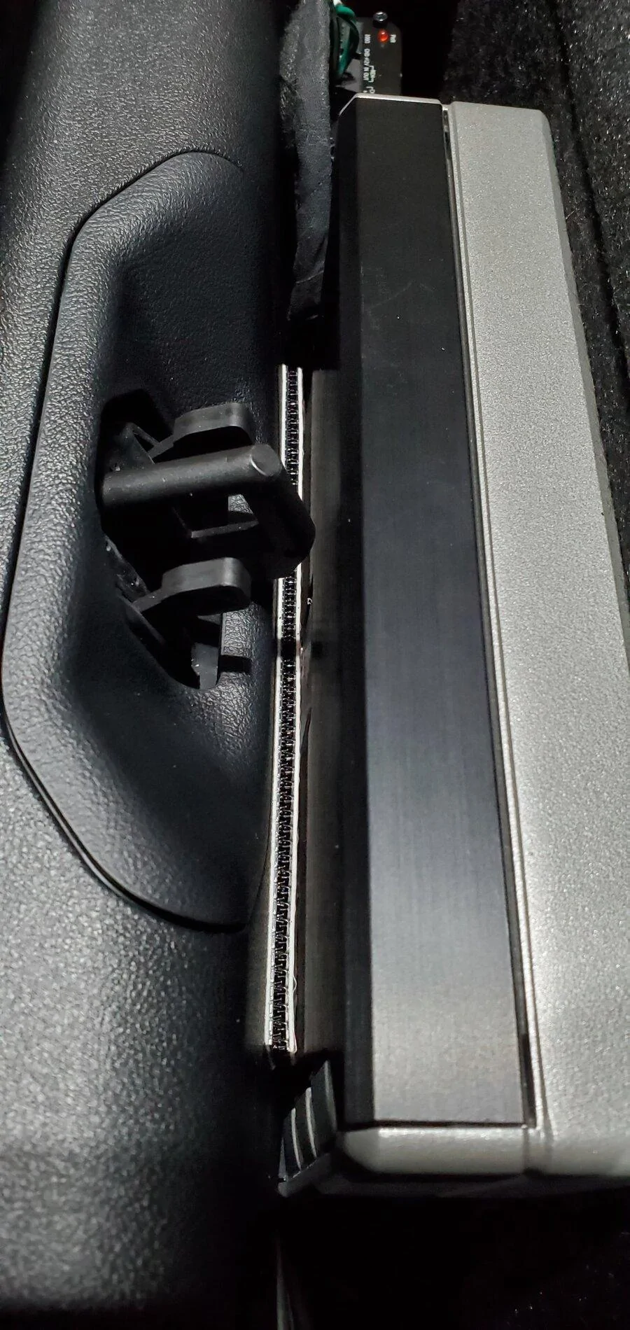

Once you've got the rear and side panels removed, you have access to the stock amp. Unless you are adept at standing on your head, you'll want to remove the amp to access the plugs on the bottom. They're all quite short, with typical German efficiency, so you may have to release the speaker wire harness from a couple of the clips that hold it to the chassis to give yourself some slack with which to work. Once you have the 20 pin harness unplugged, you'll plug into the new harness extension from the Technic kit. The two rows of pins are slightly offset, so there's only one way they can plug in. Plus the whole male/female pin thing.

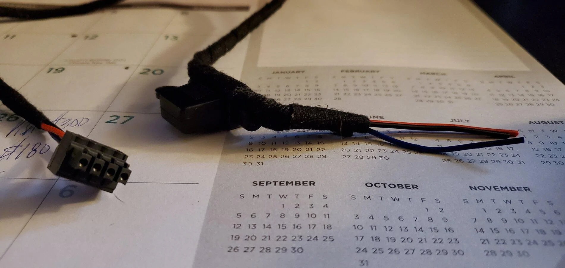

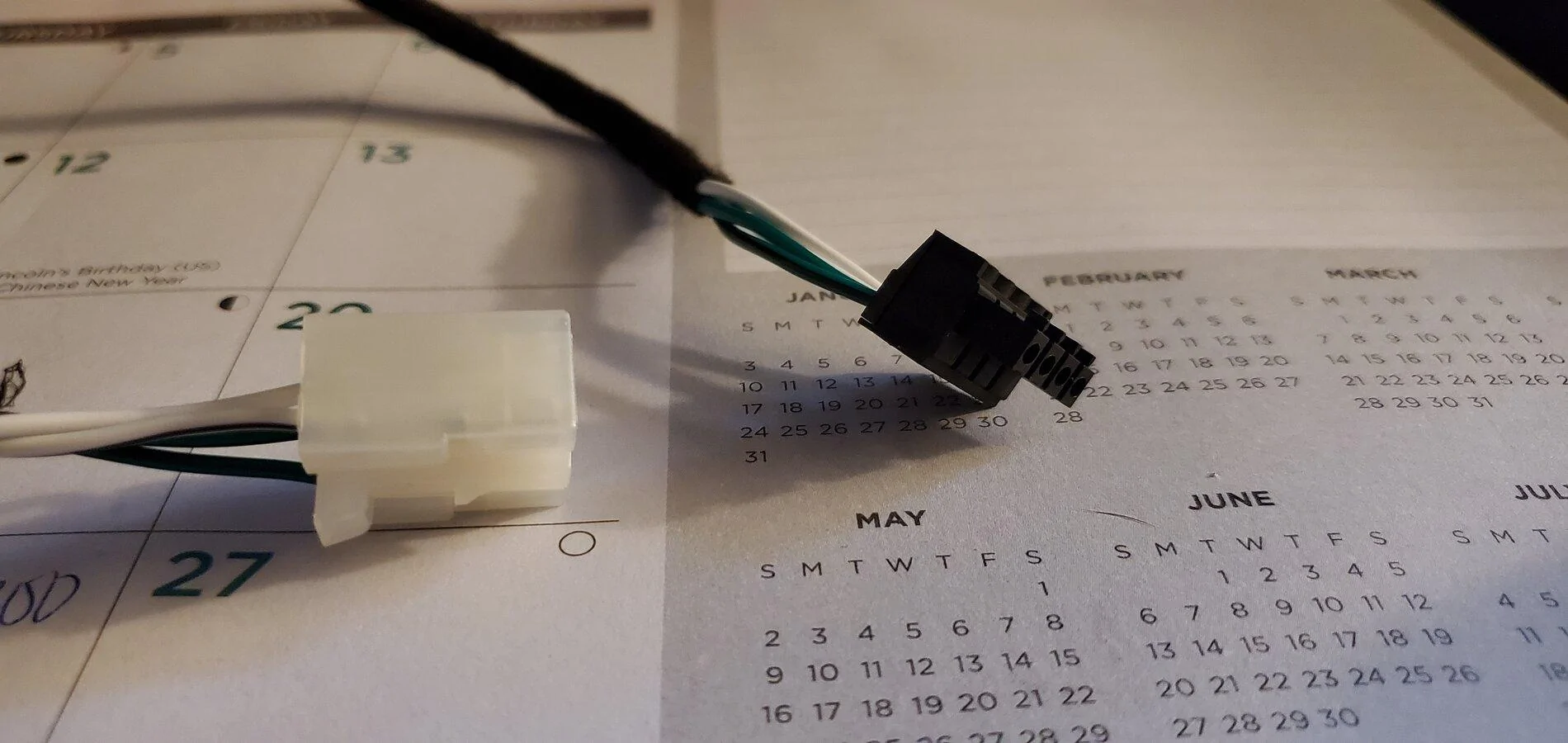

The kit includes five harnesses, but you'll only use three of them, as this kit is not specifically intended for our car.
First is the aforementioned main 20 pin harness for all the oem connections, which also has a breakout plug.
The second harness will go from the breakout plug on the 20 pin harness to the speaker inputs of your LOC.

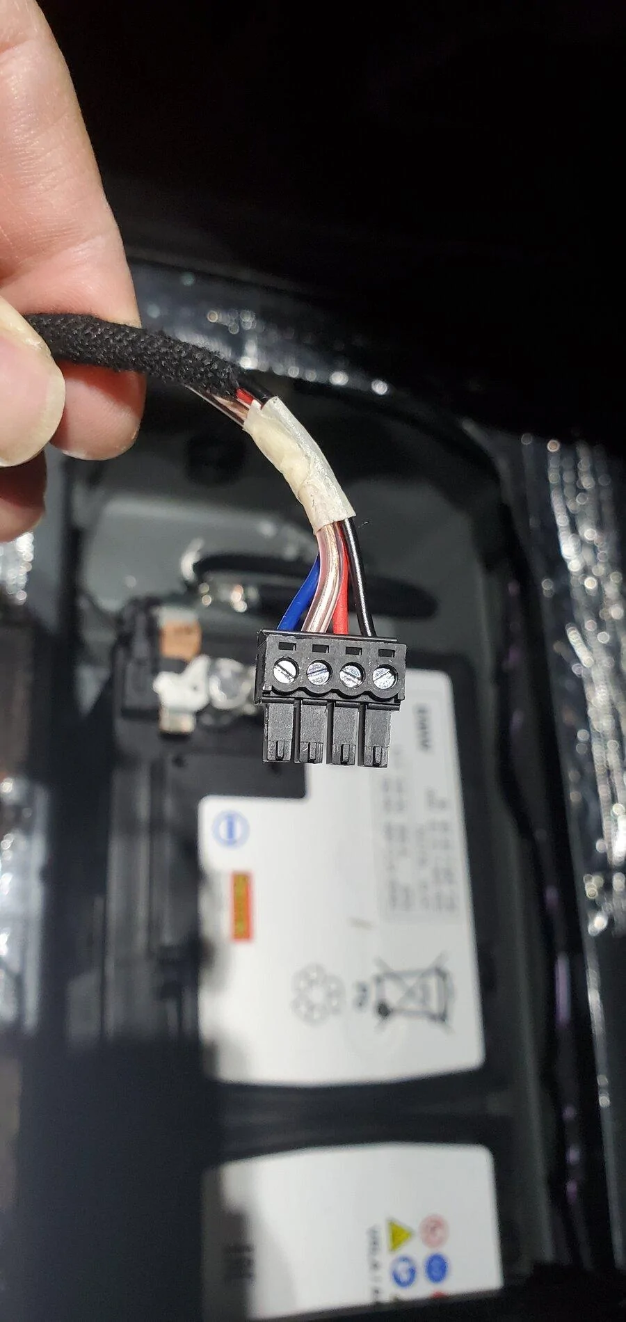

Third and final harness provides power, ground, and remote in signal for your LOC. On one end is the four pin plug that goes into the LOC, and the other end is bare. In between is a fuse holder and a 1 amp fuse. You will have to run a wire from the remote out pin in the harness to the remote input on your amp.
A very small flat head screwdriver will loosen up the connecter and allow you to put in your own wire.

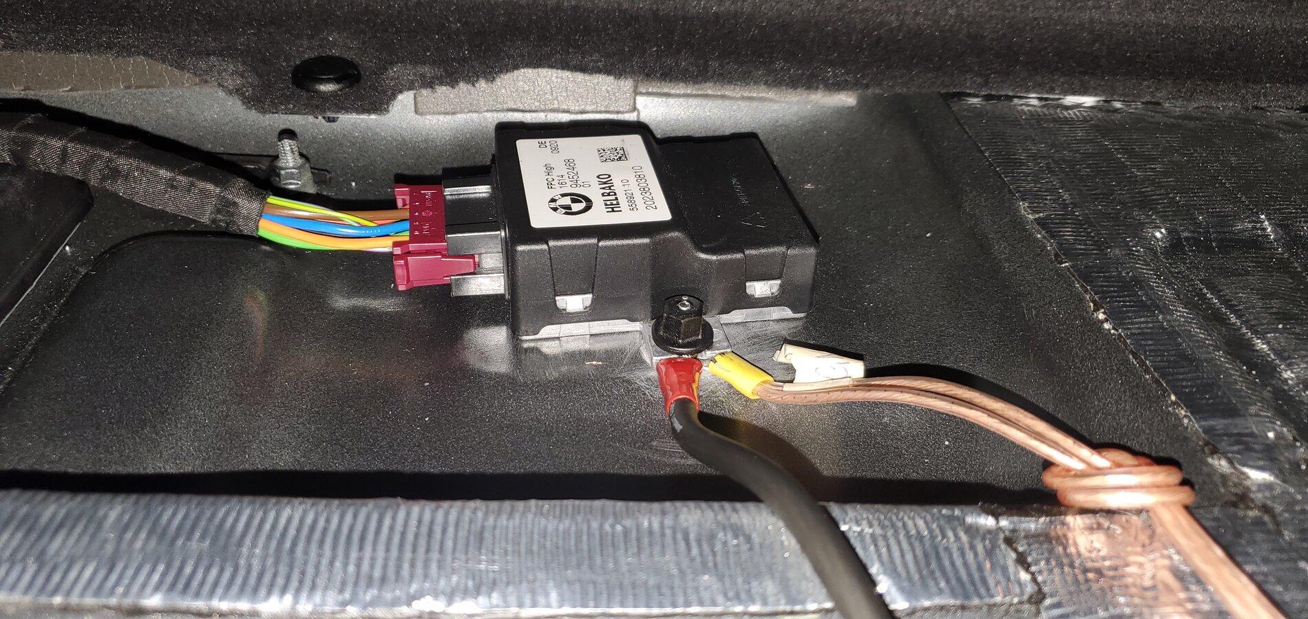

Finally, it was simply a matter of running wire: from the positive battery terminal to fuse holder, from fuse holder to power distribution block, from the distribution block to your amp and relay. I ran amp/relay/LOC grounds to the same spot to reduce the possibility of noise. I chose a spot under one of the modules in the upper center area of the hatch:
be sure to dremel or sand off the paint underneath to ensure a good ground.

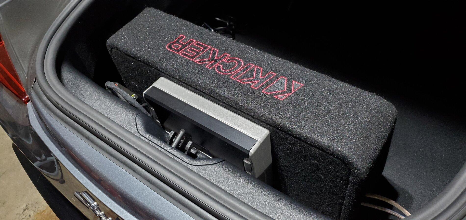

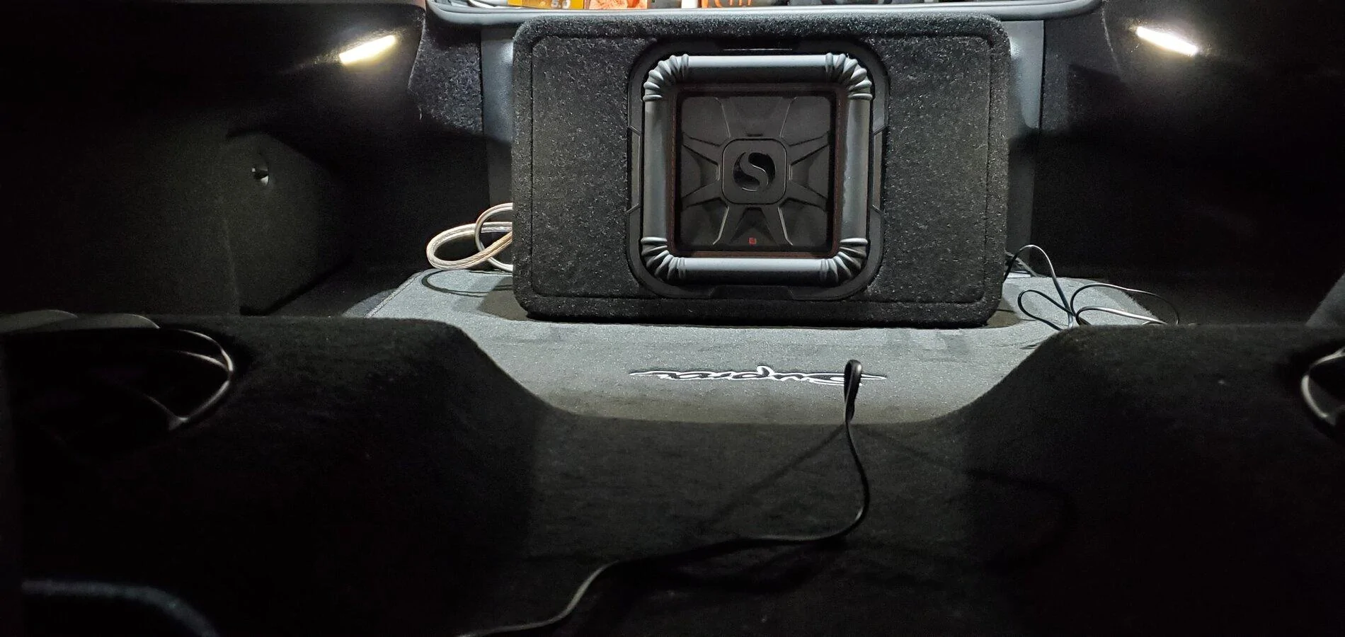

I used some 3M double sided velcro to affix the amp and sub to the rear hatch panel and a couple strips underneath the enclosure on the trunk mat to keep it from moving and in the attempt to keep this project fully reversible. (amp is screwed into the back of the enclosure and LOC is also stuck to that same panel on the driver's side) I ended up putting the bass knob on the bottom of the seat frame near the front with some double sided tape and tucking the wire under interior panels and the trunk mat as far as I could. Entire project took several hours total over a week's time. Bass is excessive, but it's better to have too much than too little.

Does anyone have a photo of the factory wire harness that connects to the amp? I need to know what pins go to what speakers
