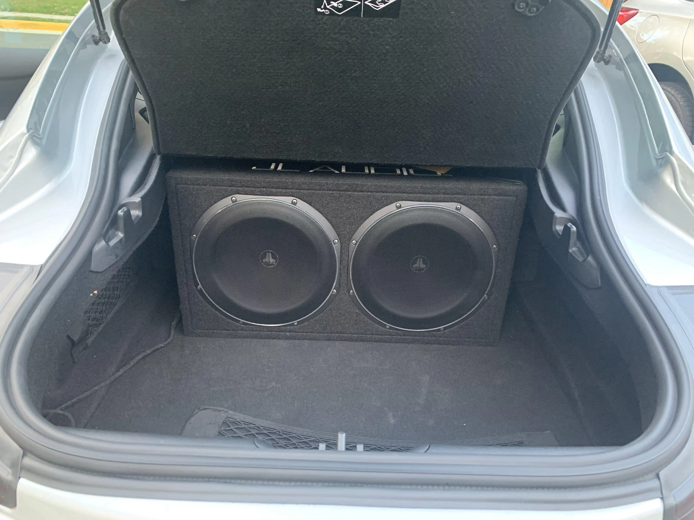

I don’t have any useful tips, but I did use their harness in my Supra to put 2 12s in. Worked perfectly, but had a friend I trust from Best Buy do the install.
it’s a rather noticeable change in the frequency distribution especially when listening to contemporary urban selections.
